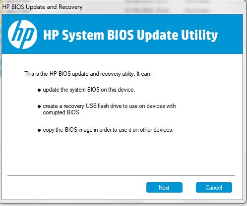

    I NEED BIOS FOR HP hp 15-u102nk BORAD NUMB da0y61mb6e0 rev e
    PS I'DONT HAVE THE OLD BIOS
    • 20781
    Re: hp 15-u102nk
    Download the bios from the support site - https://support.hp.com/us-en/drivers.../model/7399337

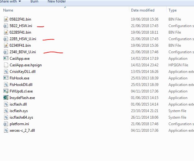

    Extract the exe using 7-zip or winrar,you`ll see 3 bins and ini files. The 3 ini files have 5B22_HSW (haswell) ,22B5_HSW_U (haswell U) ,2340_BDW_U (broadwell U) .Look up the 15-u102nk spec online or read the cpu part number to see which CPU you have, this will save you time so that you don`t have to try all 3 bios.

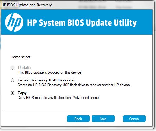

    Run the update exe and choose the copy option,it will decrypt all 3 bios to a folder you choose.Flash the bios then you`ll have to use HP dmi tools or find another bios dump with the same BID and copy /modify the DMI info and win key from that and copy it into the new bios
