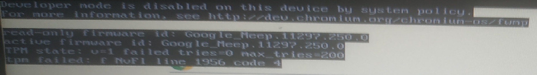

                      Hello.
                      There is a chromebook blocked by the administrator, the developer mode is blocked, disabled.
                      chromebook 11 g8 ee
                      1) how to enter bios?
                      2) How to enable developer mode?
                      3) Maybe I need to modify my bios?
                      thank you

                            after writing new bios reinstall from USB stick made for your model with Chromebook Recovery utility. 11 G8 EE (intel) is different from 11A G8 EE (AMD).
                            You can't "enter bios"
                            You have videos on youtube how to enter developer mode but only after you write new bios - developer mode is blocked in your current bios.

                              #34
                              Re: HP Chromebook 11A G8 EE need unlock
                              1) made the BIOS firmware.
                              2) Restored using a ChromeOS flash drive
                              3) connected to the Internet
                              4) the device is blocked, I cannot enter the bios and turn on the developer mode.
                              I wanted to enable booting from a USB flash drive and install Windows
                              if I flash a modified bios, and then the device is blocked again, do I need to flash the bios again?

                                #35
                                [QUOTE=konovalec85;1284555]1) made the BIOS firmware.
                                I flashed the bios again, used the chrome os recovery flash drive, but I cannot enter the developer mode (

                                    you have to remove the battery in order to disable write protect. There are a lot of movies on youtube how to do it but you are to lazy to think a little bit ... and is for free!
