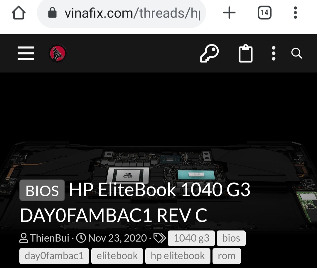

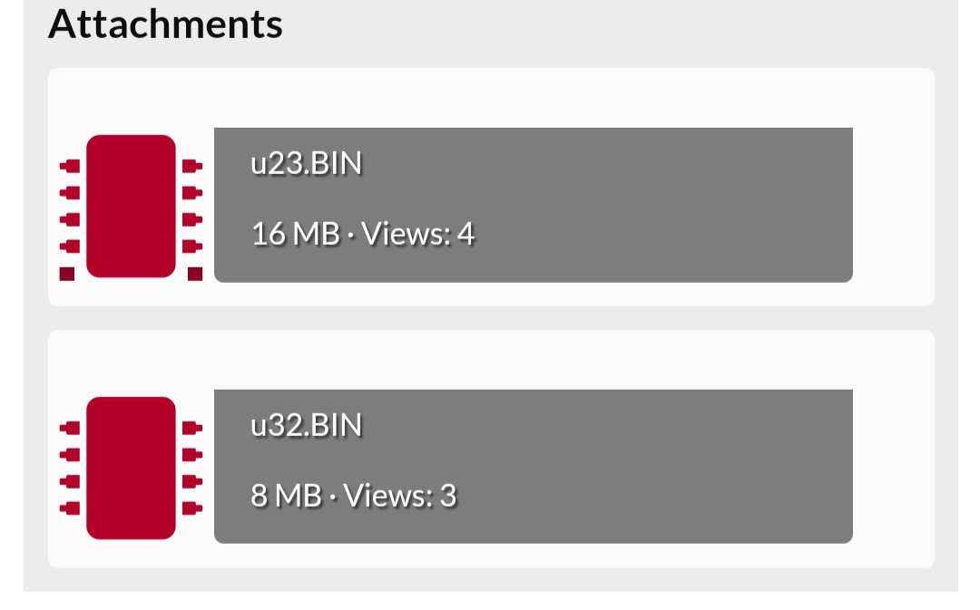

                                    here is everything for free
                                    this file is available on the "vinafix site"
                                    and this file also from "vinafix" is corrupted because its posted to fix the file by a vinafix client but
                                    we just need that exact file for the reference because of this non good file we can build a new one for you
                                    btw i attached 2 pic so you can see & make sure its model and both bios file given by numbers
                                    you can google by this name is given in image 1 and type "vinafix" ahead to find that

                                      #38
                                      Re: HP folio 1040 G3 Bios request
                                      try this @KETAN
                                      both file attached U32 & U23
