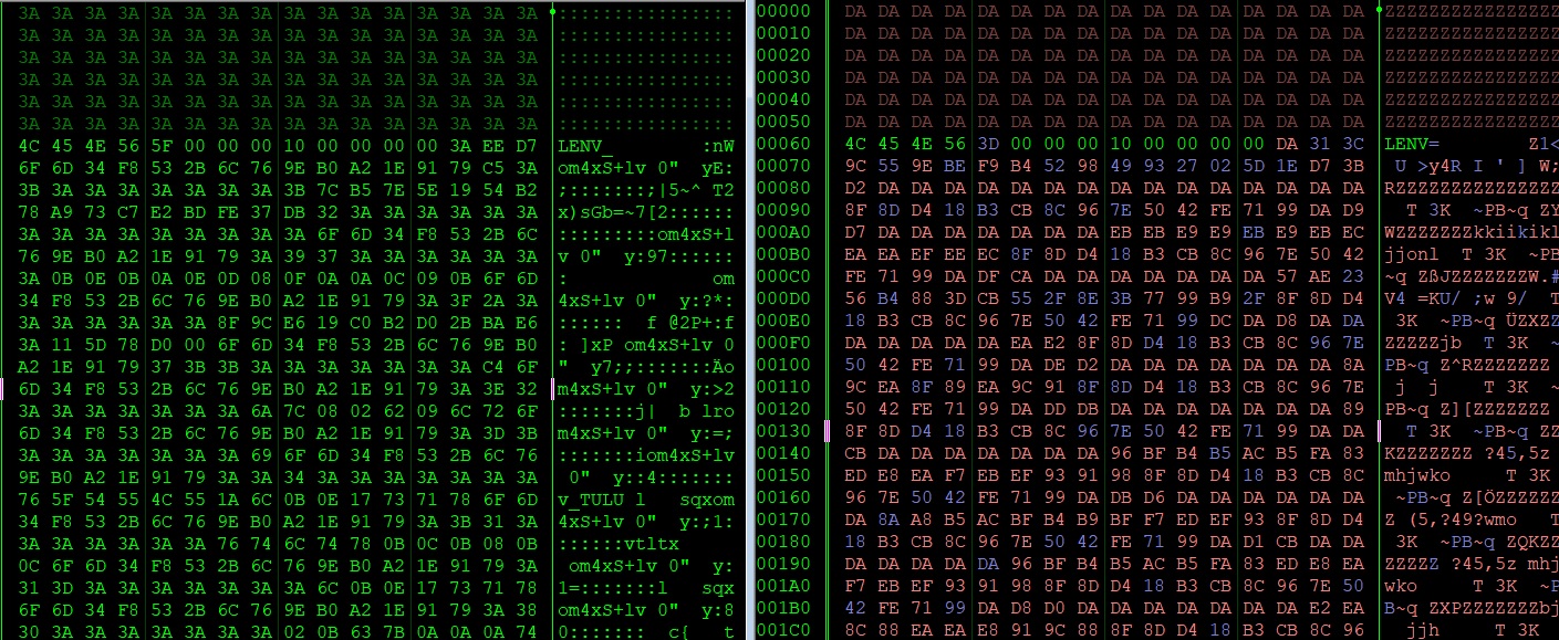

          top
          a raport with prefix front and back of LENV ,it's not FF
          see picture
