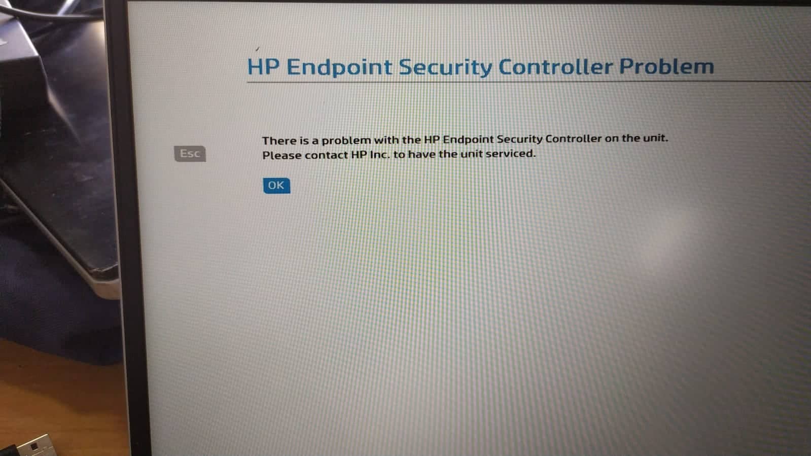

                  Re: 440 g7 computrace
                  Did you fix the issue, i loaded the same bios file and now have the ENDPOINT problem at boot
                    try this ... enter bios and restore security settings to defaults and restart your laptop
                    • gtiphil
                      • Dec 2021
                      • 16
                      • uk
                      Tried the reset but still get endpoint error.
