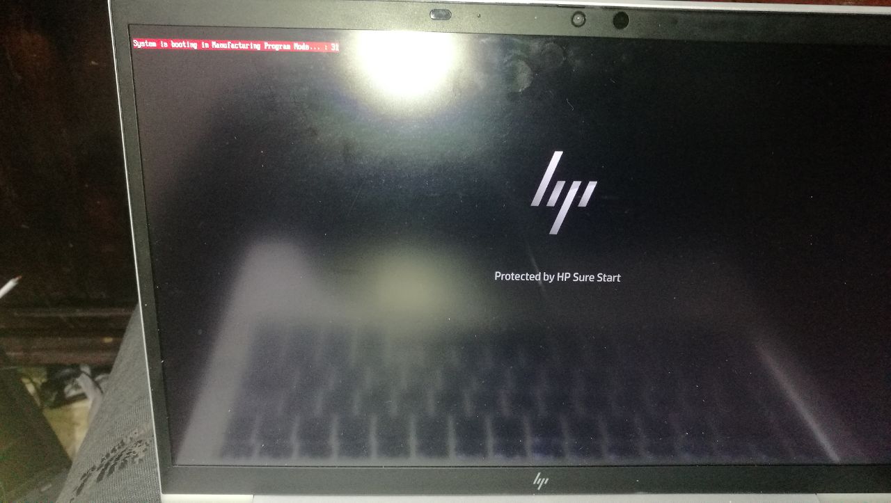

                                    PLEASE HELP ME REMOVE PASSWORD BIOS HP ELIEBOOK 840 G7 10 GEN
                                    camelia-6050a3136201-mb-a01
                                      Re: HP 840 G7 password
                                      Here
                                      Become a Badcaps supporter
                                      Thanks to all supporters.
                                        Originally posted by hoaca388 View Post
                                        Here
                                        Thank you, my friend. It works, but the back is a problem system is booting
                                        manfacturing Is there a solution
                                          add orignal dmi data
