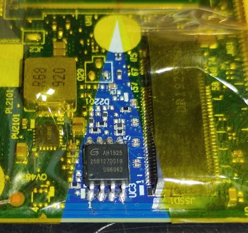

    Hi Guys
    I purchased a Lenovo Legion Y545 (i7 9750 / RTX 2060)
    The previous owner he told me it failed a bios update.
    I thought cool i could use a simple EEPROM Programmer, nope
    I didn't realize that lenovo don't use EEPROM chips, but EC
    So from my findings i can use a Vertyanov Programmer, to reprogram my EC chip via the keyboard connection, but im not 100% sure on this
    The Mainboard in my legion is NM-C221 Rev2.0
    The Lenovo EC is
    IT8226E-192
    1919-BXA
    S16YSA
    L003
    i have been able to get my hands pretty easily on a the bios.bin, the machine also turns on with quick fan spin that stops and a blinking power button light.
    In Summary does the Vertyanov Programmer, Support the IT8226E-192?
    as from what iv seen it only mentions earlier versions of this chip.
    As i know the programmer needs the machine to power to be able to program, which this laptop meets that requirement

    Re: Lenono Legion Y545 Failed Bios Update. Program Chip?
    If it failed after a BIOS update you should try to flash the BIOS first, and if it doesn't solve it then you can try to flash EC.
        There's almost always a dedicated SPI ROM for BIOS. (except on the Apple T2 machines where it's stored on the SSD NAND chips)
          Bingo, Found the Chip W25Q80EWNIG 1.8v , now the drama of finding a bios dump thats usuable
              That's the VBIOS not the main BIOS.
                • 22151
                The bios chip is at UC3 ,check the schematic - https://www.badcaps.net/forum/showthread.php?p=1017588
                When you find it post the backup .
                  That would make sense..
                  ..now my 341 Programmer is giving me errors writting to it..
                  I have found the UC3 located just next to the m.2 slot.
                  once i have written the Vbios and put it back i will then do a dump of the bios
                  Chip number: 25B127DSIG
                    from my googling the chip in the UC3 Position, is a Power IC
                    yet in the Y540 Schematic its mentions to be a W25Q128JVSIQ_SO8 at this position
                      it has left my slightly confused as the model number has 127 in it, not 128 like most chips
                        from my findings the 25B127DSIG is a SPI Bios Chip but of a lesser known brand
                        https://au.mouser.com/ProductDetail/...sTEejDYQ%3D%3D
                        Since my programmer doesn't want to read from it, might try and harvest a W25Q128 off an old dead laptop (have a few to pick from) and program and install
                          So far iv been having a bit of luck
                          read and reprogrammed the bios "25B127DSIG"
                          set CH341A Version 1.18
                          i have attached the bios dump
                          Set it as Winbond W25Q128BV.
                          Now awaiting the 1.8v Adapter to reprogram the Vbios
                          Atm im still getting a blinking power light and a brief fan spin, then looking every 15 seconds
