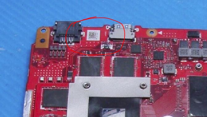

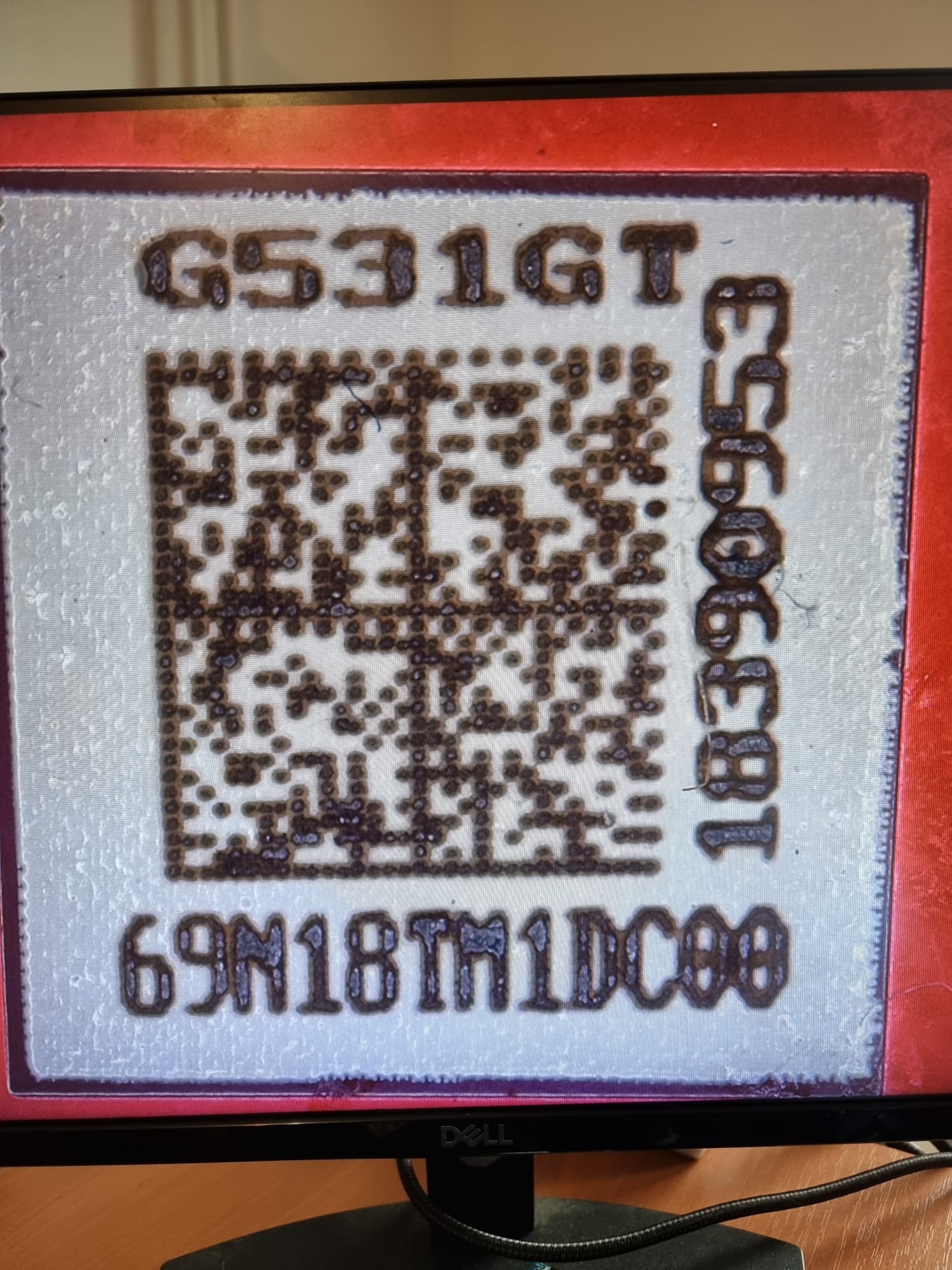

          Post a good clear readable picture of the QR code near the HDMI port,if therei is one

            Re: plz i need bios asus rog strix g531gt
            Originally posted by smdflea
            post a good clear readable picture of the qr code near the hdmi port,if therei is one
            shure.
