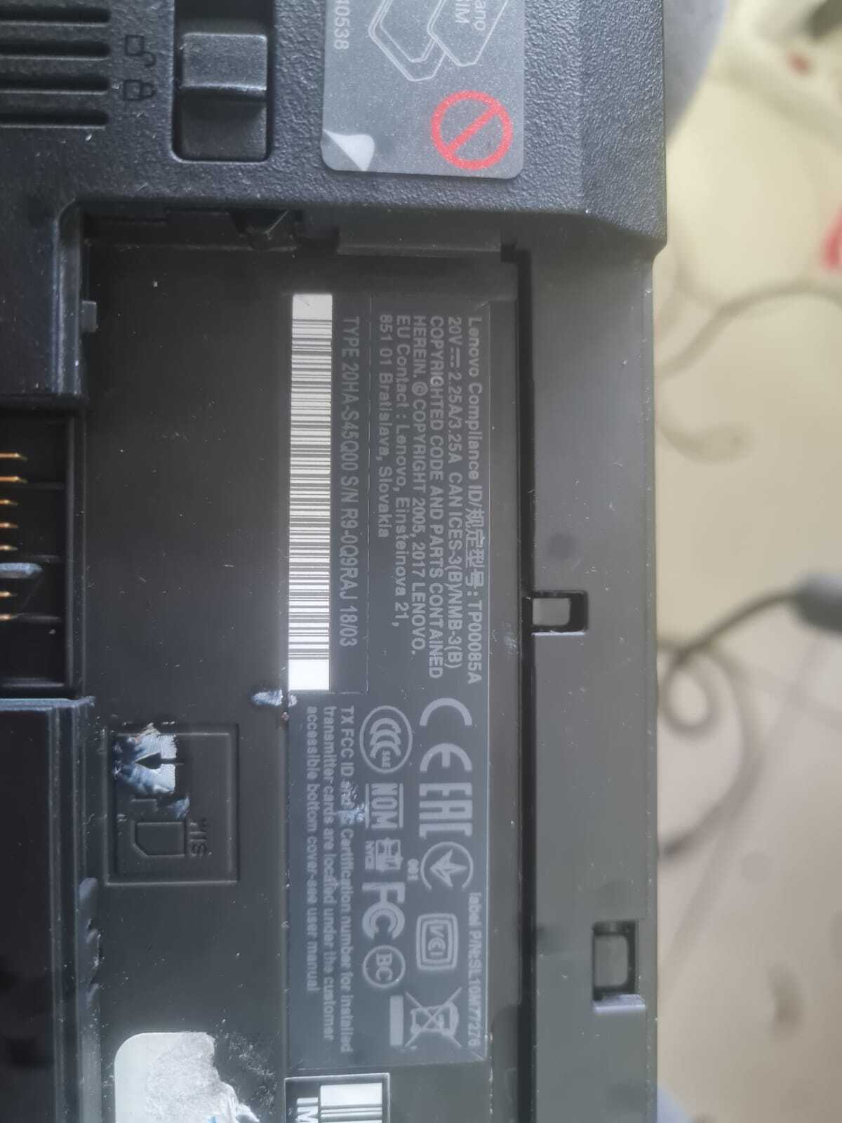

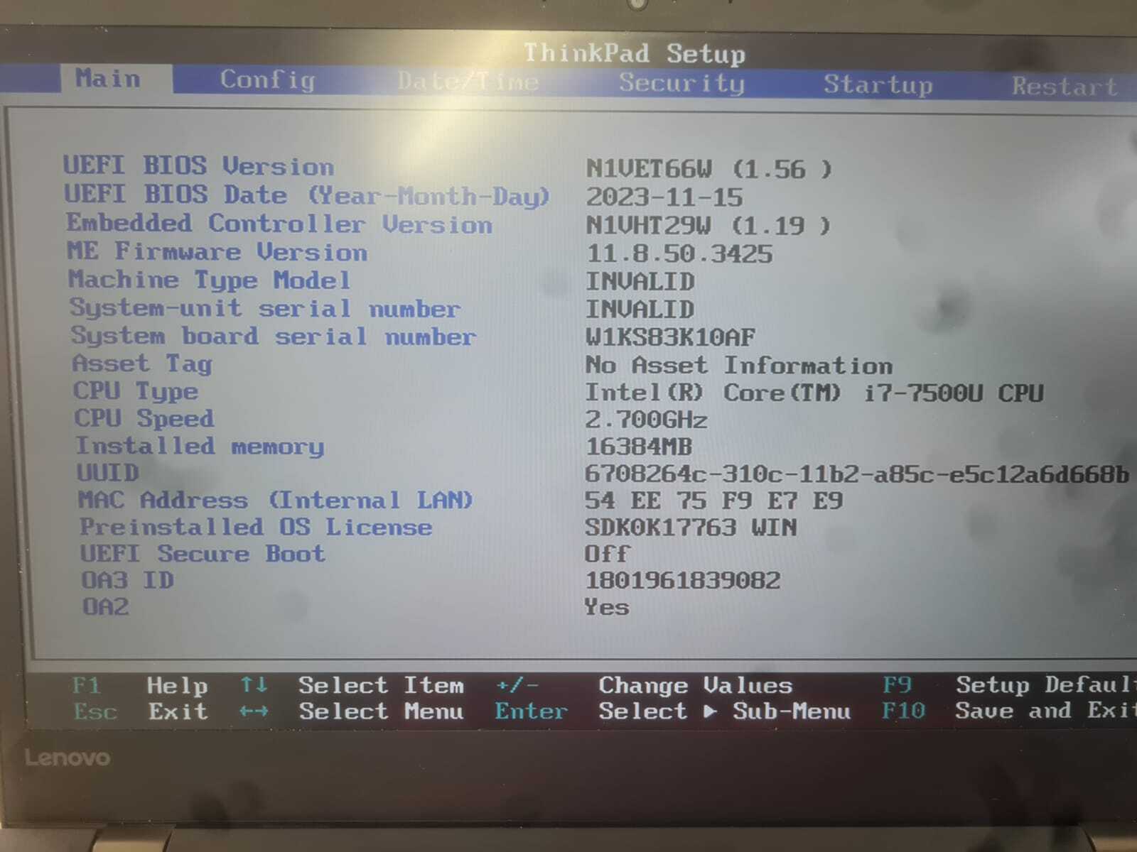

    Can Someone Help me to update the Serial Number and Model Number on my BIOS Backup Bin?
    Lenovo Thinkpad T570
    Type: 20HA-S45Q00
    Attached is the Serial number Invalid Picture + correct one.
    Type: 20HA-S45Q00
    this one worked 100% thanks
