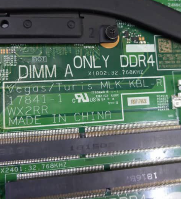

    Dear Friends,
    I need bios for Dell Inspiron 14 3476 Vegas Turis MLK KBL-R 17841-1 WX2RR.
    Thanks in Advanced,

    try..

        Re: Inspiron 14 3476 Vegas Turis MLK KBL-R 17841-1
        Try
        Factory Made Last Version
        Supported Dell Inspiron 3476/3576 and Vostro 3478/3578
          Thank you so much its works

            Works but i experience a wierd problem.
            After i write it, pc starts in factory mode, recognises and charges battery.
            As long as i use it in factory mode it charges battery fine
            After i select model, vostro/inspiron 14/15, it says battery is not recognised or not dell genuine.
            Any ideas?
                  Nope, i did not managed to find any solution.
                        Hello all!
                        Have Inspiron 15 3576 with vegasturis mlk kbl-r 17841-1 wx2rr motherboard.
                        An original dump lost.
                        Laptop still working in Manufacture mode but after press Alt+F battery stand as wrong.
                        Can anyone help?
                          Originally posted by kalya
                          Hello all!
                          Can anyone help?
                          try post#2
                            17841-1
                            Hello, does anyone find a solution to this problem?
                            The battery is original and it works on another device normally
                            Tried more than one battery, same problem
                            A new bios has been programmed
                            And the charging ic has been replaced
                            io . has been replaced
                            The problem has not been resolved!!
                              i have the same battery problem: Primary Battery Health: Not a Dell Baterry.
                              In manufacturing mode the battery works and charges normally.
                              When I customize for the notebook model the battery error is displayed.
                              I've tested up to the current version 1.16.0 and the fault persists whenever I customize the notebook model.
                              I changed the BIOS binary that made the EC Embedded Controller v1.0.2.bin file available to the EC Embedded Controller v1.0.0 available in BIOS exe v1.3.0 and the failure persists when customizing.
                                I had issue with Vostro 3578, powercycle, with flashing Capslock button and flashing Power indicator on the fron of the case of laptop.
                                Made backup of the existing BIOS, erased it, programmed with the BIOS file
                                https://www.badcaps.net/forum/showpo...83&postcount=4
                                Needed to select the model, worked properly, back in life! Thanks guys!
