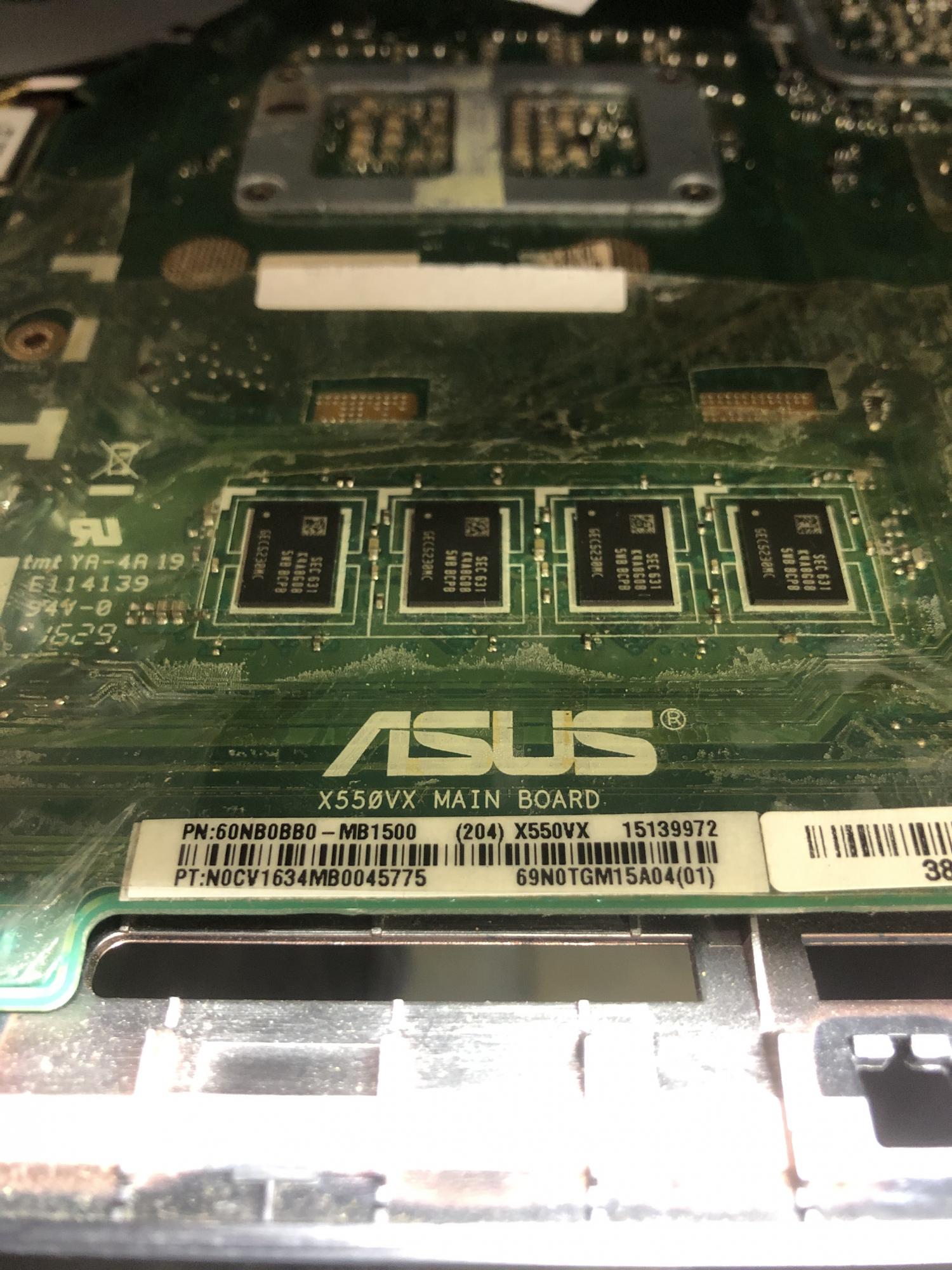

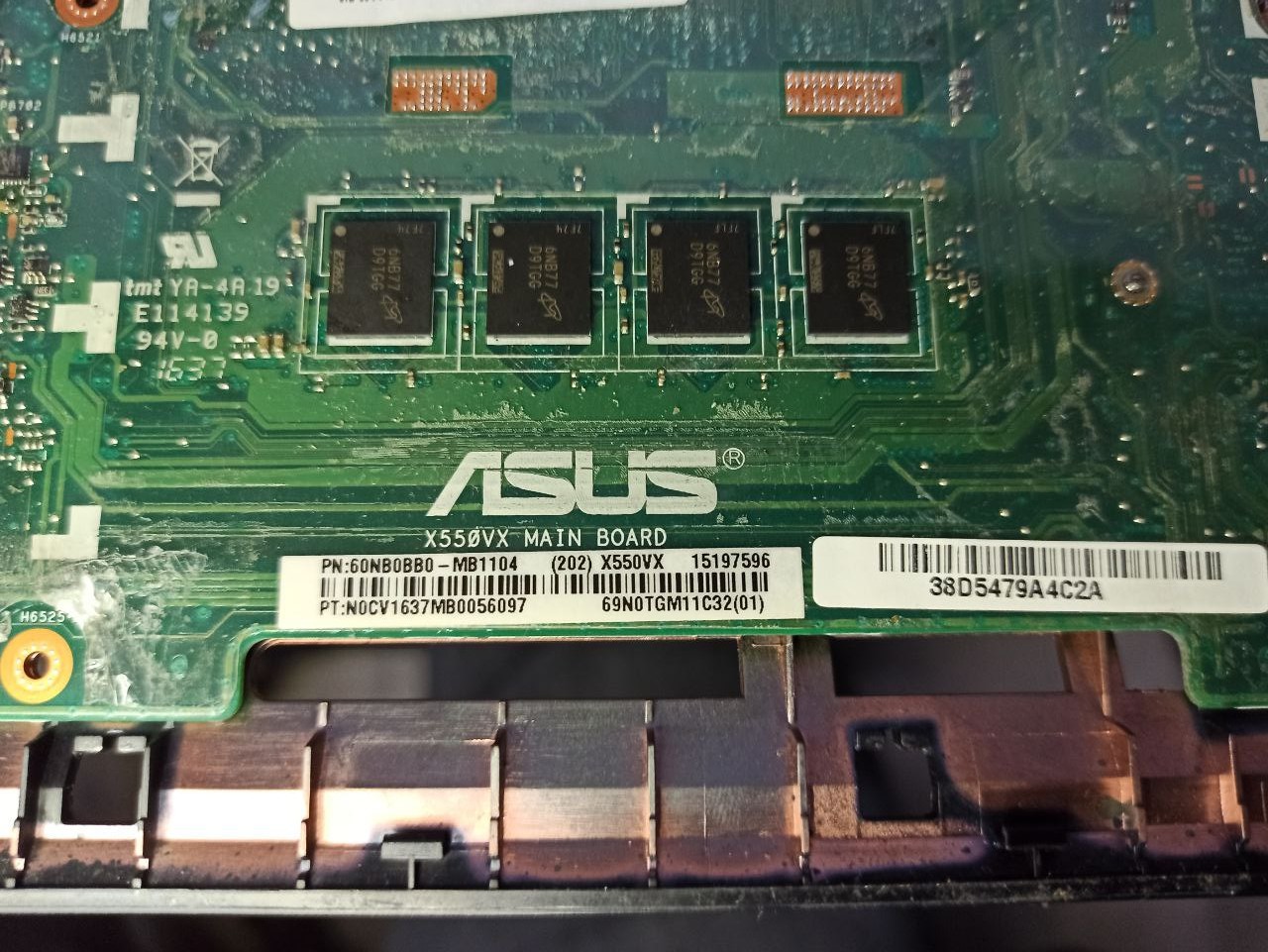

            • 22279
            Re: Asus k550xv shut down after 30 minute
            Originally posted by akdenizmusty
            i have same problem but
            my case code : x550vx-dm263tc
            motherboard:x550vx rev:2.0
            chip:sr2c4
            i cleared me side before .but 30m after shut down
            orjinal dump:https://dosya.co/879z4y4k6h0i/x550vxoldd.rar.html
            What board did you take the replacement PCH from. Post pictures of the white/green stickers on the motherboard,usually they are near the RAM
            • akdenizmusty
              • Aug 2016
              • 46
              • Turkey
              I bought 2 from a site I trust, 1 of them worked without any problems, I puted the other into this device.30m after shut down
                • 22279
                Post pictures of the white/green stickers on the motherboard. They have the info for the bios that the motherboard shipped with.The silkscreened motherboard part number isn`t always the bios version you need.
                Also can you run MEInfo and post the report, you can use the windows or dos version, from post #16 in this thread - https://www.badcaps.net/forum/showthread.php?t=93189 .He is having the same problem as you.As pointed out by piernov in that thread it could be a soldering issue or other problem, i`m just assuming that youve soldered the chip correctly and there are no missing parts,resistors etc.
