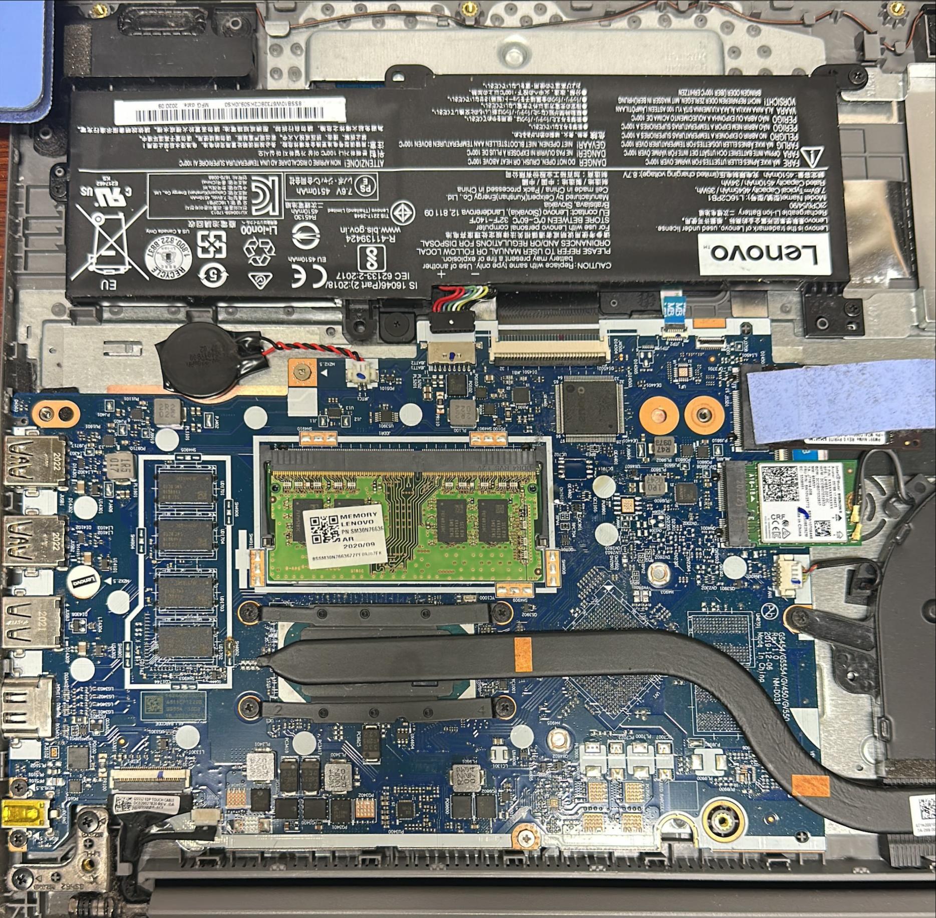

    Hello!
    Can someone help me with this bios please (power led blinking no picture)
    GS454/GS554/GV450/GV550 NM-D031 REV:1.0 (UMA)

                Re: bios for lenovo ip 3 15IIL05 OR GS454/GS554/GV450/GV550 NM-D031
                Hello friends, please help me, after updating Bios with Lenovo Vantage, my laptop stopped turning on. I found the Bios on the Internet, but it needs to be cleared and the serial numbers must be entered.
                This is what I have on the back cover of my laptop:
                IdeaPad 3 14iiL05
                Model Name - 81WD
                SN:PF2EV7YH MTM:81WD00U9US
                Mfg Date: 2021/01/15 Factory ID: JVHFC1
                On the board:
                Rev: 1.0 NM-D031
                2019-12-06
                Thanks for the help

                  We will need your Original Backup to transfer your DMI, so upload it here.
                    Thanks, here is my original backup

                      Here's your New BIOS file, it's a Virgin BIOS from Lenovo with your DMI.
                        Thanks for your help, the laptop is turned on, hides well, Lenovo Vantage sees the serial numbers of the laptop, but if you turn it off, after 30 minutes you can turn it on only with recharging and pressing the power button twice for 10 seconds.
                        Worked fine until Lenovo Vantage started updating Bios
                              Pls tell me this Bios with pure ME region? Other craftsmen tell me that in order for the laptop to turn on normally and work, it is necessary to clean the ME region, and for this laptop it is very difficult to clean it because the processor is 10th generation. They say that a service Bios is needed.
                                It's a Virgin BIOS from the Vendor "Lenovo", so the ME Region is already clean.
