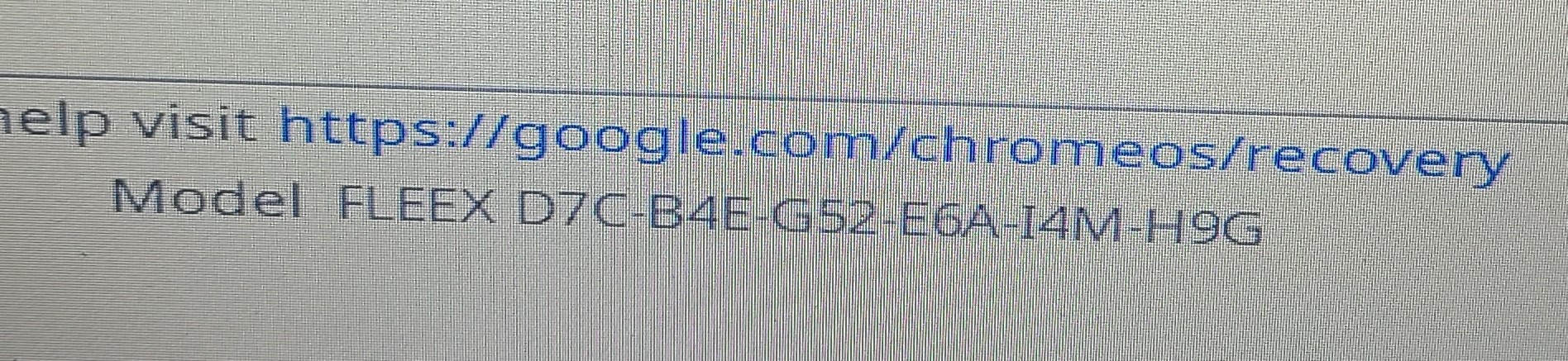

            Hello everyone, i have a dell 3100 chromebook with enterptise lock. tried the bios posted in the link above. but doest display. any help will be appreciated. my backup is bellow.

              Do we have to keep reminding you to post the serial number

              You MUST:
                https://www.badcaps.net/forum/showth...10#post1272610
                https://www.badcaps.net/forum/showth...96#post1218596
                You MUST:
                sorry about that. now noted.
                This is the serial, yes?
                FLEEX D7C-B4E-G52-E6A-I4M-H9G
                OR
                FLEEX D7CB4EG52E6AI4MH9G
                REG-MODEL P29T
                    OR
                    REG-MODEL P29T
                    nope, look on the label from back cover, it starts with: D97...
                    • Tjaytony
                      • Oct 2020
                      • 114
                      • Nigeria
                      Re: dell 3100 chromebook
                      Okay, D97TR73
