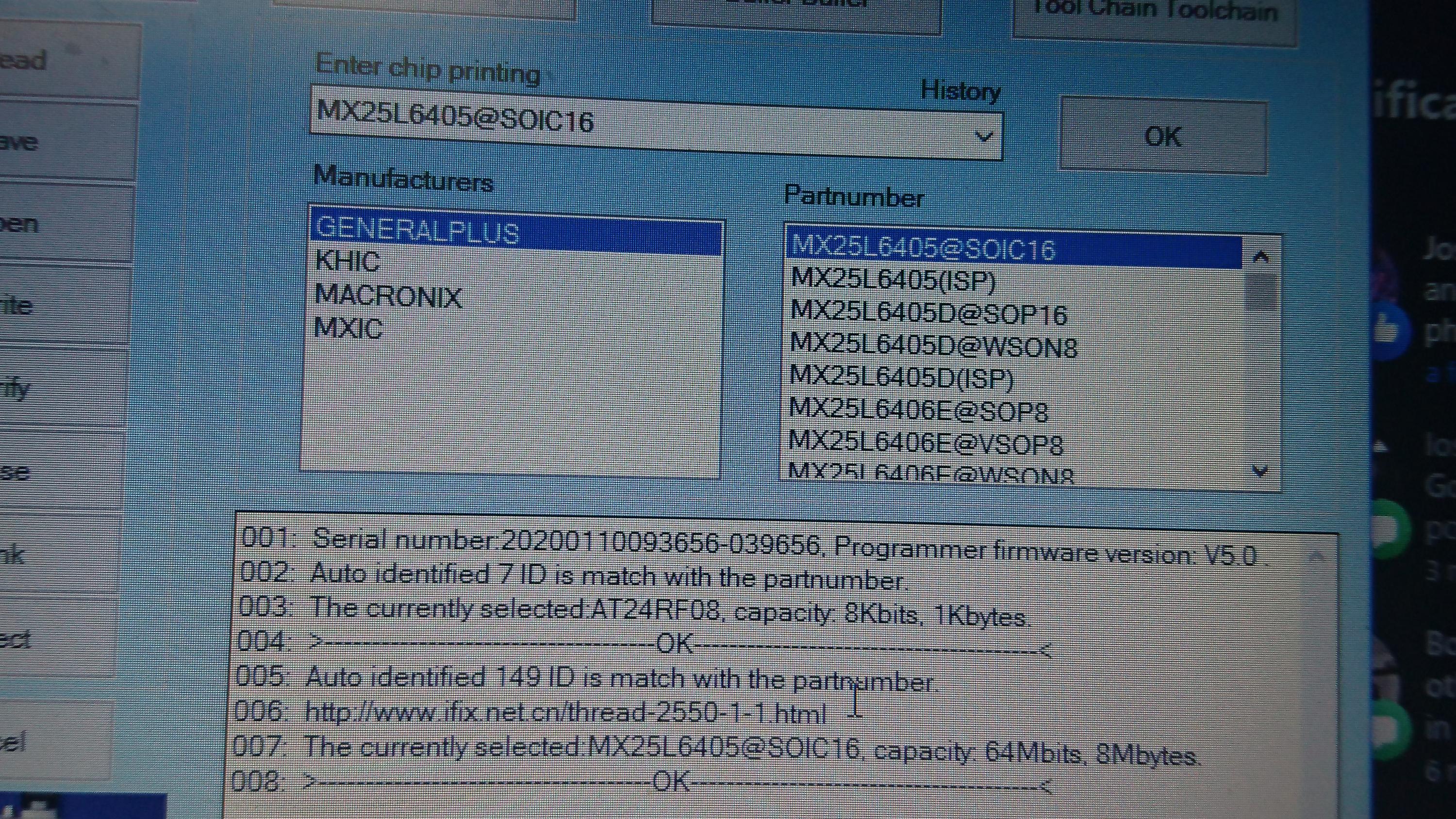

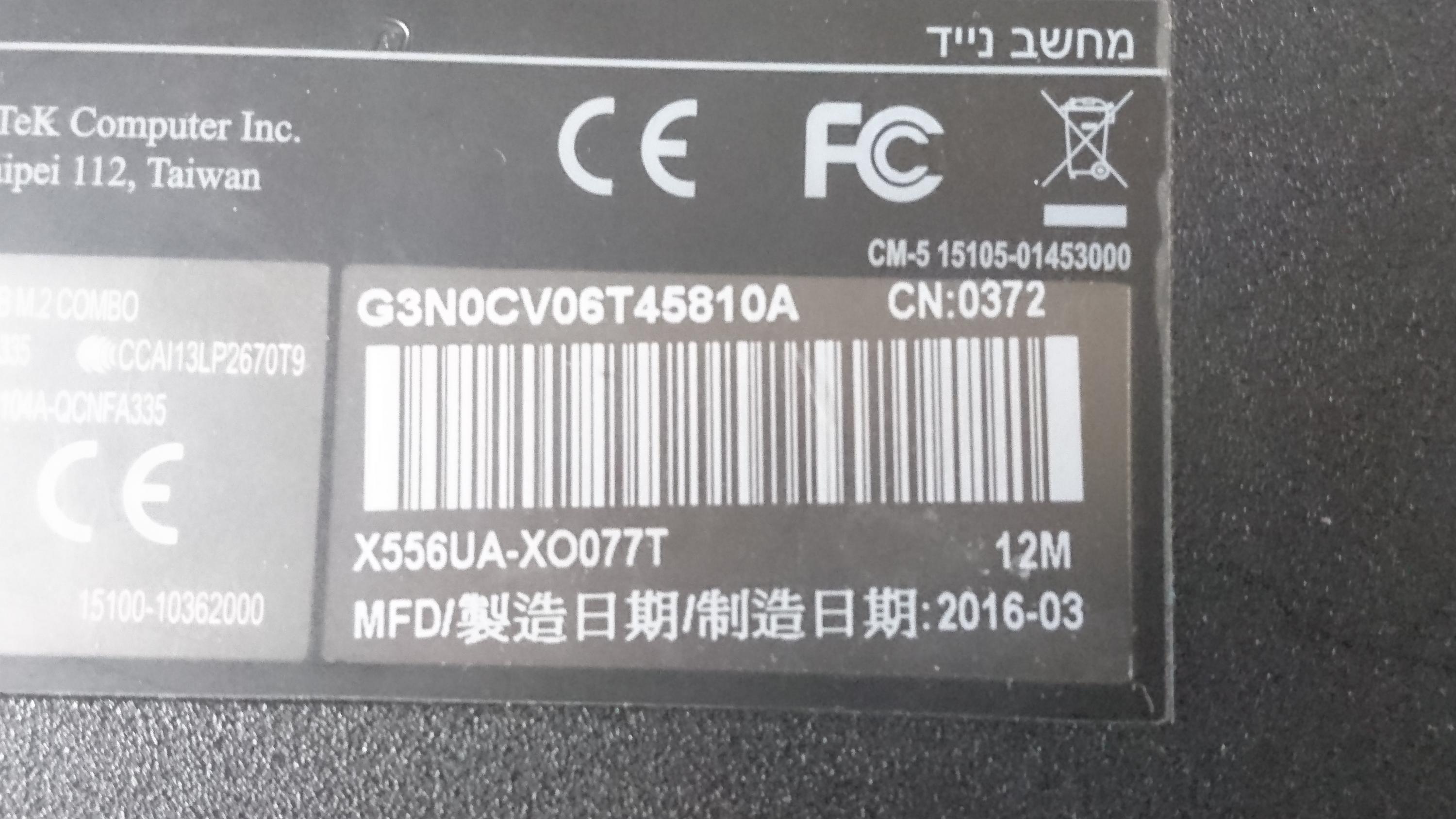

    Hope you can help me with REPROGRAM \RESTORE (?)BIOS for Asus x556ua i3 6100u 4 ram soldered ( integrated intel gpu)
    Yesterday, probably by Windows update, the above RUDE! laptop decides to update the bios on his own WITHOUT ASKING ME \ LET ME CONFIRM it!
    unfortunately, while he's erased the older version, I've had a power outage 😢😢
    The laptop is died now, no fan\ hdd\ dvd spinning, obviously, no display too,

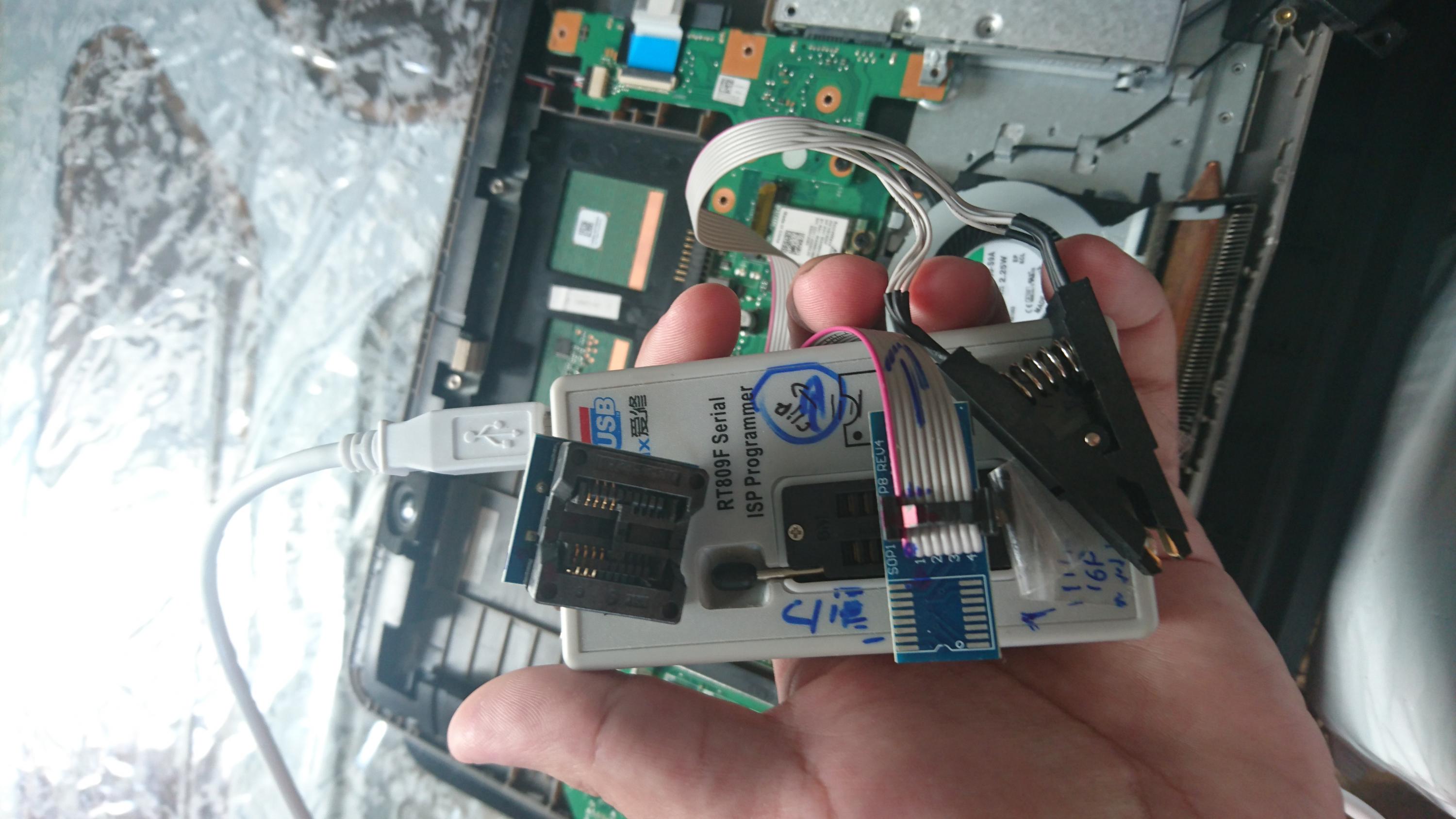

    I've tried to download the bios file from asus and flash it with my Rt809f programmer that I have, with no luck, NOT SURE IF I'M DOING THE PROCESS AS I SHOULD so I'd like if someone can help me
    Here's how I've tried
    1 downloaded from asus( I'VE TRIED MANY VERSIONS! - Even tried to change file extension to. Bin)
    2 open the program,
    Clicked auto identify
    3 clicked read->save-open- write

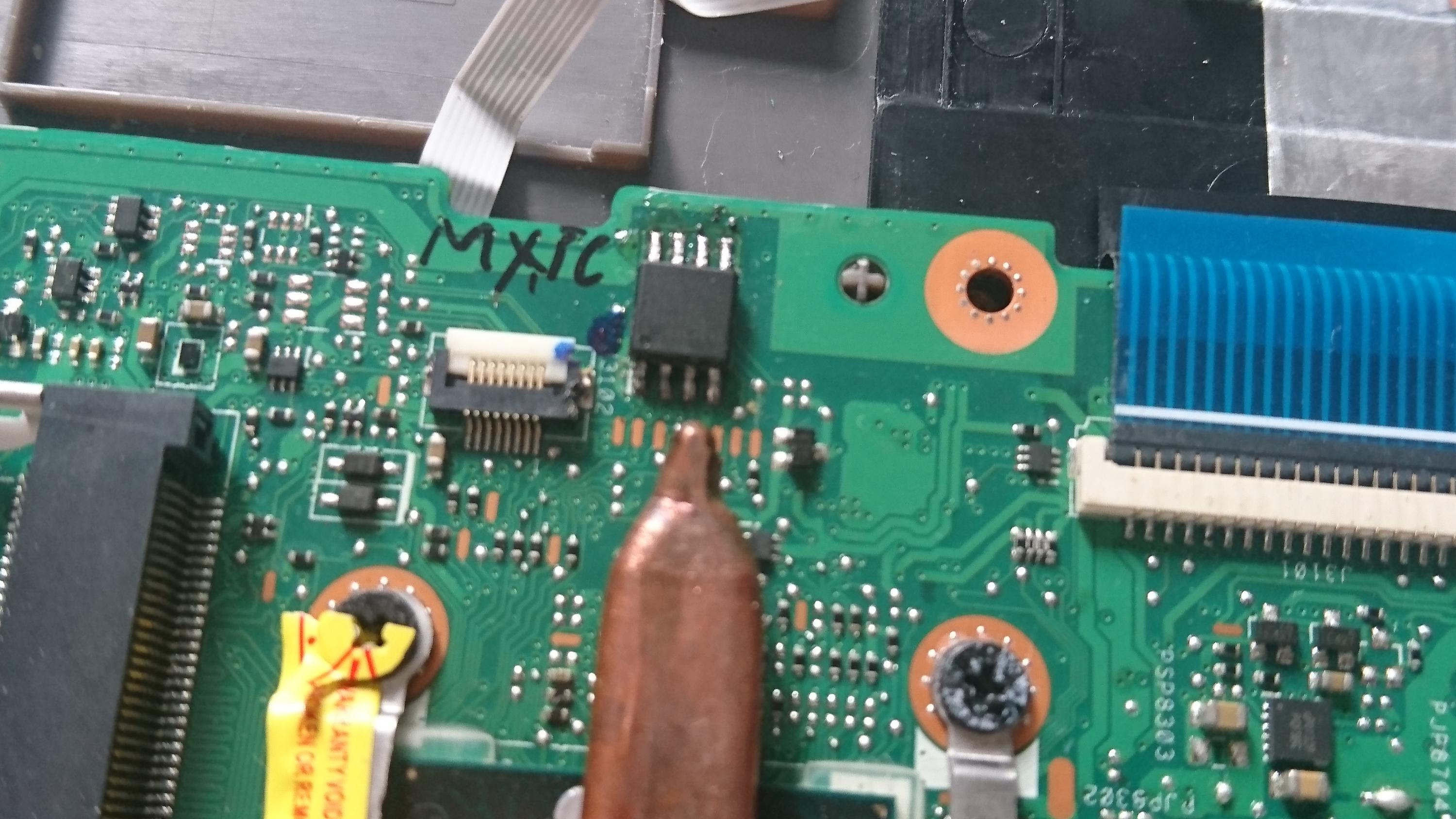

    I've tried that few times, nothing sort it out, maybe i missed the bios chip and flashed the wrong IC?
    Or I've done something wrong on the process steps above?

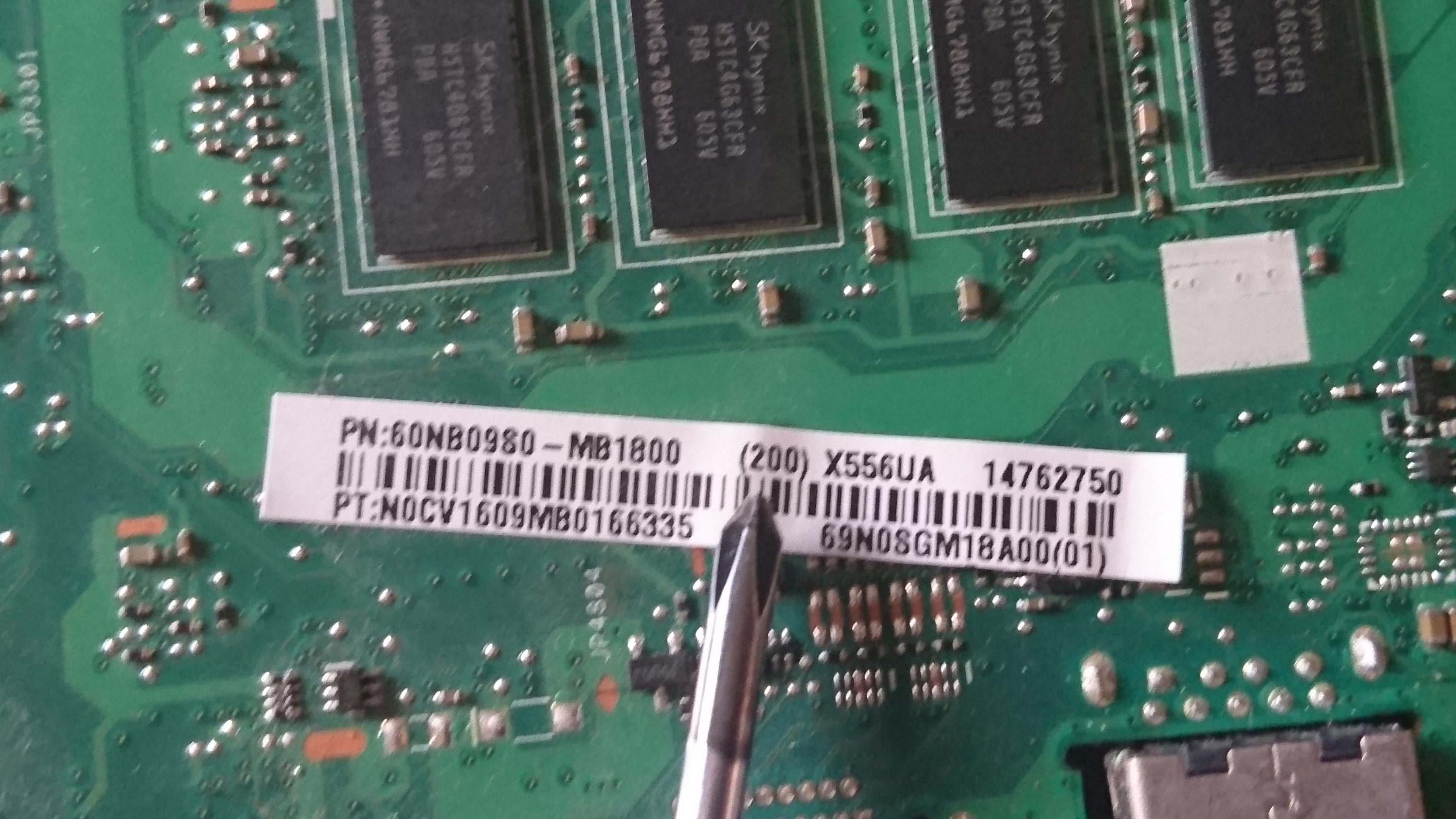

        not sure if u meant to the Ic part number which is MX25L6473E
        or to the file that ive initially read from the ic which is attached here[ive tried to flash it too
        or to what was the factory FW version[ which i have no idea

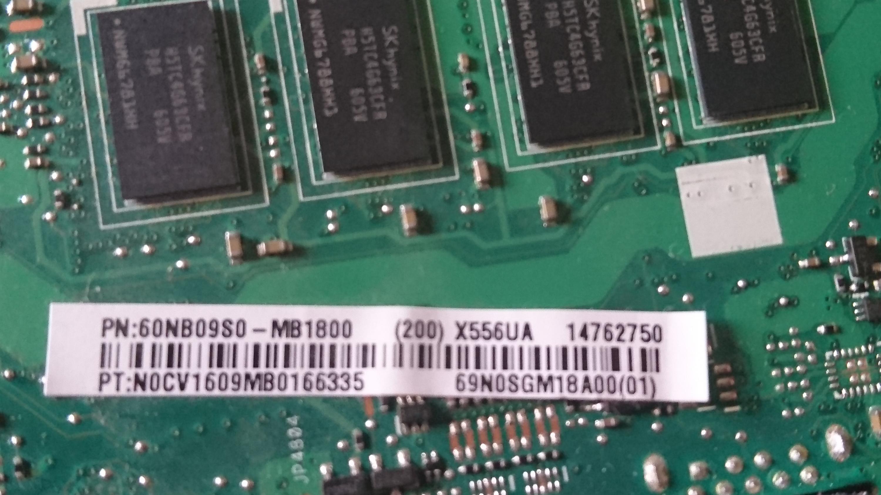

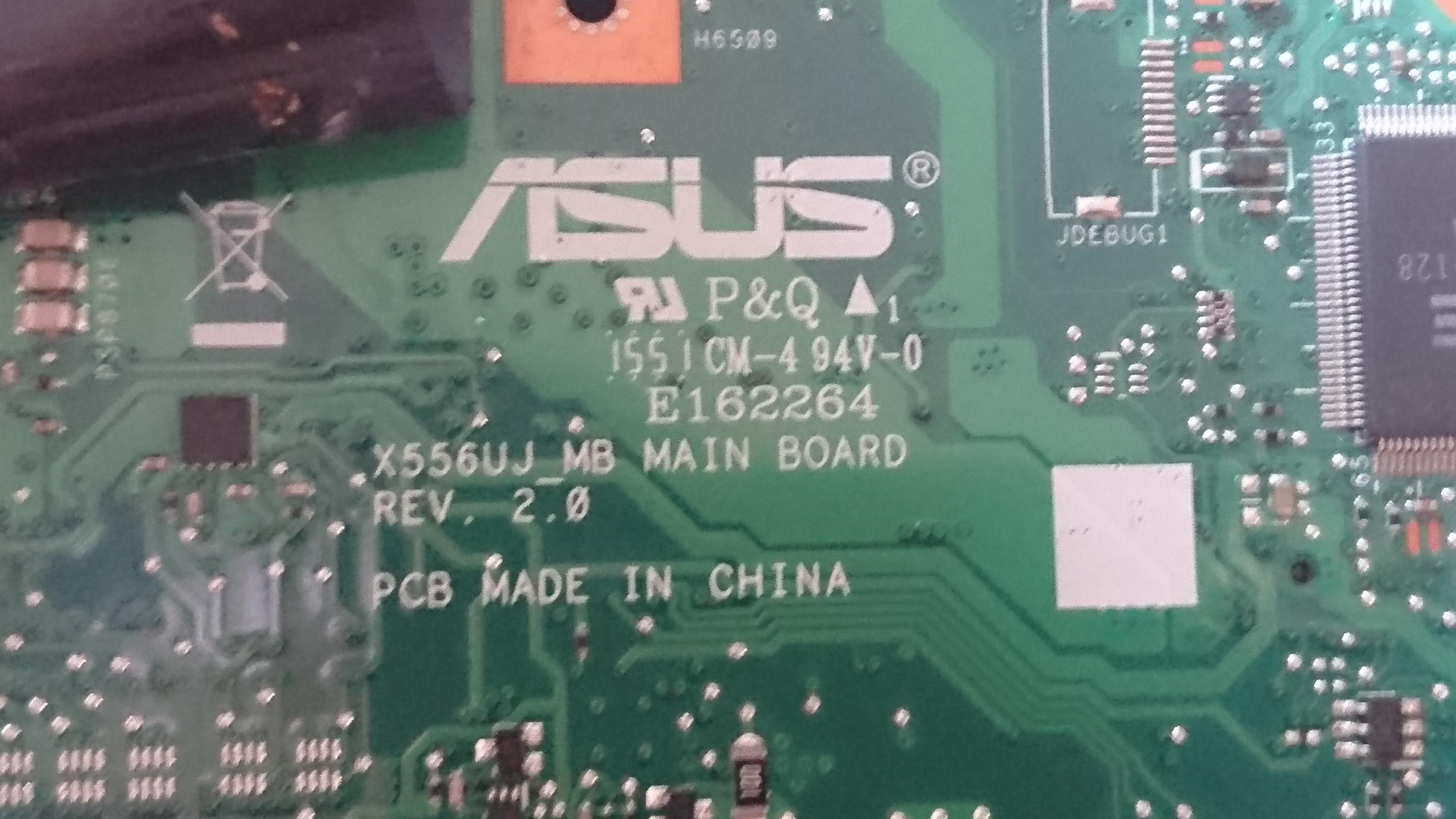

                  Request: ME Clean BIOS – The laptop powers on and have a black screen, the charging works fine.
                  I’m looking for a ME Clean BIOS for this board.
                  If anyone has a clean dump or can help me rebuild it, you’d be a lifesaver! 🛠️💻

                      I have flashed the BIOS, but the screen still stays black and the laptop shows no signs of change or improvement. Thank you for your help.

                        After flashing thus specific BIOS, the laptop finally turns on — the ASUS logo appears, and then the Windows logo starts to load. However, when the Windows logo shows up, I get a blue screen and the laptop shuts down. It then restarts and keeps looping.
                        I think the BIOS might be incompatible, because my laptop has an Intel i5 processor, while the BIOS version I flashed was for an i3 model.
