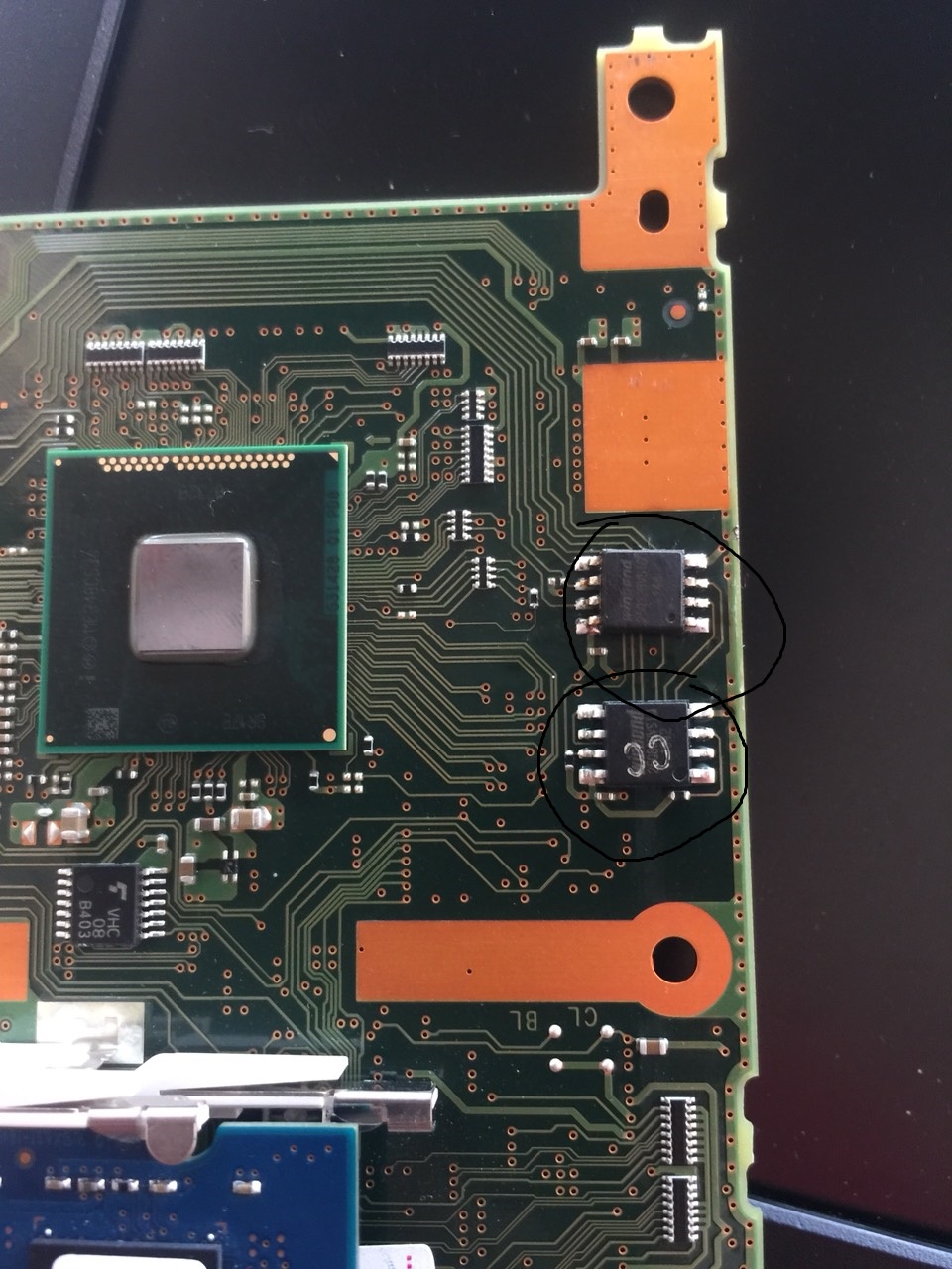

        Re: Need bios Fujitsu Lifebook A574/H
        is this the same bios bin?
          • 21211
          Originally posted by gambitxp
          help please this is the same bios bin?

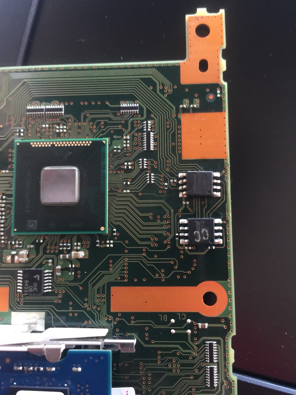

          If the bios has corporate ME firmware it will be split across both chips.

            Re: Need bios Fujitsu Lifebook A574/k
            what so you mean sir..dou you have Fujitsu Lifebook A574/k
              • 21211
              Backup both chips and post them here .Whats the problem, password,no boot ?
                no boot sir
                • gambitxp
                  • Aug 2020
                  • 16
                  • philippines
                  this is the backup sir

                      • 21211
                      Both backups have no code,what model is your programmer
                          ch341a my programmer..sadly i erase the main bios bin.i though i was save the backup

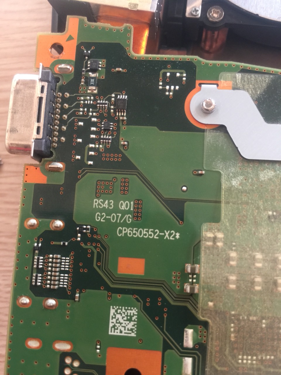

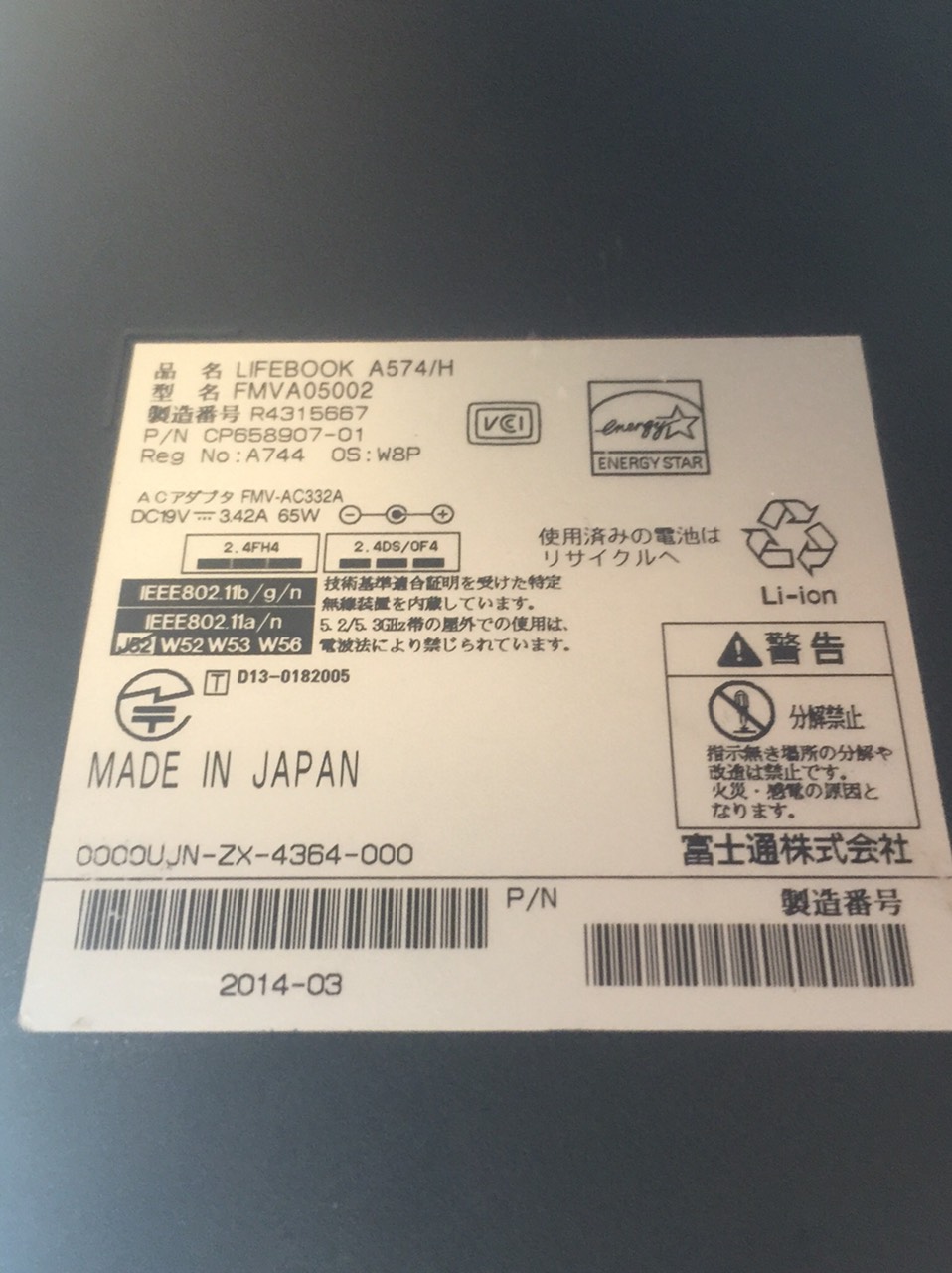

                          • gambitxp
                            • Aug 2020
                            • 16
                            • philippines
                            can request backup bios bin of that two chips..my laptop is fujitsu lifebook a574/k. can i use the backup files of fujitsu lifebook a574/h ?
                            • gambitxp
                              • Aug 2020
                              • 16
                              • philippines
                              i think the purpose of two bios is the main and the EC rom
