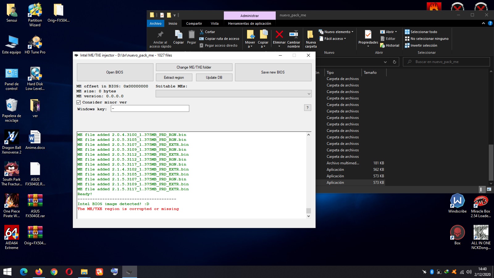

              Asus FX504GE ME corrupt?
              hi i recover the original bios and display and works but windows control have no permision, some error "admin", and ME injector/extractor have no ME/TXE or corrup dont recognize bios.
              anyware can me clean/check and onsert new ME o something

                try..

                  hi thanks to asnwer the program tell same error.in 45min flash and return if i have a error

                    why you are using me injector peste has fix already your dump you have to just flash it now. No need to do anything else your file is configured already & its a ''CSE ME'' this will not work with injector

                      works and boot ok very fast screen but dont detect sata port hdd, now reinstal system with M.2 Nvme pci-e(its the only have, dont have a M.2 sata).before are to slow to boot, are thechip set problem? hmm SN are Clean and Mac are 00 00 but its work i dont care this
