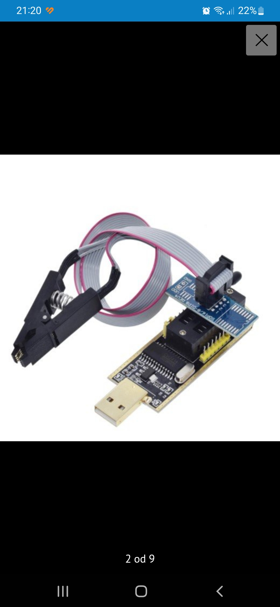

                  Hi everyone!
                  I have Lenovo Ideapad MIIX 720-12IKB. I do not want to open my device. Can someone help me how to create backup of my BIOS and than point me to the offset where the BIOS password is? I have Win10 64 bit running, I only need to unlock BIOS to make some settings changed.

                      • hoaca388
                        Badcaps
                        • Jan 2022
                        • 12403
                        Re: Lenovo Ideapad MIIX 720-12IKB
                        Originally posted by schveky
                        Need to mention, the BIOS Tool did not recognized my BIOS chip so I selected it as "custom 8MB chip"
                        Next time use a programmer to backup your bios, your backup file is not good but luckily can find an virgin bios file from *.cap file.
                        But I wonder how can you write this to the bios chip without a programmer?
                          I am not intending to write to the BIOS chip. I was hoping that someone can locate the password in my BIOS file, just like they did in lenovo miix 520 topic. After locating it one can decode it using scancodes. After that accesing the BIOS is simple (using decoded password).
                                  @schveky
                                  This BIOS is different, as far as I know the password is stored as a 128-bit hash (MD5?) in "SaDataBase" UEFI variable.
                                  So the first thing to do is to reverse engineer the driver(s) writing to this variable in order to determine if the code is hashing the password as an ASCII string, scan-codes of the password or other, then you could try to brute force crack it, maybe even build a sort of rainbow table so you could decode the passwords immediately.
                                    @AAAC
                                    Tank you for reply. To be honest, I was expecting a simpler answer, because decoding the Miix520 BIOS password sounded like peace of cake, comparing to things you wrote. If I open my device, is it neccessery tho unsolder the BIOS chip in order to write a new BIOS file to it? Or, I can use a EEPROM programmer with a cliping tool, so no need for removing the chip? I was thinking if I remove the main laptop battery and CMOS battery, wait one day, than attach programmer via included clip...
                                      @schveky
                                      There's no way to know what you will find, unless we have the motherboard schematic or unless you disassemble the laptop in order to find the BIOS chip.
                                      I've seen this "SaDataBase" uefi variable before and the password hash it stores, I've been wanting to write a program to brute-force crack the password assuming this is a MD5 hash and also assuming that it will be an easy password (max. 6 characters). I've even asked a friend with a laptop with a similar BIOS to set a known password and to provide a BIOS dump each time, all I need to do is to check a few of the DXE/SMM drivers writing to "SaDataBase" variable.
