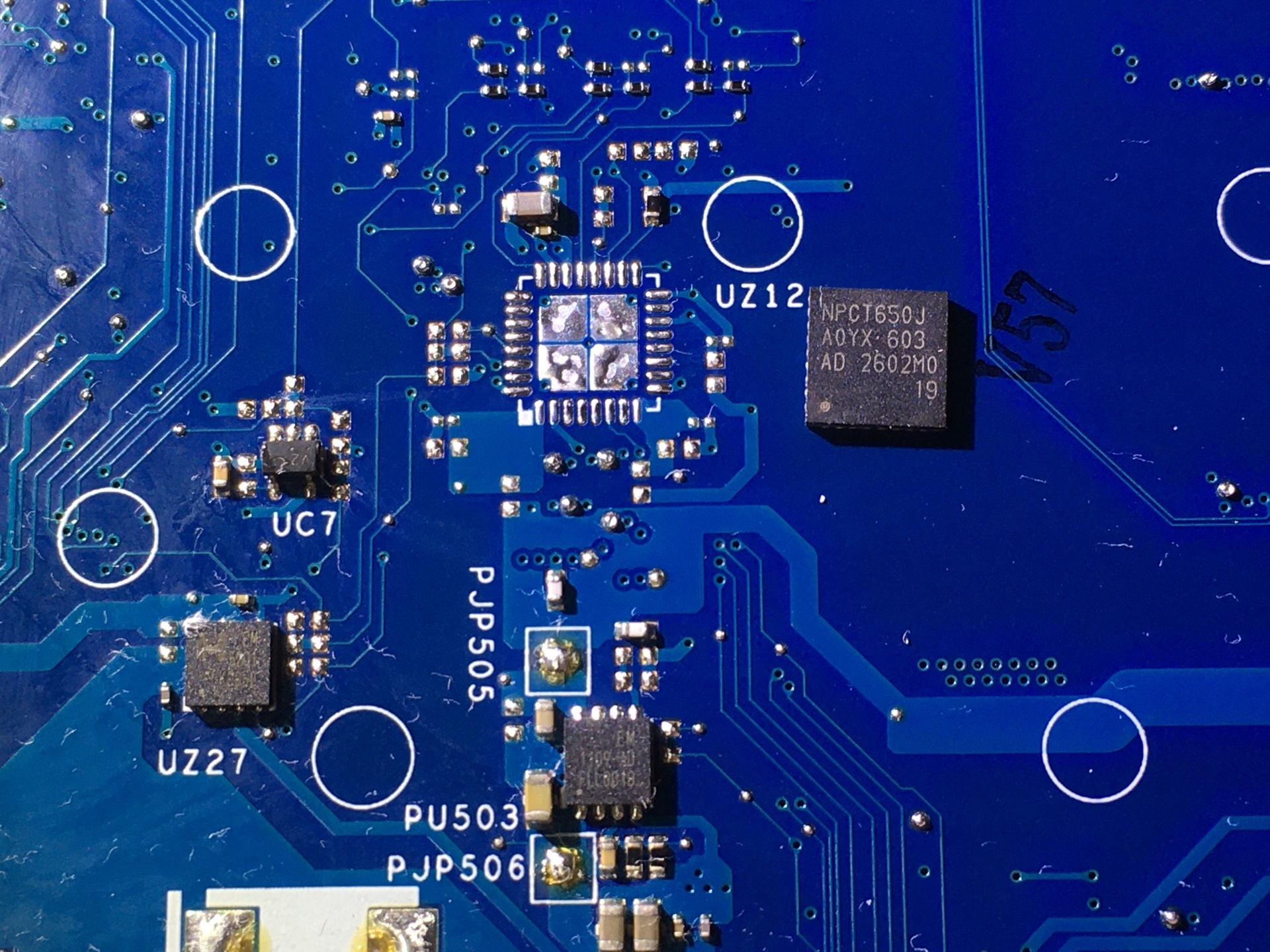

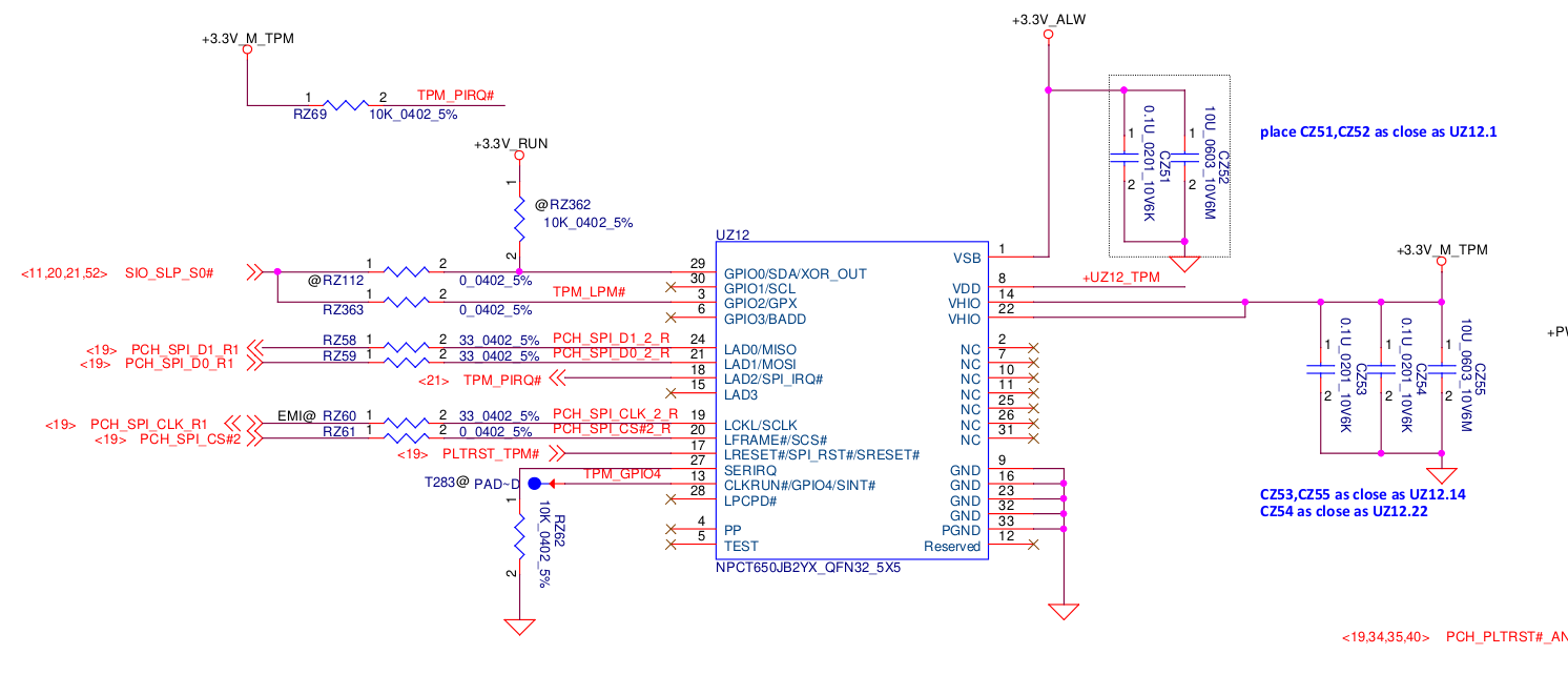

                                  #100
                                  Hello, I also had a Dell 5580 with alert! tpm device is not detected
                                  Editing BIOS doesn't help.
                                  What helped me was swapping the TPM UZ12 chip from a donor board and then everything was quiet.
                                  Good luck.
