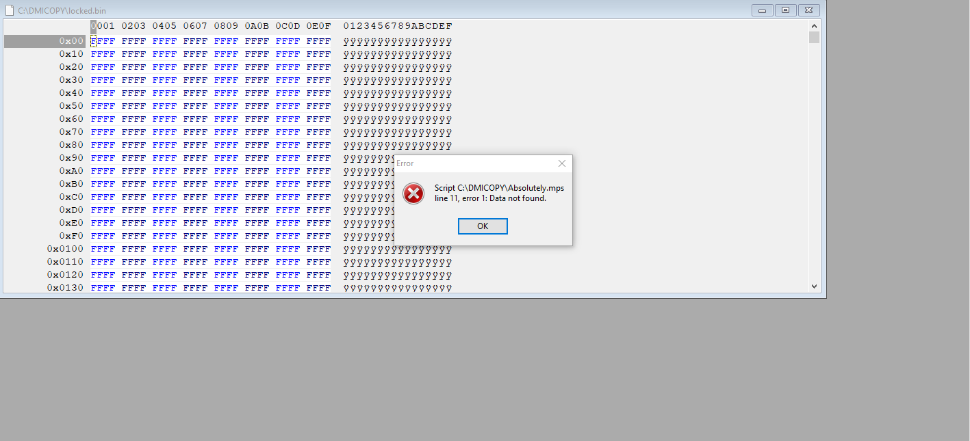

                            #133
                            Hello Guys please i need help , i would like to remove computrace on a 5580 Dell Latitude.
                            ST: DBZPZM2
                            mother board model : CDM80 LA-E092P
                            IN attachments the BIOS + EC .
                            thx in Advance
                              • 22293
                              #134
                              ST: DBZPZM2
                              thx in Advance
                              try this https://www.badcaps.net/forum/troubl...79#post3633379
                              • florenz
                                • Apr 2018
                                • 50
                                • Cameroon
                                #135
                                Originally posted by SMDFlea
                                thx for the feedback i tried and i had an error issues , kindly see the screenshot in attcachments.
                                thx

                                  #136
                                  ST: DBZPZM2
                                  thx in Advance
                                  Corrupted files!!
                                  • florenz
                                    • Apr 2018
                                    • 50
                                    • Cameroon
                                    #137
                                    Originally posted by ERRA
                                    Corrupted files!!
                                    so?
                                    • m1ch43lzm
                                      • Mar 2019
                                      • 1136
                                      • Peru
                                      #138
                                      florenz Read BIOS chip again W25Q128
                                      • florenz
                                        • Apr 2018
                                        • 50
