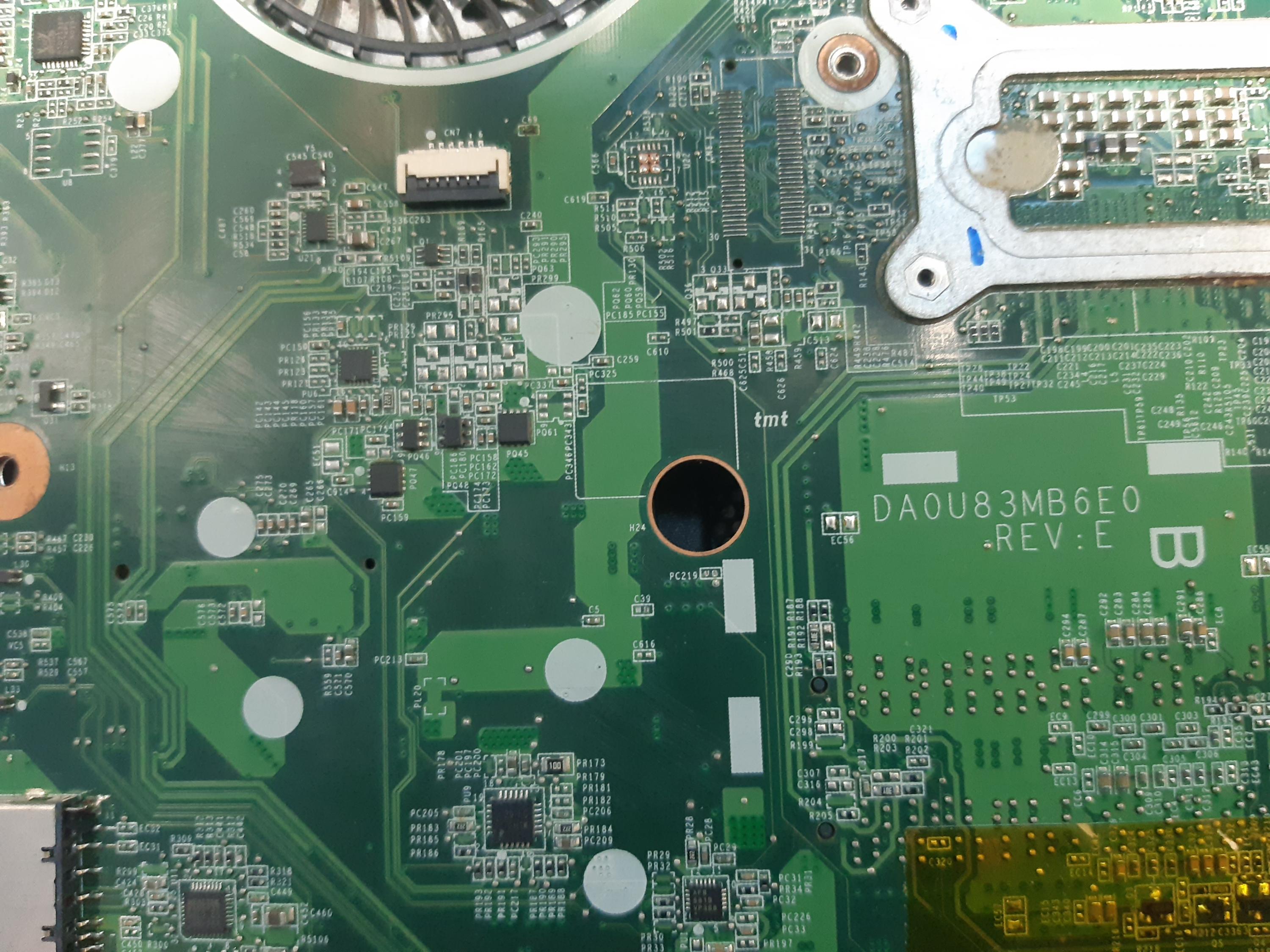

    Need bios bin for HP Pavilion 15-no47cl DAOU8M3MB6EO. Old one submited.

    Re: HP Pavilion 15-no47cl bios
    Error on typing its DAOU83MB6EO REV E
      the posted bios is half empty..check and post once more ..
        Thanks, but this is the only one I have, maybe it was already corrupted, Ive tried another one but still power on no display.My only concern is PQ48 was burned, changed it and getting voltage 3.3v as per schematic.
          The extracted hp 15-no47cl bios update has 4 different bios.Try these. 02183 is the only 4MB bios,the others are 8MB
            Thanks, will try & revert back.
              Many thanks, laptop boot after several bios flash but now freeze constantly, will re-install windows or swap hard disk and check.
