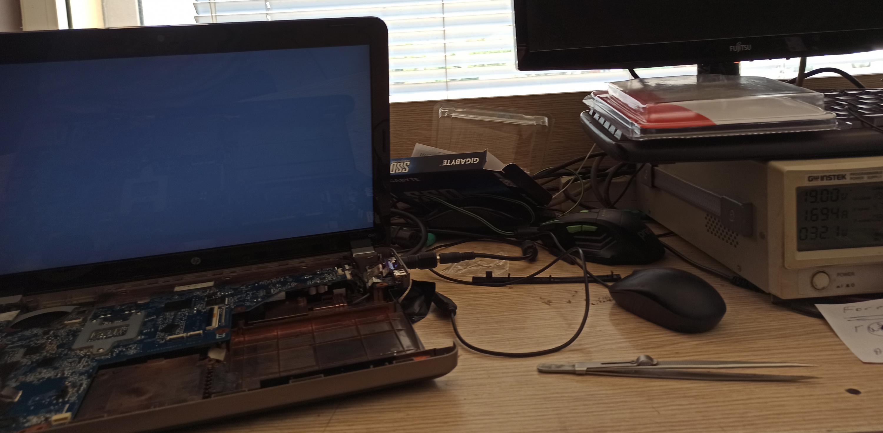

    Hi. I need bios (g42-475dx / da0ax2mb6f0)
    There is black lighting in the back but no image.
    Draws 1.3a - 1.8a amps.
    I want to try the bios without reflow.
    HP: g42-475dx
    da0ax2mb6f0
    The external monitor light turns blue and then turns orange again.
    The bios I downloaded from HP that I thought were defective were added.
    Thank you.

      It's not triggering with your bios, man. I wrote the old bio in the same way.

        Probably originating from the gpu chip.....

          Can you have a working bio or can merge attached files? I want to try with before gpu.

            bios extracted from the HP site update
            DMI 20000-200FF

              Thank you. It fixed with reballing. The subject can be closed.
