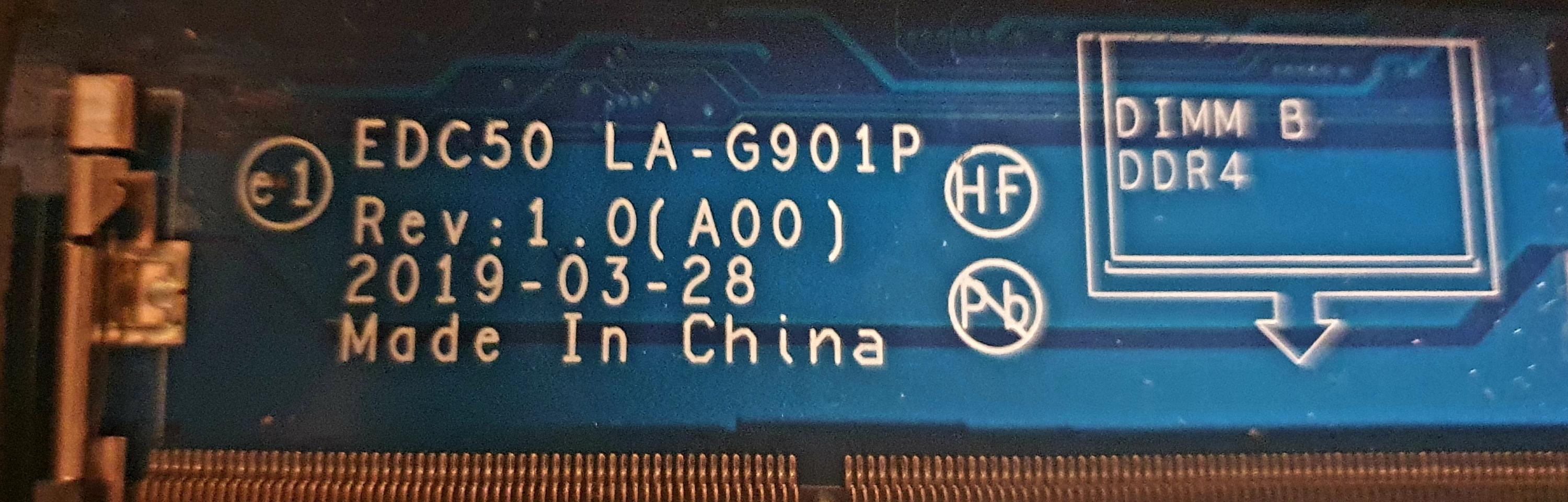

    Dell Latitude 5500 Bios
    Hi
    Any 1 can provide clean bios dump for this model or remove current password.
    EDC50 LA-G901P
    REV 1 0(A00)

              Re: Dell Latitude 5500 Bios
              MB : EDC50 LA-G901P Rev:1.0(A00)
              CODE : 805BYY2-8FC8
              both dumps in archive - BIOS + EC

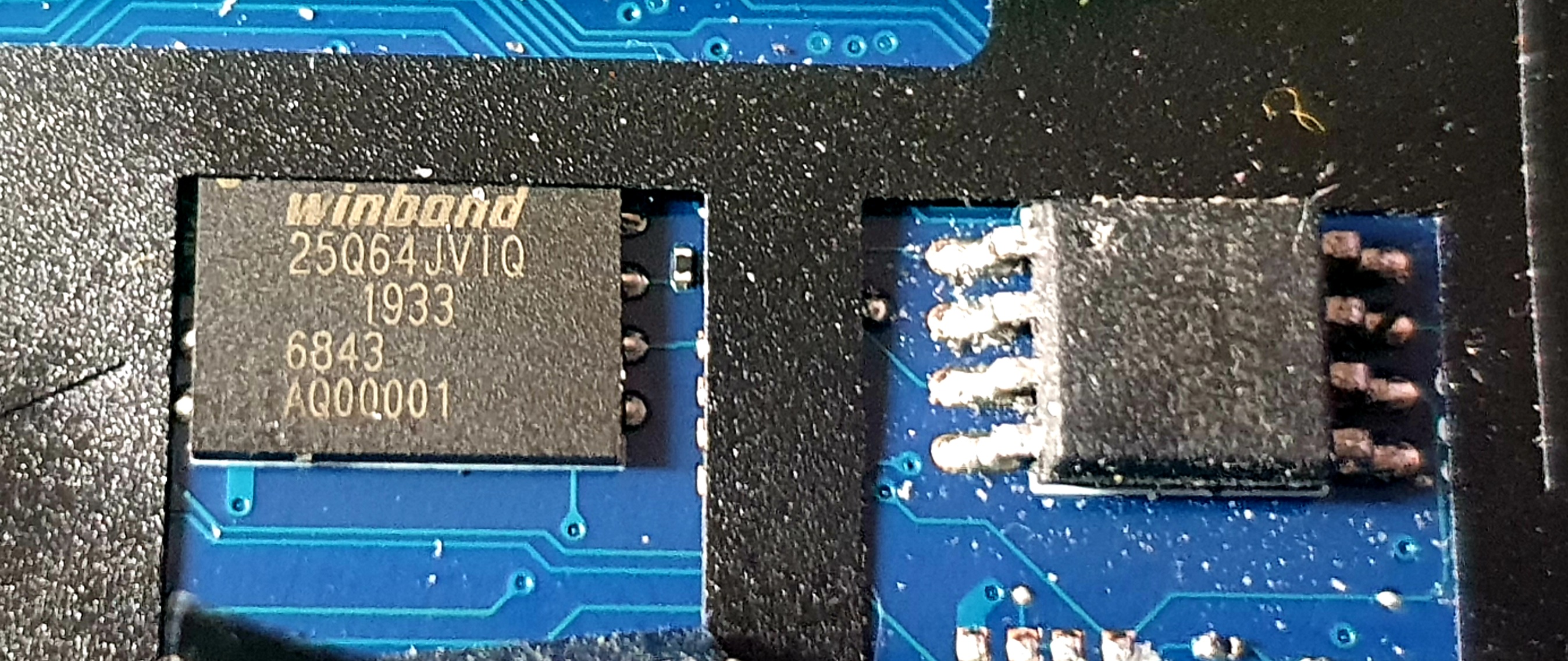

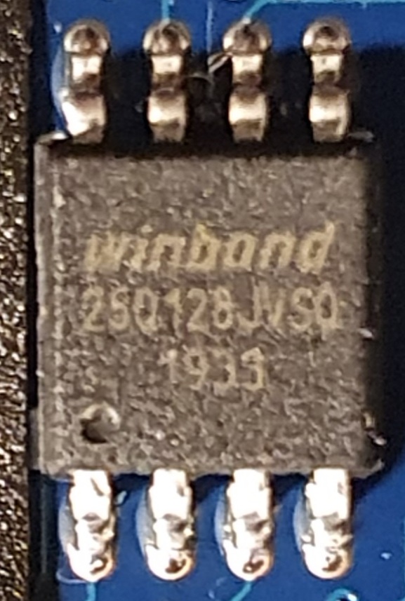

                                    Hello.
                                    Since it is same model, I will not open new thread for this.
                                    Please help me remove Admin Password for this DELL Latitude 5500.
                                    There are 2 chips on the motherboard :
                                    One is 25Q128 and it is the BIOS (main program) and the second is a 25Q64JVIQ WSON 8x6mm and I suppose it contain the passwords and other non volatile information.
                                    I managed to downgrade the 25Q128, from official 1.41 to 1.0 so I can confirm that is indeed the BIOS main program.
                                    I post here the 2 bin files as I managed to de-solder the 25Q64 to read his content with EZP2019+.
                                    Can you please help me remove the password ?
                                    Many thanks.

                                      DELL Latitude 5500 Bios Dump Request
                                      Can someone post a dump of a DELL Latitude 5500 main & secondary bios ?
                                      Main is 25Q128 and it is the BIOS (main program) and the second is a 25Q64JVIQ WSON 8x6mm supposed EC ?
                                      Are there any other circuits on this MB (try to disable Admin Password
                                      Attached, the circuits, one near other (with closeup on main) , the motherboard is EDC50 LA-G901P Rev:1.0 (A00).
                                      Many thanks, have a great day.
