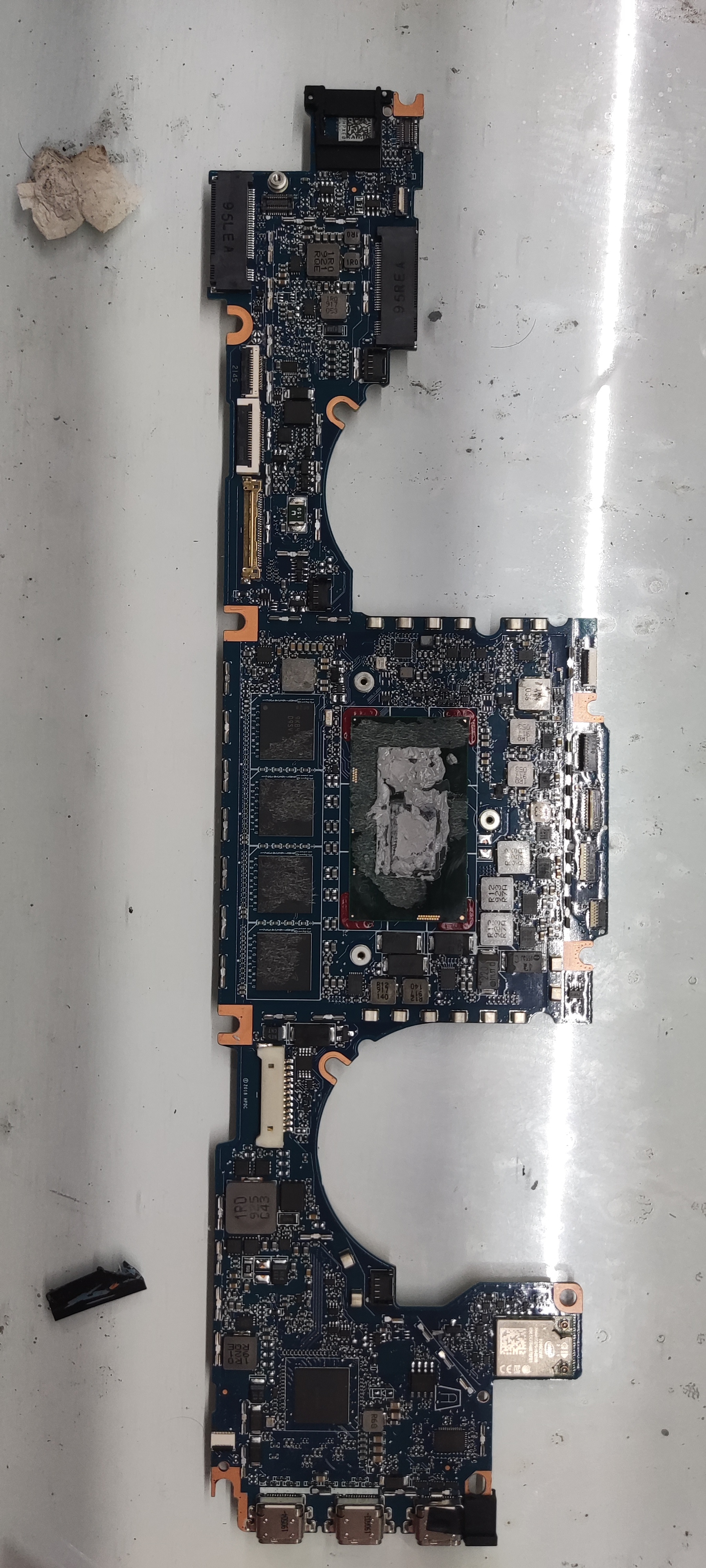

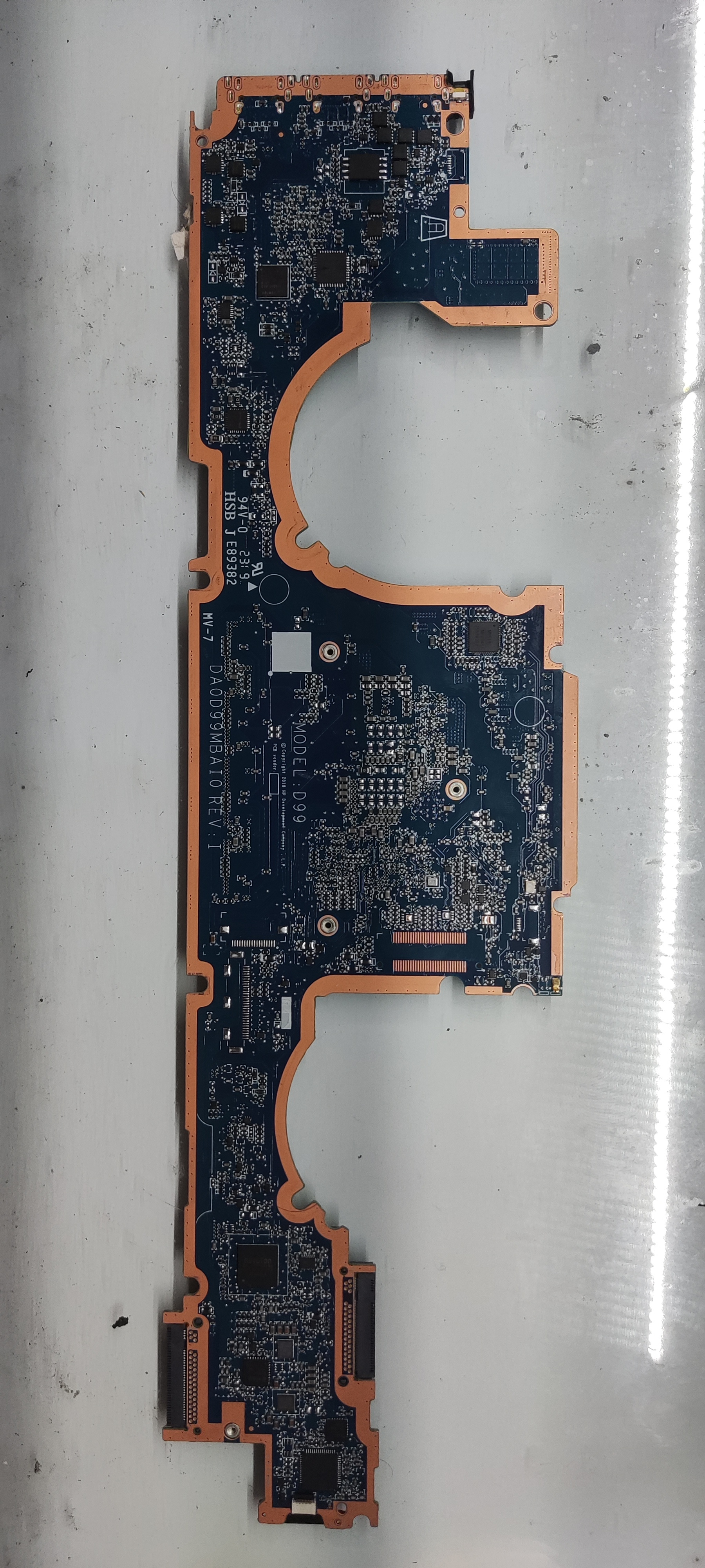

                        • abbassink
                          • Aug 2015
                          • 83
                          • iran
                          #52
                          I can't find anything , can anybody help me to find the bios location?
                          • Vesko356
                            VIP Moderator
                            • Aug 2018
                            • 4386
                            • Bulgaria 🇧🇬
                            #53
                            What are the chip markings?
                            Click image for larger version  Name:	IMG_20231209_160613.jpg Views:	77 Size:	1.97 MB ID:	3168947
                            Become a Badcaps supporter
                            Thanks to all supporters.​
                            • abbassink
                              • Aug 2015
                              • 83
                              • iran
                              #54
                              my problem has been solved, the bios chip that i looking for placed on daughter board .thanks bro
