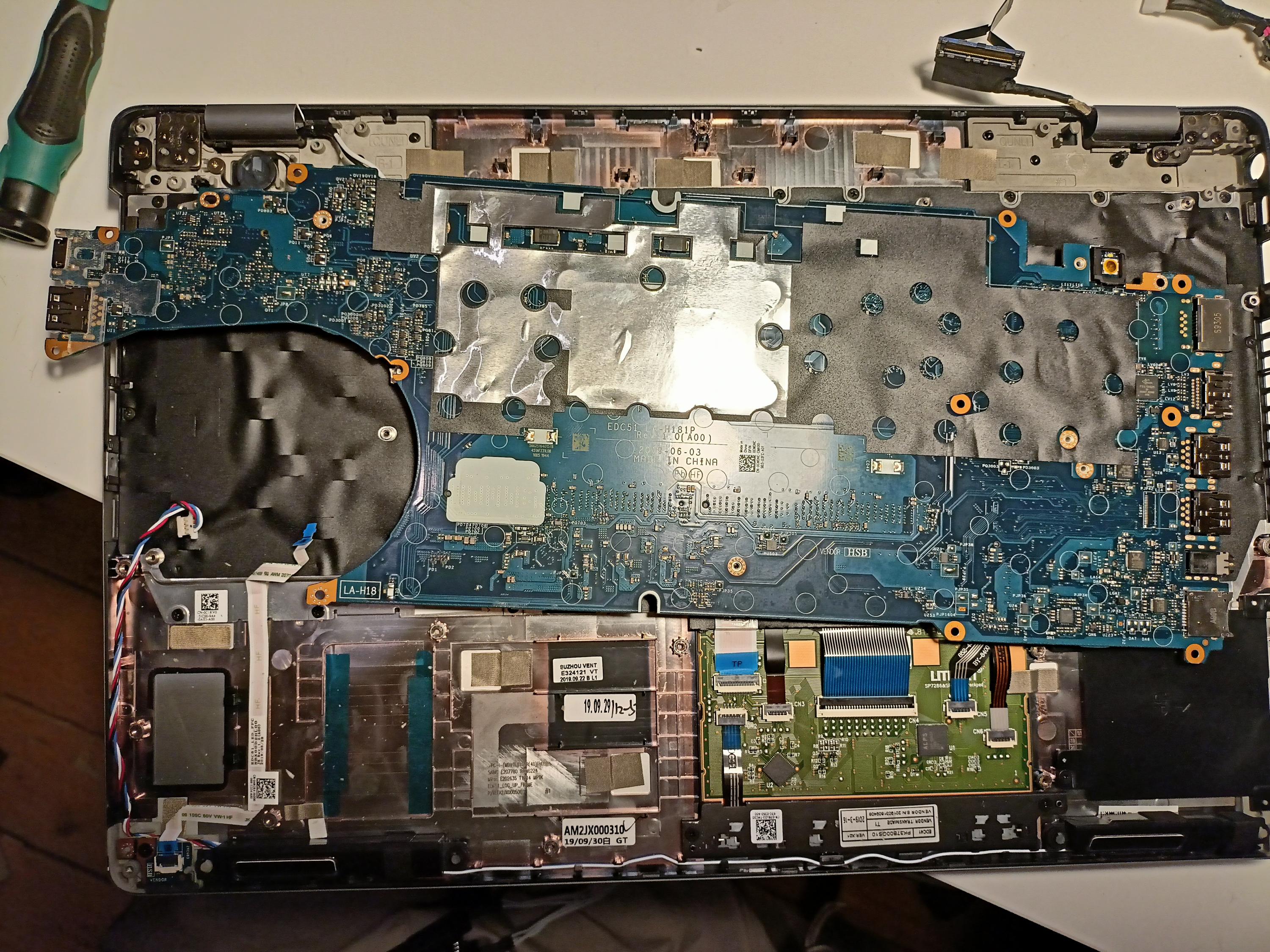

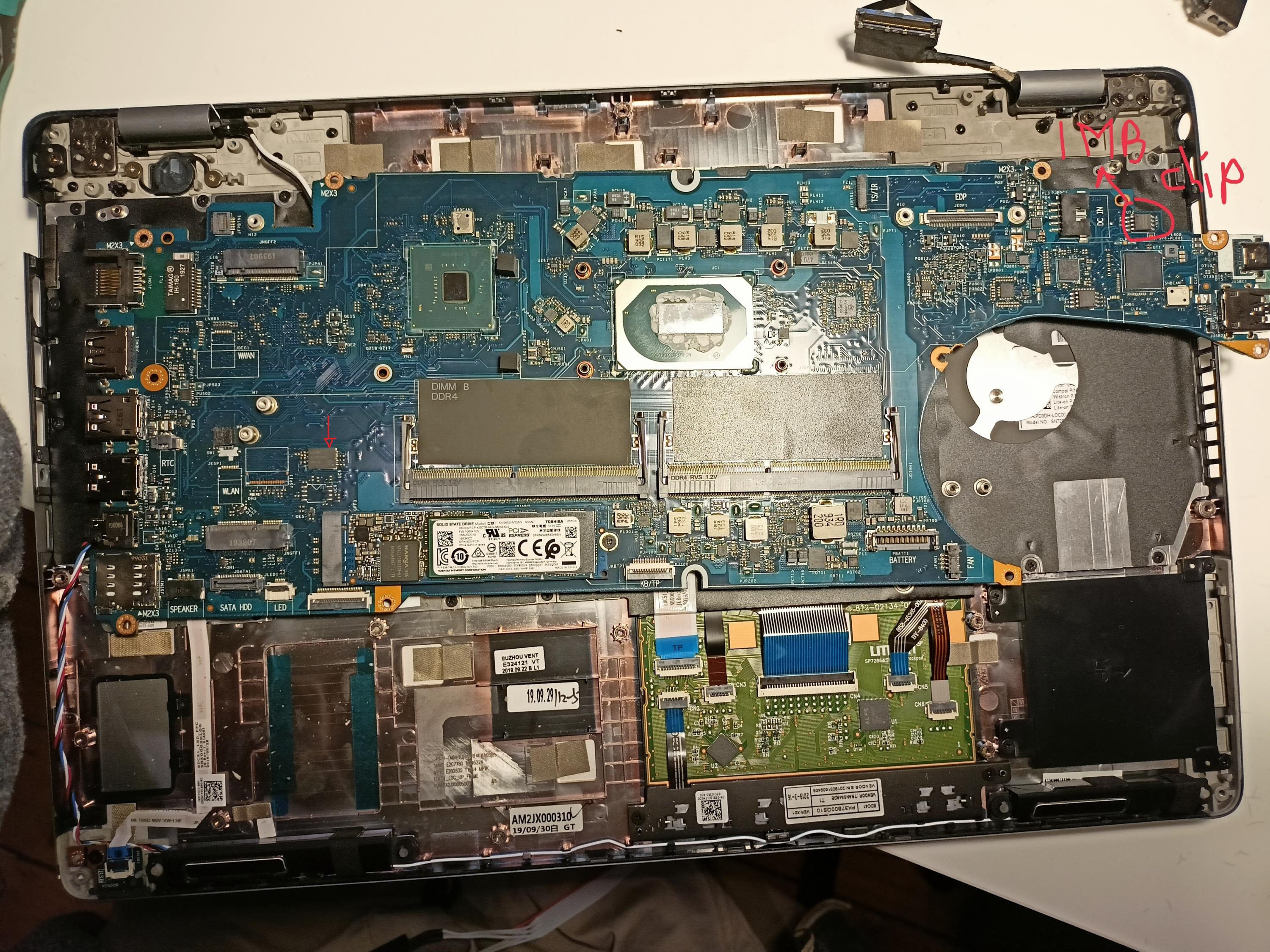

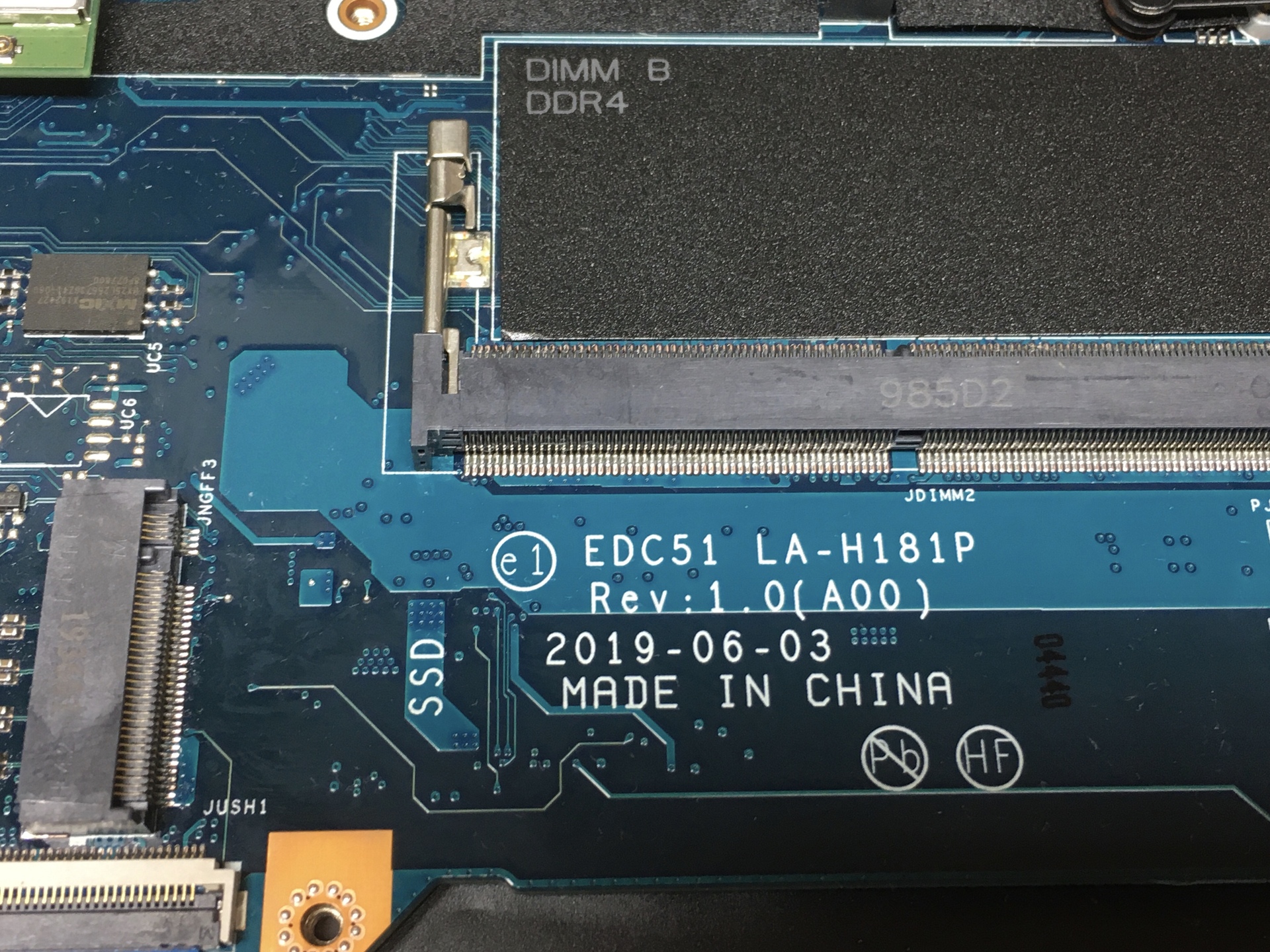

                            Hi guys! I've been trying to reset a bios password (8FC8) from Dell Latitude 5501, and I found a winbond chip, which has 1MB of data, but it all binaries that were sended by you are 32MB. So i think I'm working with the wrong chip.
                            Can you give me a hint - where is a 32MB chip? Motherboard - EDC51 LA-H181P

                              128 -> 16mb
                              256 -> 32mb

                                      send picture bottom and top of ur motherboard and i will point it
                                        #39
                                        Re: dell latitude 5501 9th generation 8fc8
                                        Thank you for your feedback! I've marked the chip that I'm trying to work with. If you need the pictures more detailed or separately - I'll be ready to send them!
                                          if u read 256 then this is ur main bios
