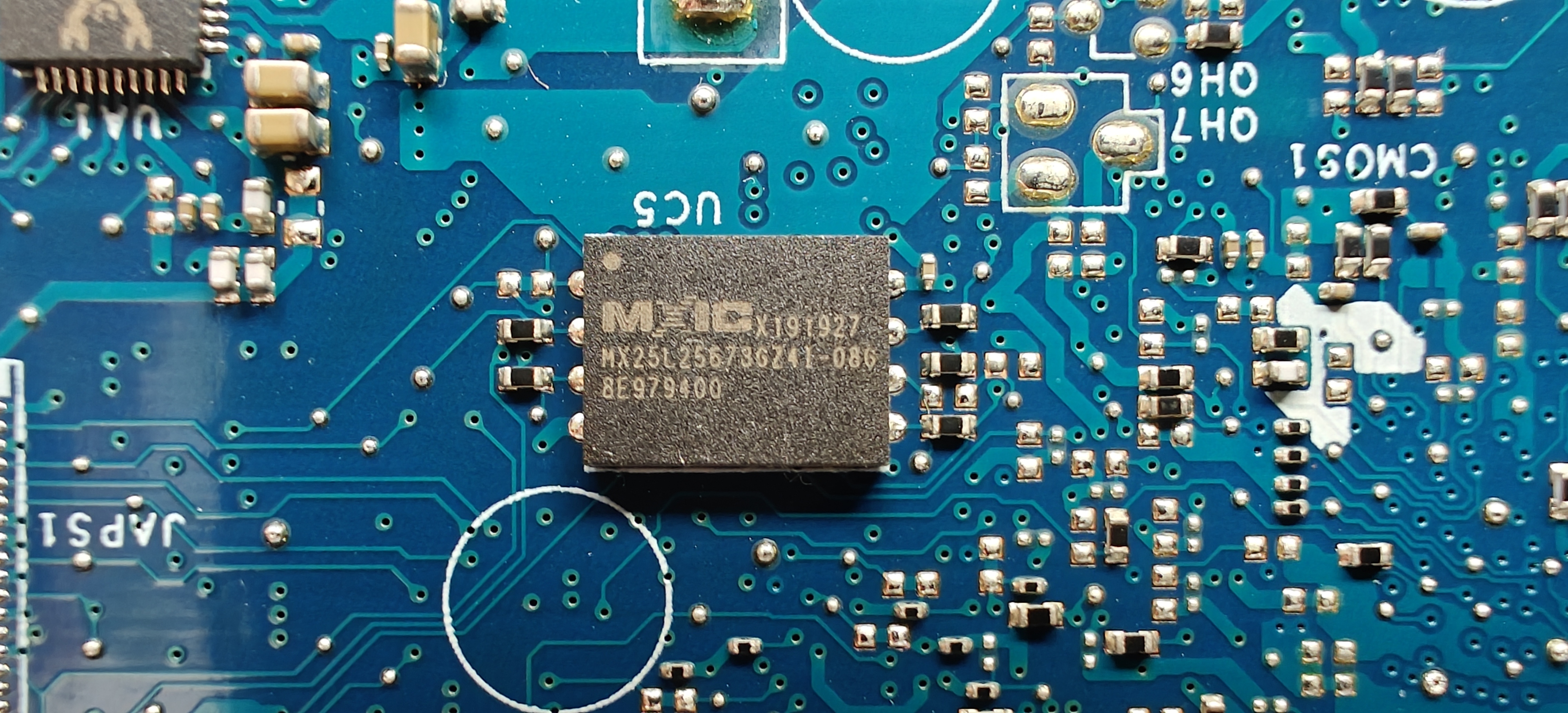

                        #71
                        Hello Guys,
                        I need to recognise a chip with bios on motherboard dell latitude-5501 la-h182p-rev-01 to replace (via CH341A) bin file (bios locked).
                        Could someone help me? I added a photo with picture - I think this is the red one.
                        Second do you have working bin file for this motherboard?
                        And sorry for the silly question but You are my last hope to get it back my old laptop
                        Last edited by Kamil_B; 10-24-2024, 03:33 AM. Reason: Ok, I think I found this mother...chicken. Please confirm if this is it :) And second I will be grateful for a correct bin file?

                          #72
                          Originally posted by Kamil_B
                          Hello Guys,
                          Here

                            #73
                            Hi there, thanks for the quick answer Do you have any working bin file for this chip?
                            Or maybe It will be enough If I convert exe file (from the Dell website) for the bin file via CMD ?​
                              • 21649
                              #74
                              make a backup of the bios, then post it here.

                                  Hello. Read dump of your bios via programmer and post here

                                    #77
                                    Hello again,
                                    Sorry for delay, I've tried to make a backup for the exist bios file but something goes wrong - please have a look file has lots of sequence FF. Unfortunatelly I erased this chip after I save this backup - Yes Im idiot :| . So, right now laptop Is completly dead - when I press power button I see only one amber blink from the status/power led.
                                    So, Could I program this chip another version of bios from the similar motherboard (la-h182p)? Any collision could be happened during this? - MAC adress for example ? If not, and it will be "plug&play" maybe someone will share me of the unlocked file bios.
                                    Or maybe you have another advise? PLEASE!!​
