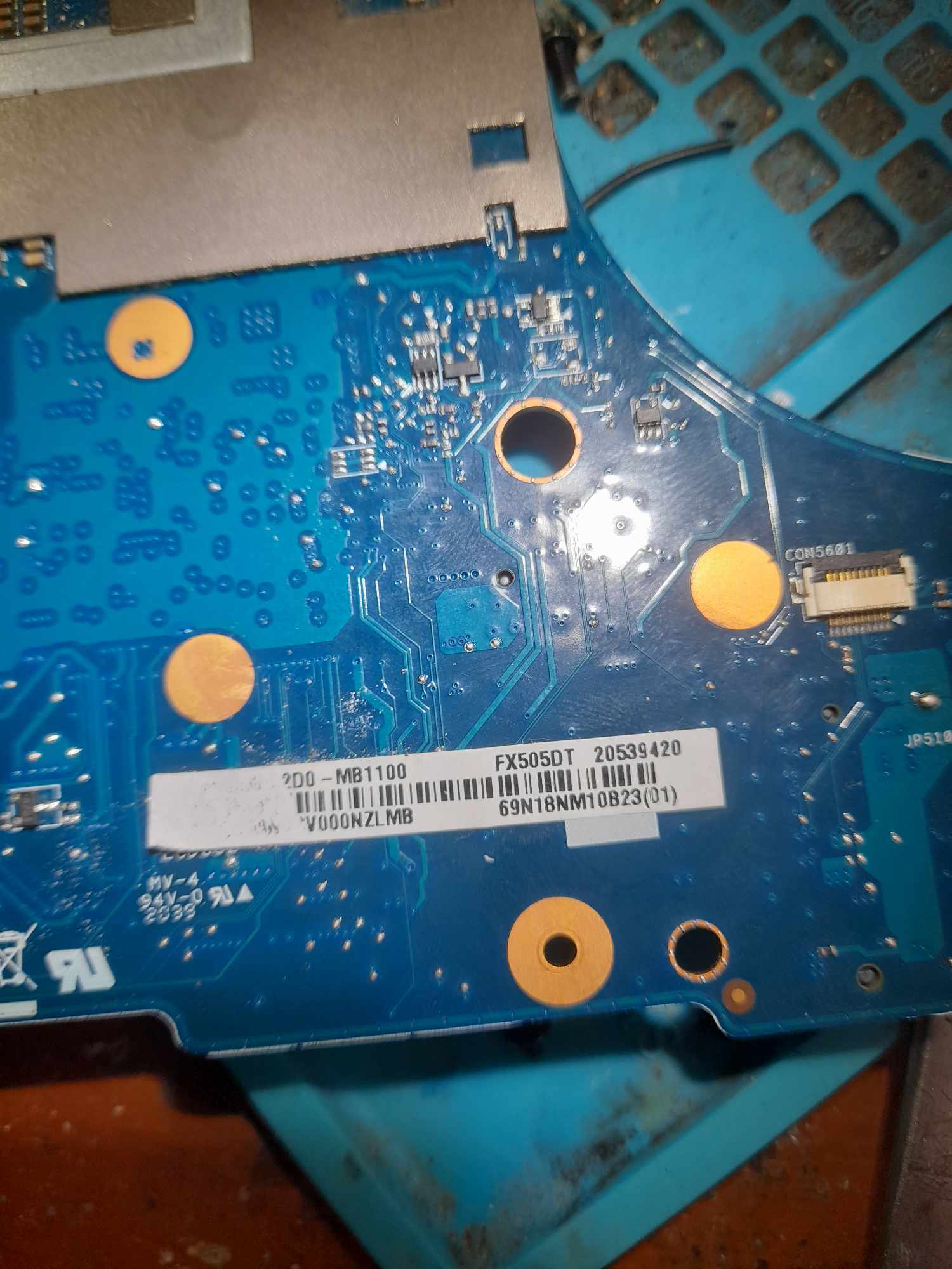

    Find a sticker on the motherboard to identify the right bios.
    Also write your SIO (EC) size.

      Re: Asus FX505DD Rev: 2.0 BIOS
      Here is a photo
      • hardware1
        • Sep 2021
        • 2951
        • N/A
        #43
        Originally posted by ReedZed
        Here is a photo
        Here's your new file, try it and let me know.
        Attach the writing on the EC chip.
