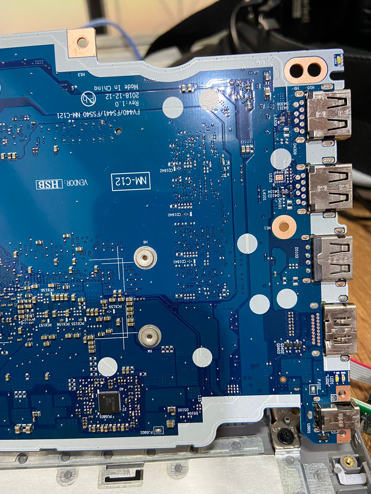

                  • vilich64
                    • Apr 2015
                    • 3
                    • Russia
                    #109
                    Re: lenovo IdeaPad S145 bios needed

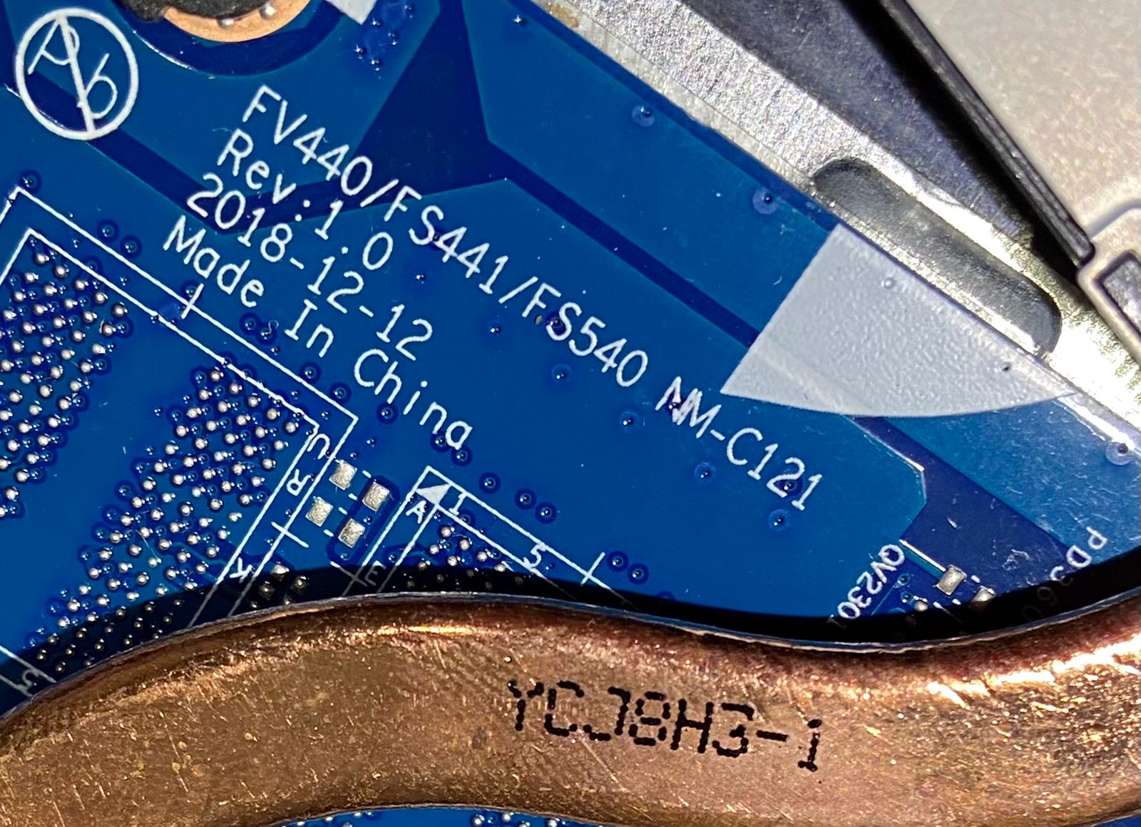

                    mb FV440 / FS441 / FS540 NM-C121
                    rev 1.0
                    Flash power led
                    • hoaca388
                      Badcaps
                      • Jan 2022
                      • 12339
                      #110
                      rev 1.0
                      Flash power led
                      your serial number ?
                      • vilich64
                        • Apr 2015
                        • 3
                        • Russia

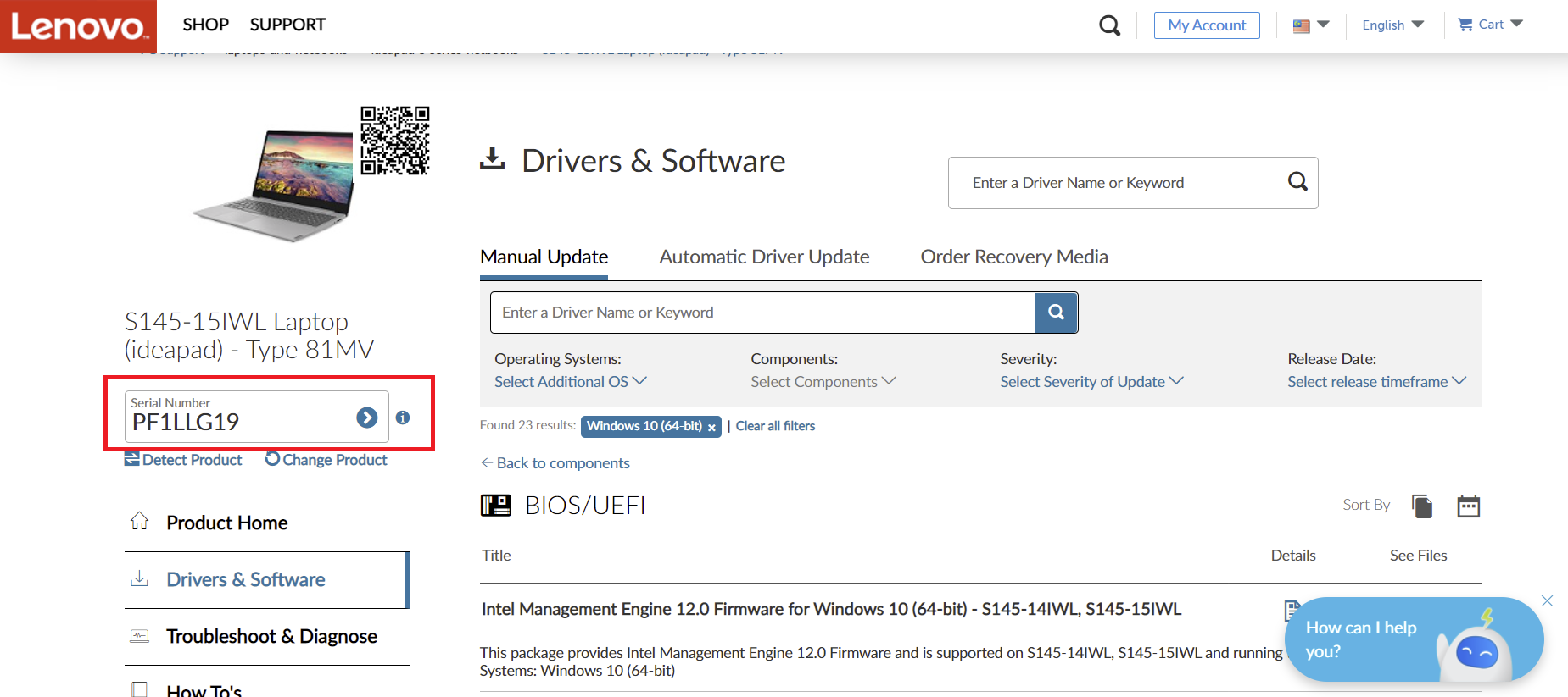

                        #111
                        Pf1llg19
                        • hoaca388
                          Badcaps
                          • Jan 2022
                          • 12339
                          #112
                          Pf1llg19
                          Don't rush to flash the bios file I posted as it doesn't have DMI info yet. Where is your original bios file? The original bios is required to transfer the DMI information to the new file or else you have to do the next steps yourself, it will be more complicated.
                          • vilich64
                            • Apr 2015
                            • 3
                            • Russia
                            #113
                            They tried to fix it before me, I counted this bios from the chip. But I'm not sure it's native. Maybe they flashed it before me.
                            • hoaca388
                              Badcaps
                              • Jan 2022
                              • 12339
                              #114
                              Ok, maybe you have to add the DMI info after flashing.

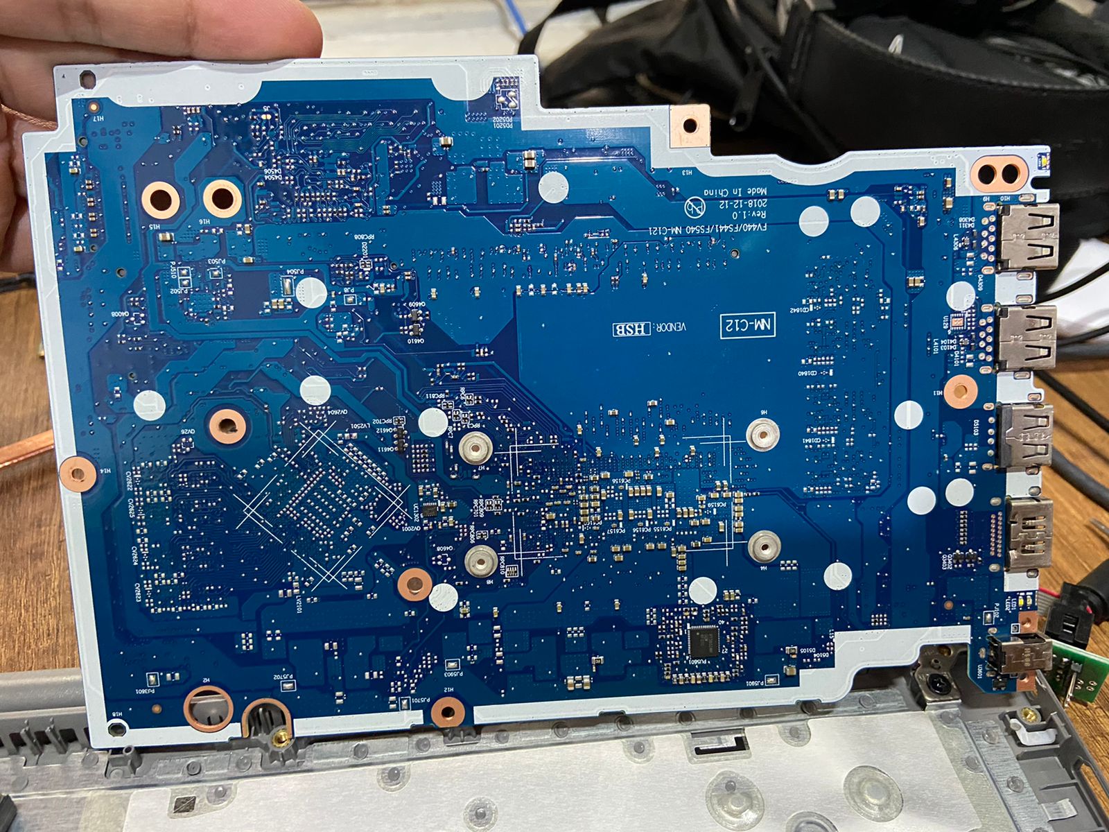

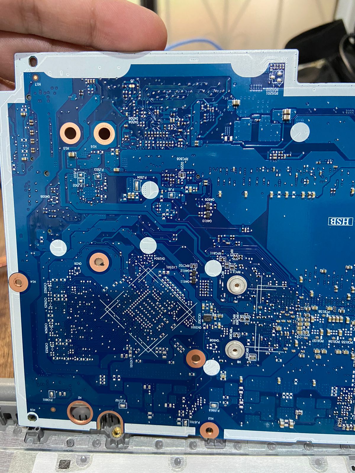

                                Hello friends, I really need your help, I have a lenovo S145 15IWL Model Name: 81S9 S/N: PE05CF7M board NM-C121 2018 12-12 that is flashing the power light, but no image on the screen or external monitor, I believe it's bios.
                                Could you create a fresh bios extracted directly from the lenovo website with the DMI data entered? The original bios has probably already been replaced with a new one without work.
                                P/s: But how ONBOARD RAM memories were possibly removed (I acquired the model like this, is there a way to ignore them via bios or only via hardware change?
                                Thankyou so much for help and sorry for my terrible english.

                                  #116
                                  With your model it is possible to extract a nearly complete bios file from the Lenovo homepage (the file has no DMI information). DMI must be taken from the original bios ( it is encrypted ) . Just upload the bios available in your device here.

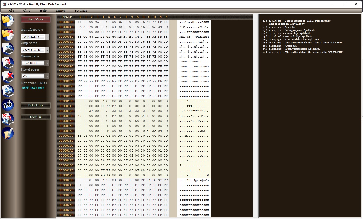

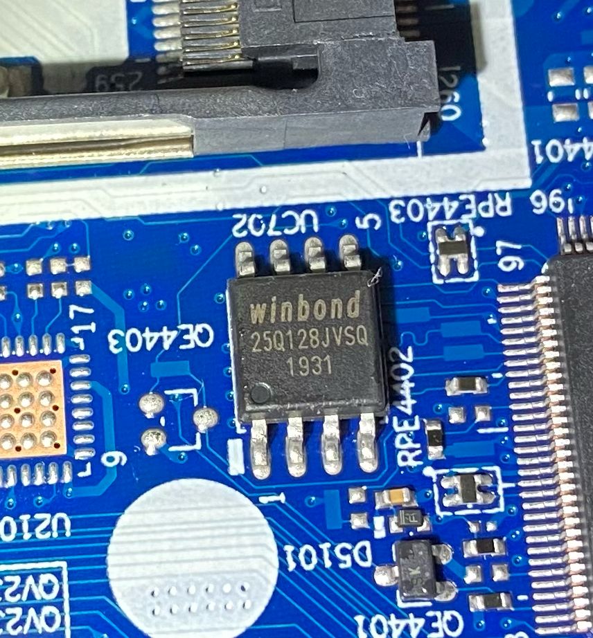

                                    Hi Friend, is this my original bios
                                    • hoaca388
                                      Badcaps
                                      • Jan 2022
                                      • 12339
                                      #118
                                      The backup file is not good, it is full of FF characters, this error is from your programming device, be careful with it.

                                        #119
                                        Sorry friend, I'm new to bios, this is my second backup
                                        • hoaca388
                                          Badcaps
                                          • Jan 2022
                                          • 12339
                                          #120
                                          S145-15IWL Laptop (ideapad) - Type 81S9
