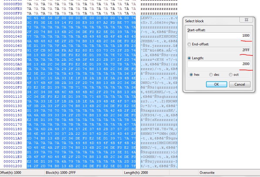

      Virgin bios extracted from BUCN29WW.exe
      DMI off-sets in attached picture.
      Supported:
      S145-14API/XiaoXin-14API QC 2019/IdeaPad S145-15API /IdeaPad 340C-15API/IdeaPad S145-15API

        Re: lenovo IdeaPad S145 bios needed
        Thanks a lot. Can anyone please explain the what DMI offset means?
        Can I just burn the ROM chip with the downloaded image ?

              Use the bios at post #46 .If you can use a hex editor copy your DMI from your backup to the virgin bios,using the off-sets that @peste has given.If you don`t know how to do it say so and someone will do it for you

                          #72
                          Originally posted by than_22
                          s145-15ikb
                          board code GS44B/GS54B NM-C561
                          bios extracted from the Lenovo site update
                          DMI 234000 - 235FFF

                            #73
                            DMI 234000 - 235FFF
                            thank you sir,, file is tested,,GODbless you

                                    #77
                                    Originally posted by vanjo1991
                                    hi Peste,
                                    pls help me my laptop is blinking power botton, i suspect its bios..
                                    fs440fs541 nm-c111 rev 1.0
                                    lenovo s145 14igm
                                    this is my backup bios bin
                                    thank you in advance
                                    S145-14IGM,S145-15IGM
                                    DMI 483000 - 484FFF
