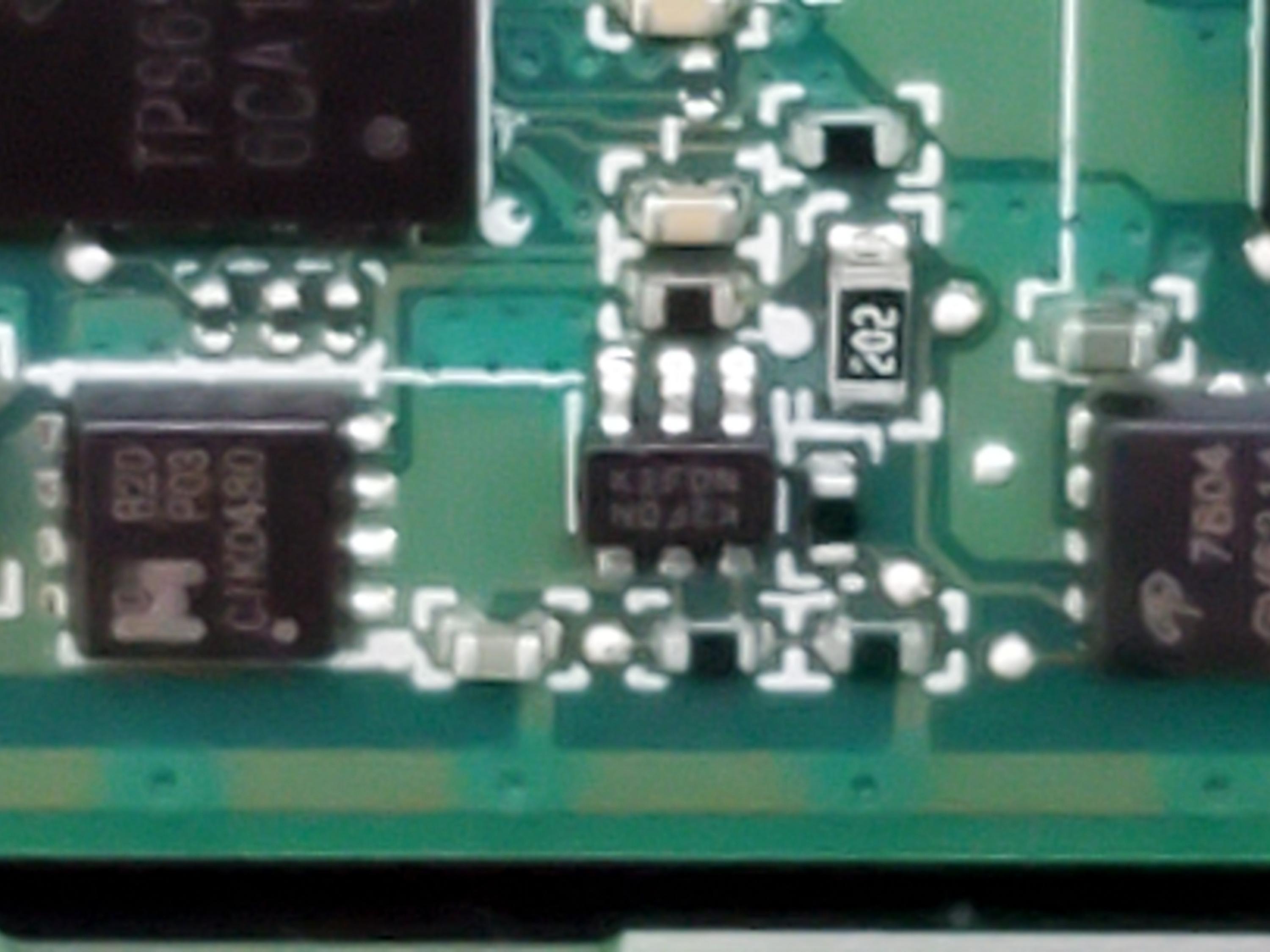

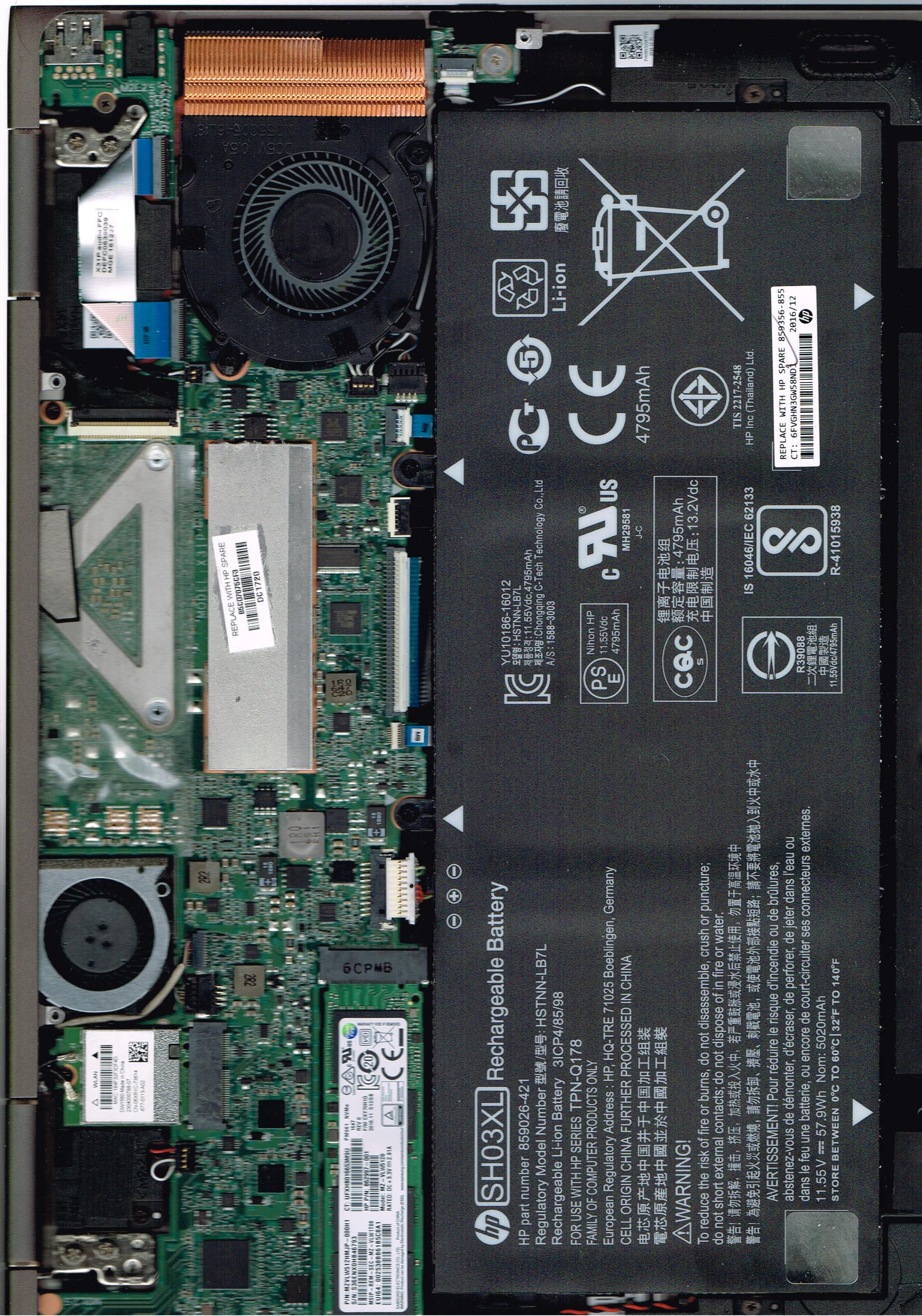

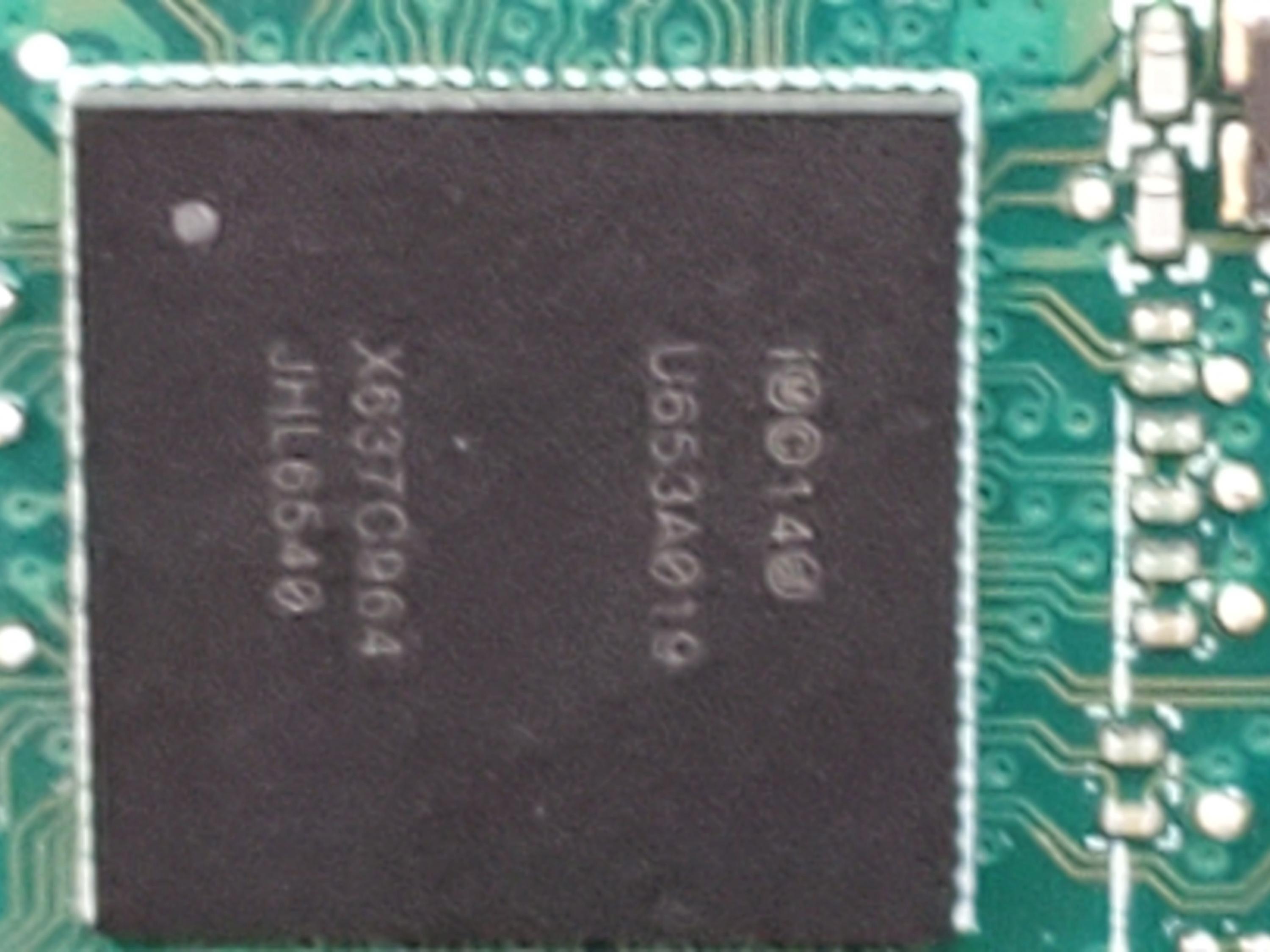

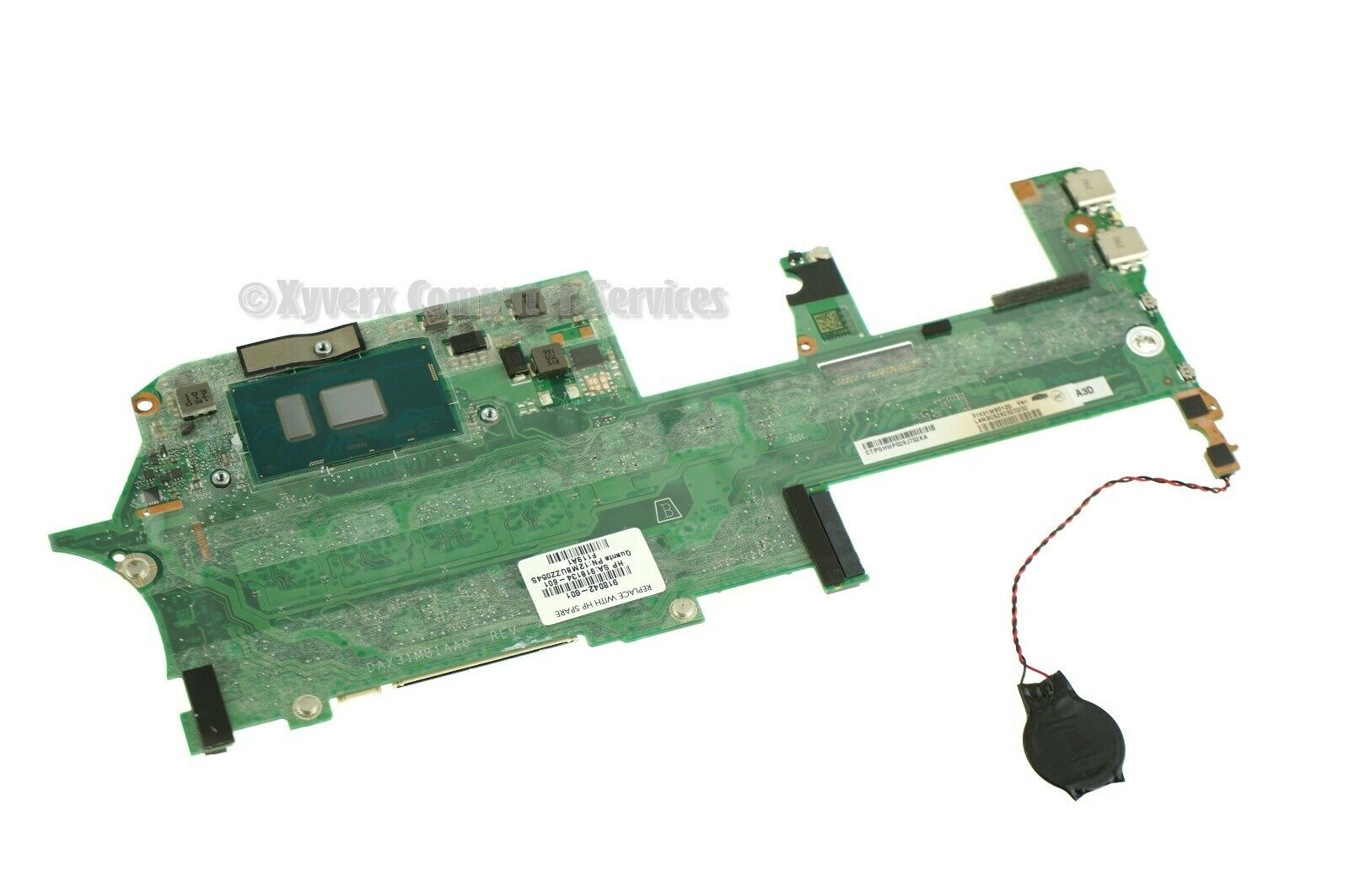

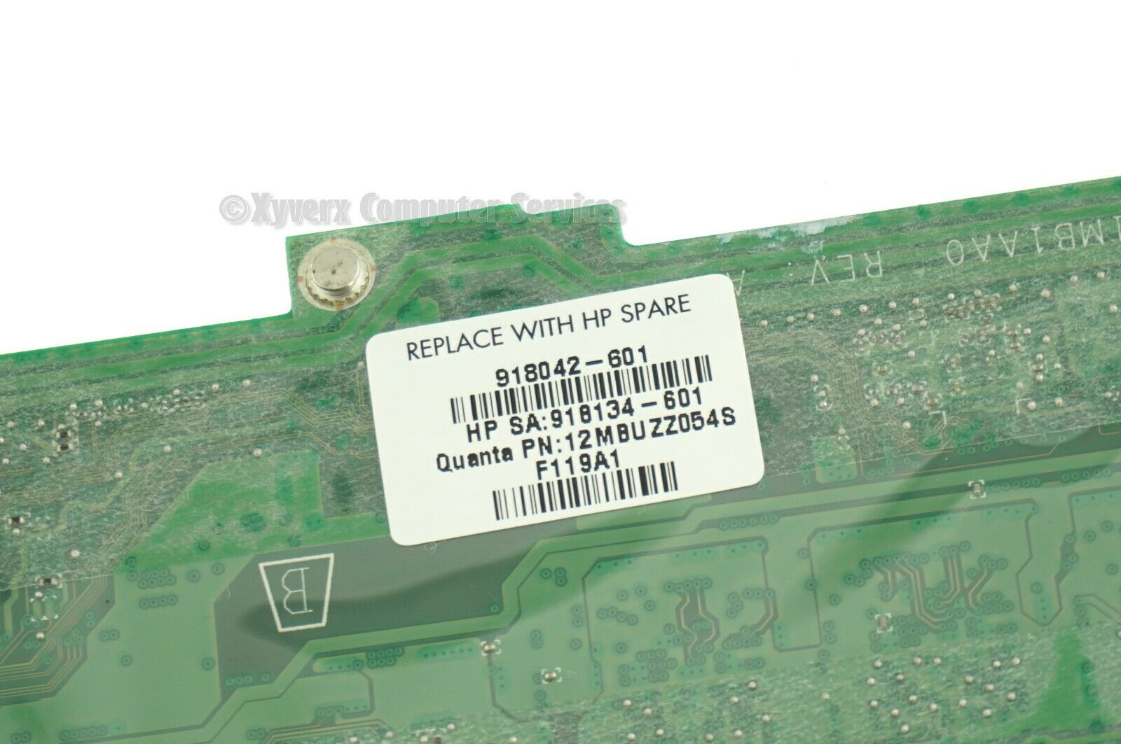

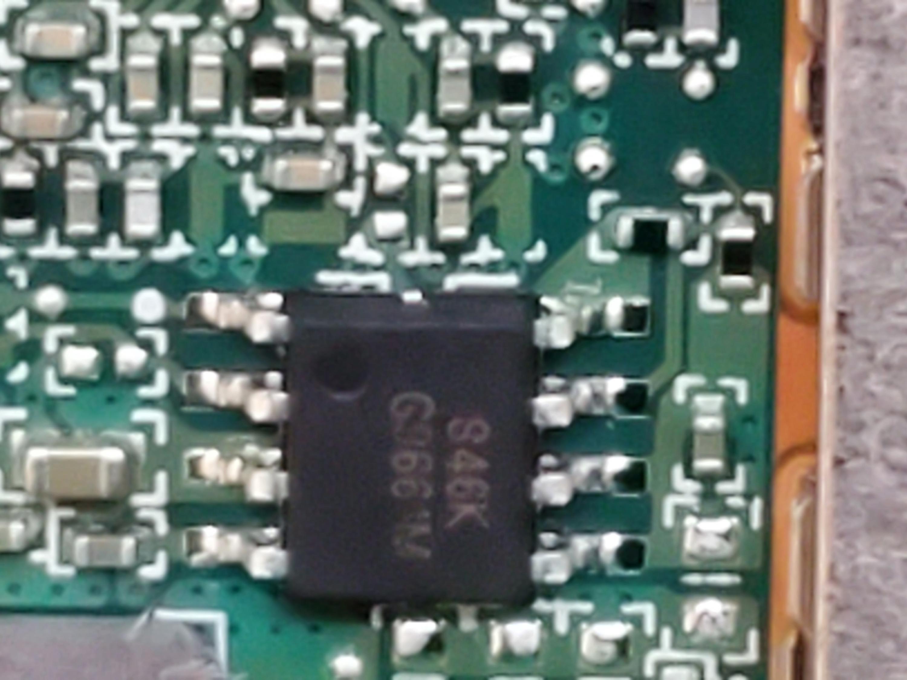

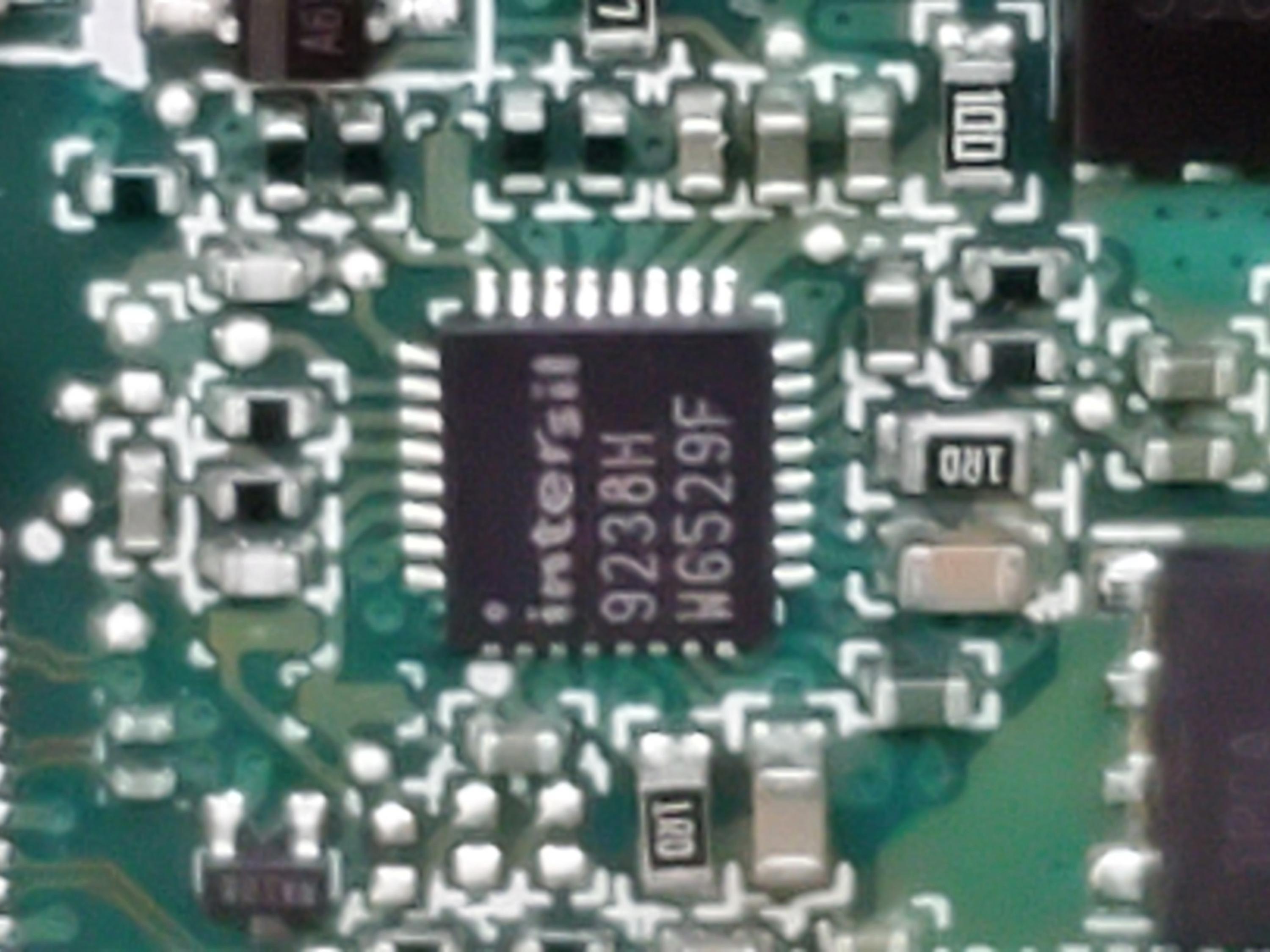

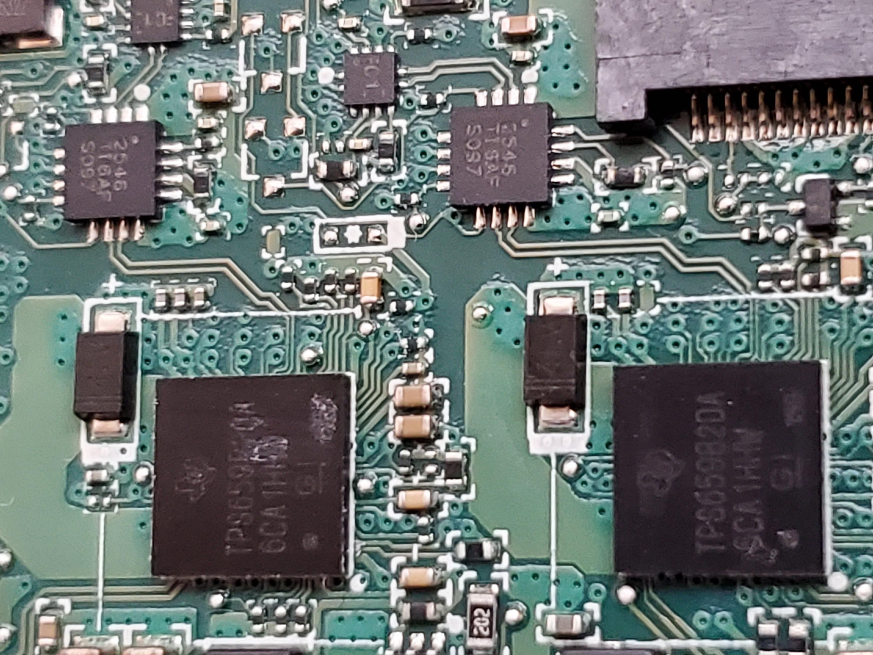

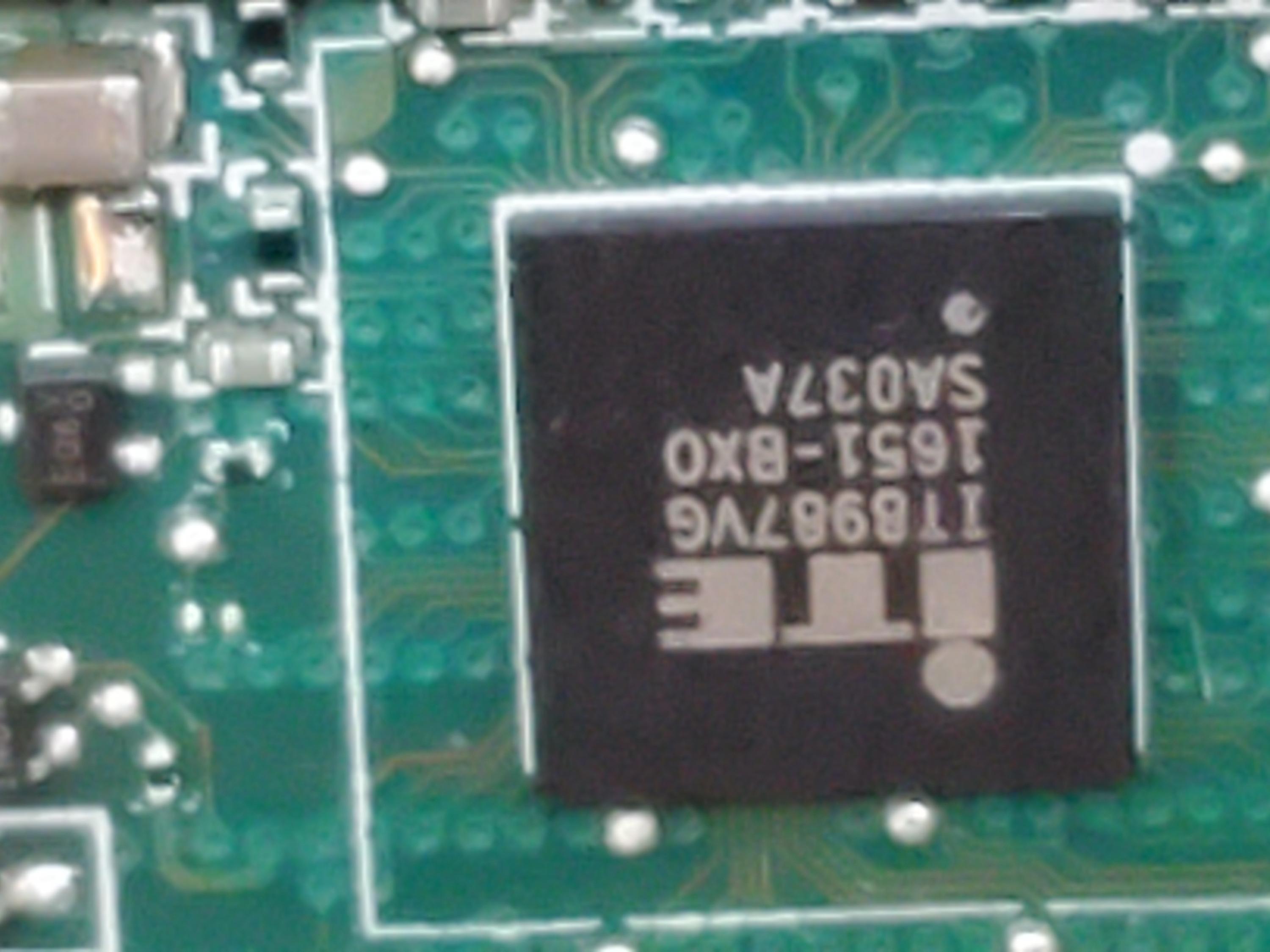

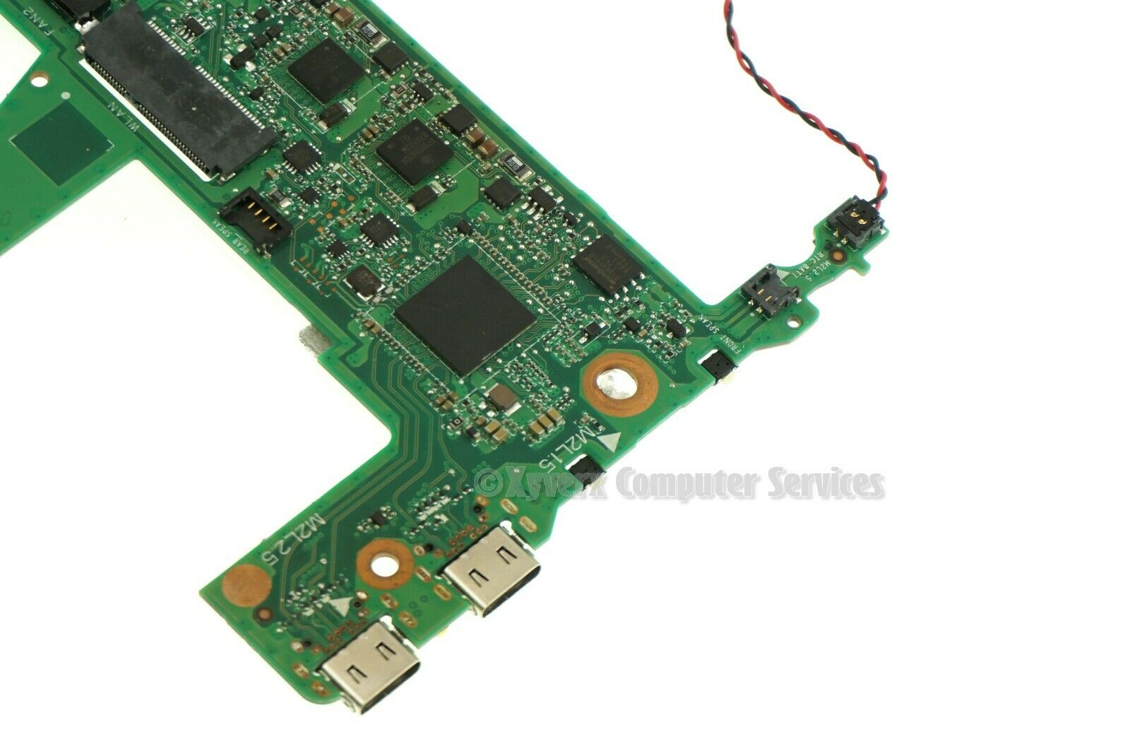

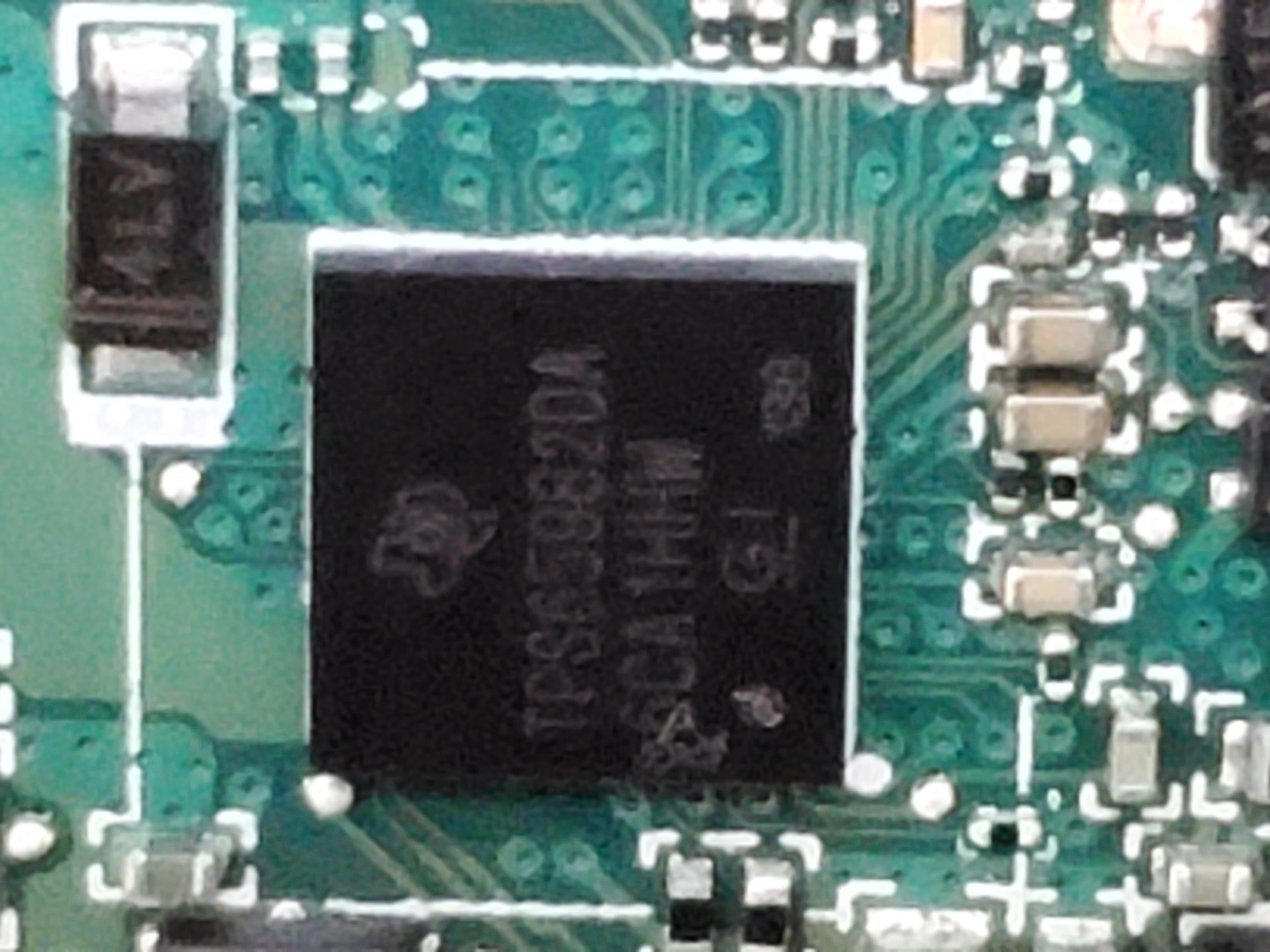

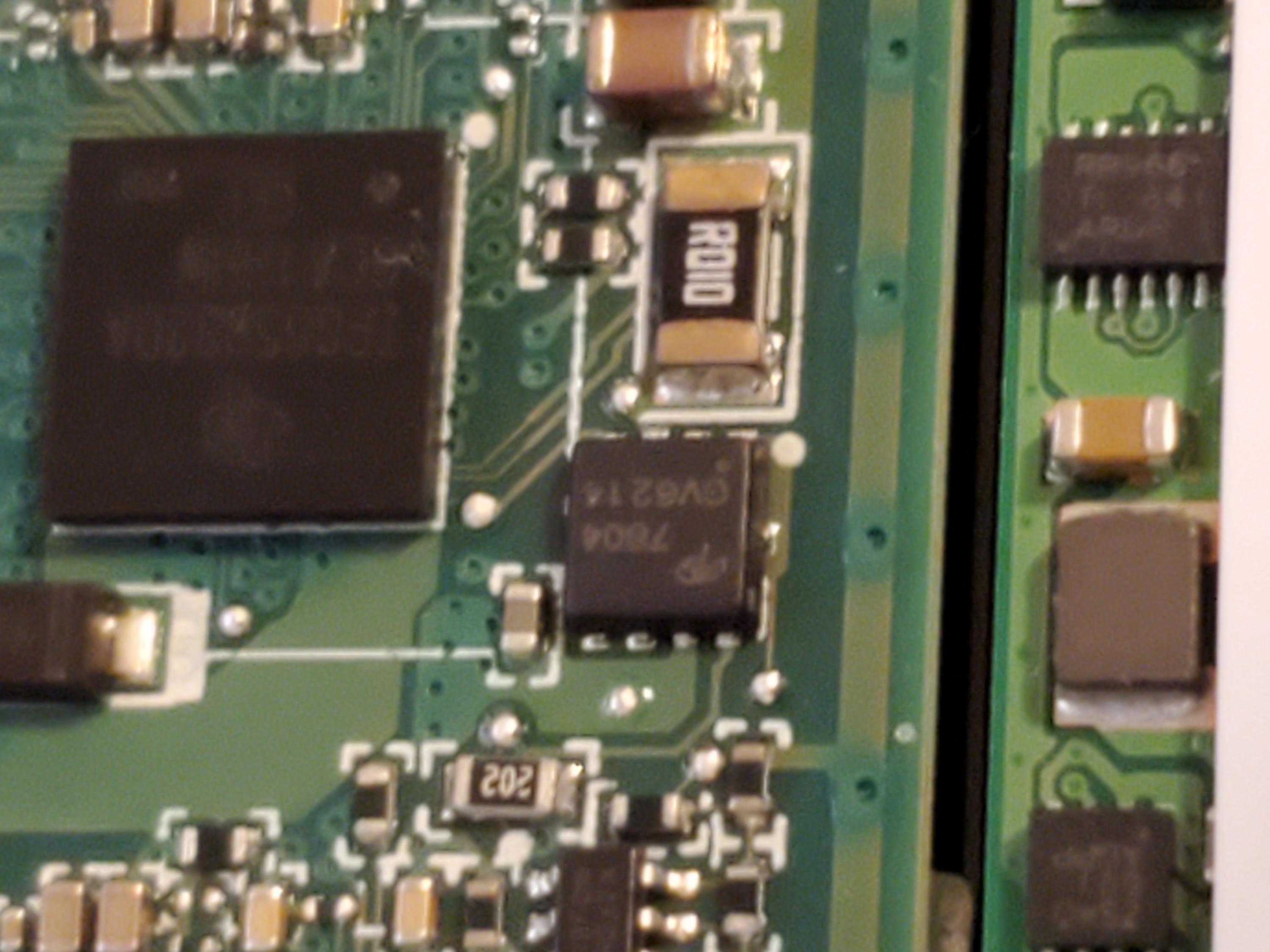

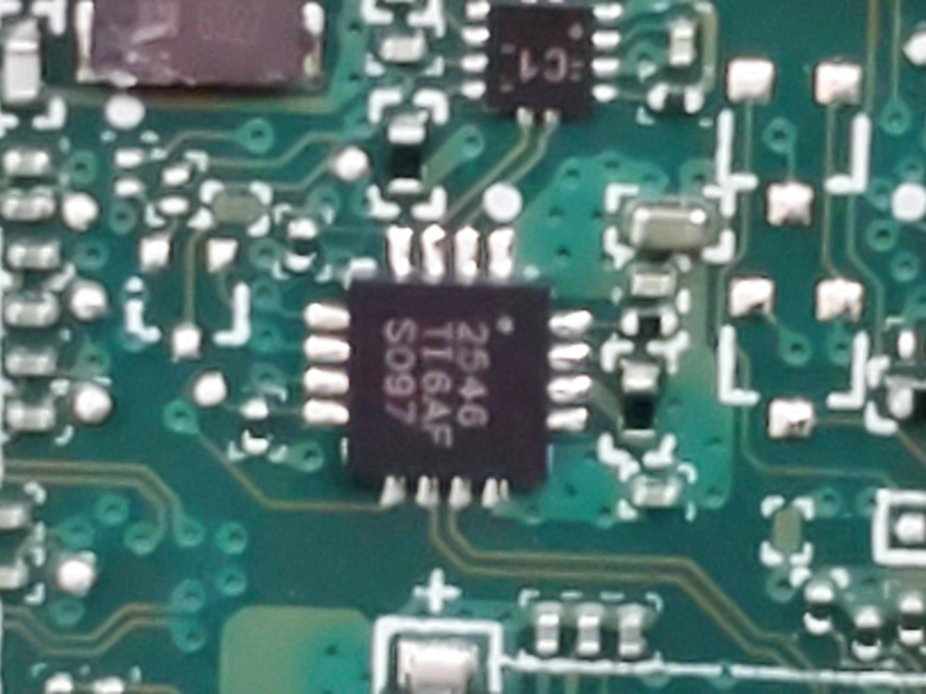

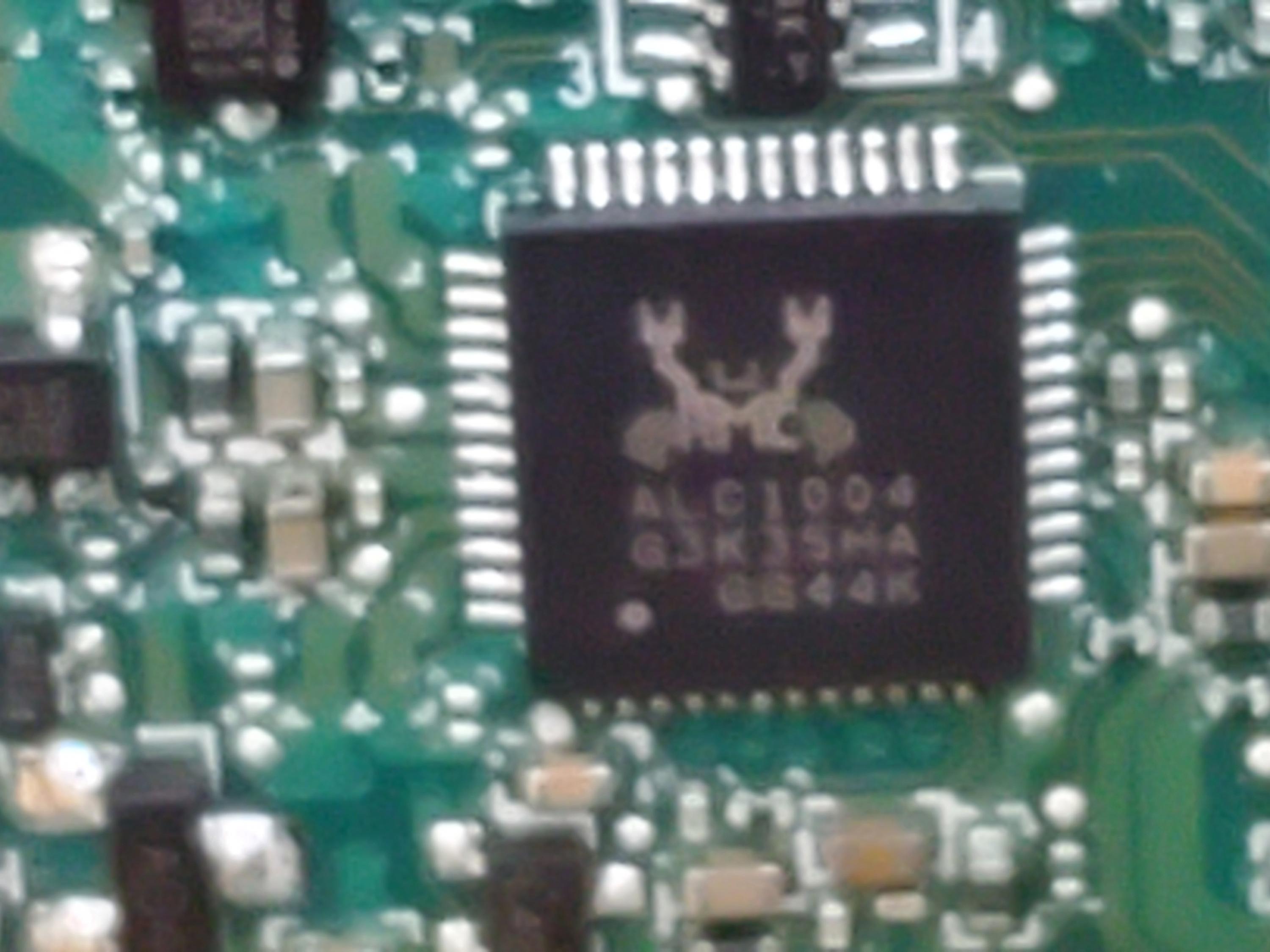

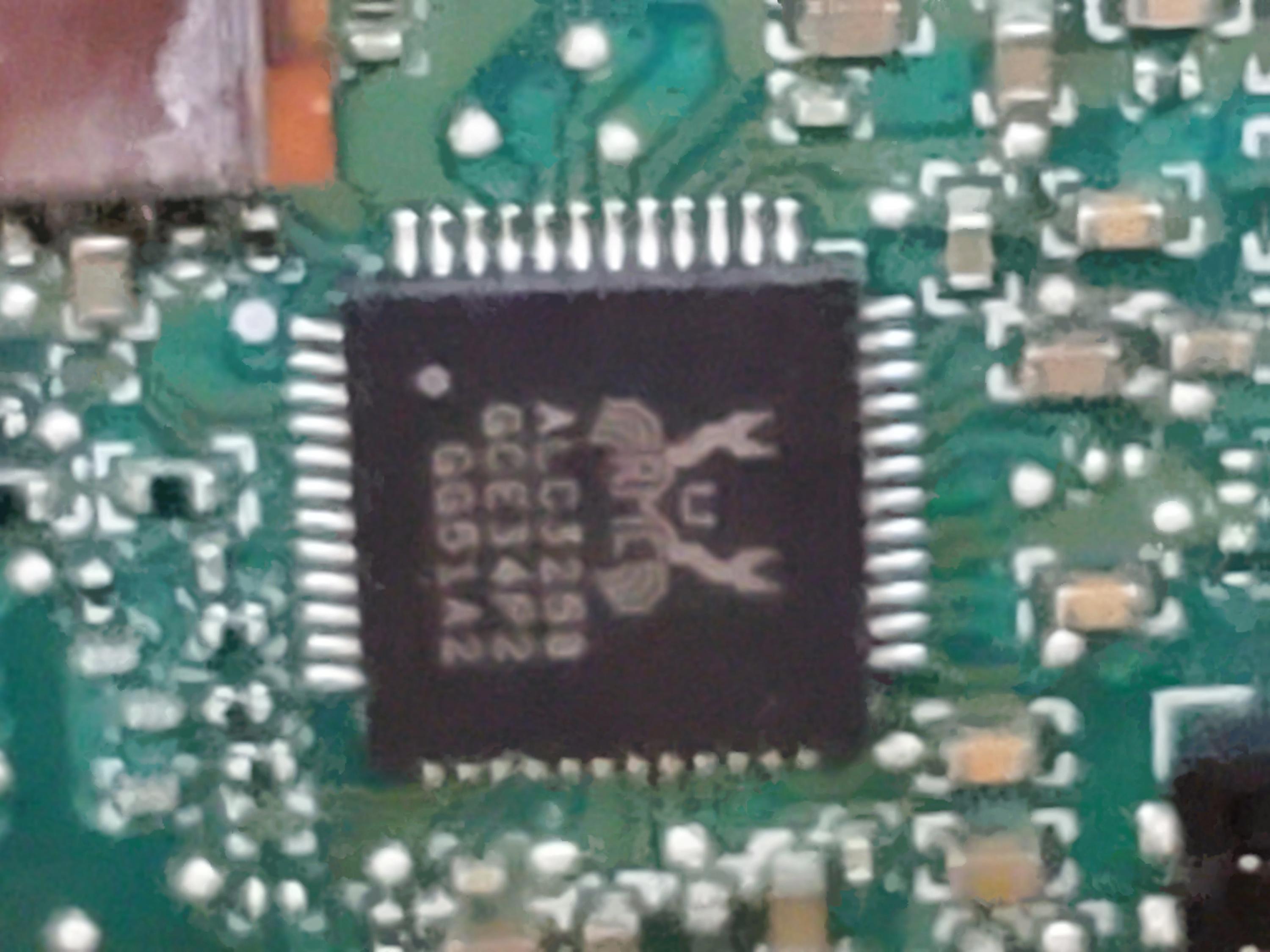

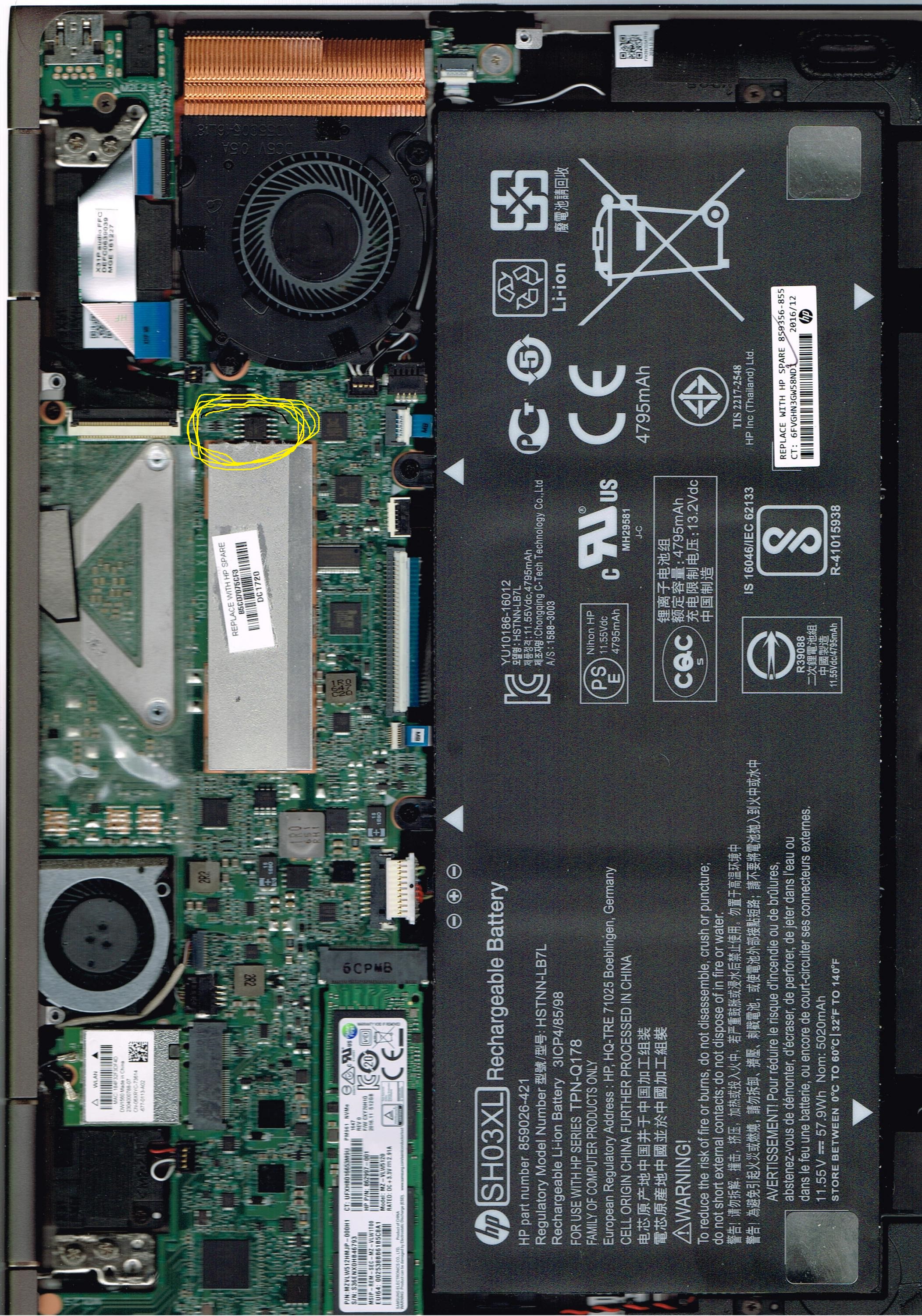

      I don't recall creating an HP SpareKey USB stick for that purpose. I don't have one. When you say the largest bios chip, which chip would that be ? I've taken photos of what I thought are the relevant chips, but when doing some research, the "Winbond 25Q80DVIG" comes up as being the BIOS chip.
      I've attached some photos to give you an idea. If you want me to take more photos of different chips, I can certainly do that.
      I'd really appreciate your advice.

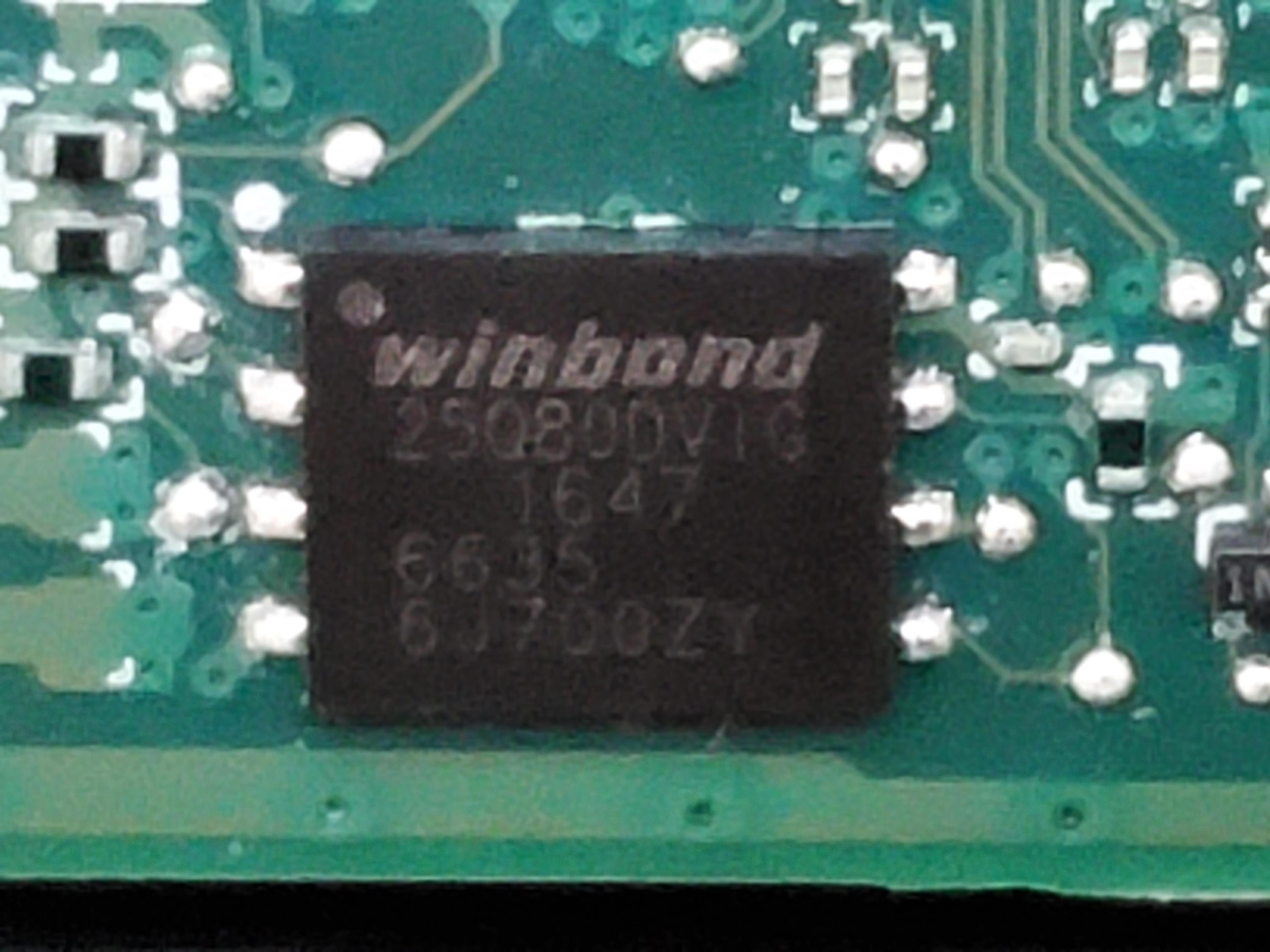

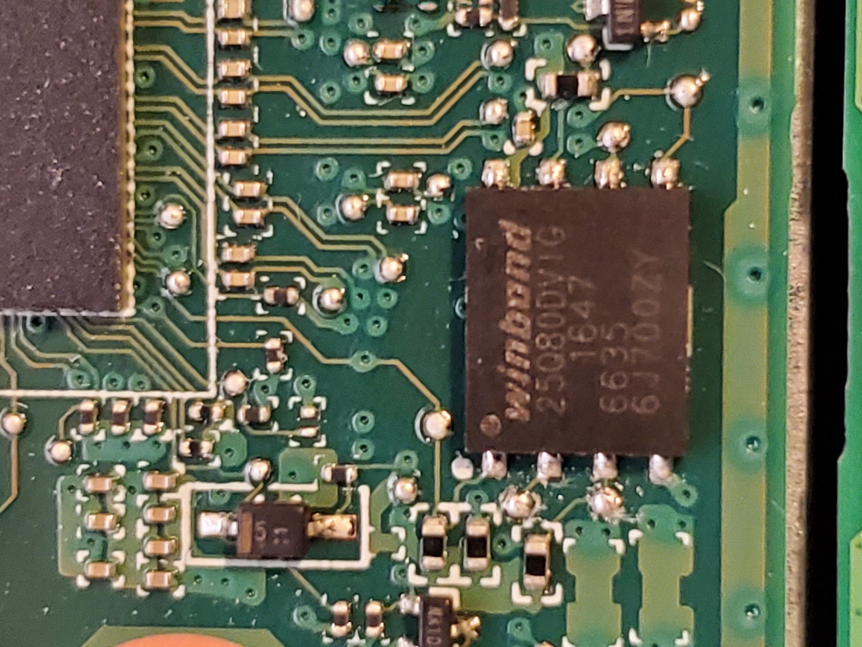

        Re: HP SpareKey issue with my HP Spectre x360
        Spectre x360 DAX31MB1AA0 the bios is 8MB /8M-byte
        W25Q80DV: 8M-bit/1M-byte
        I can`t show you the bios location on the pictures but look for one with 64 in the name

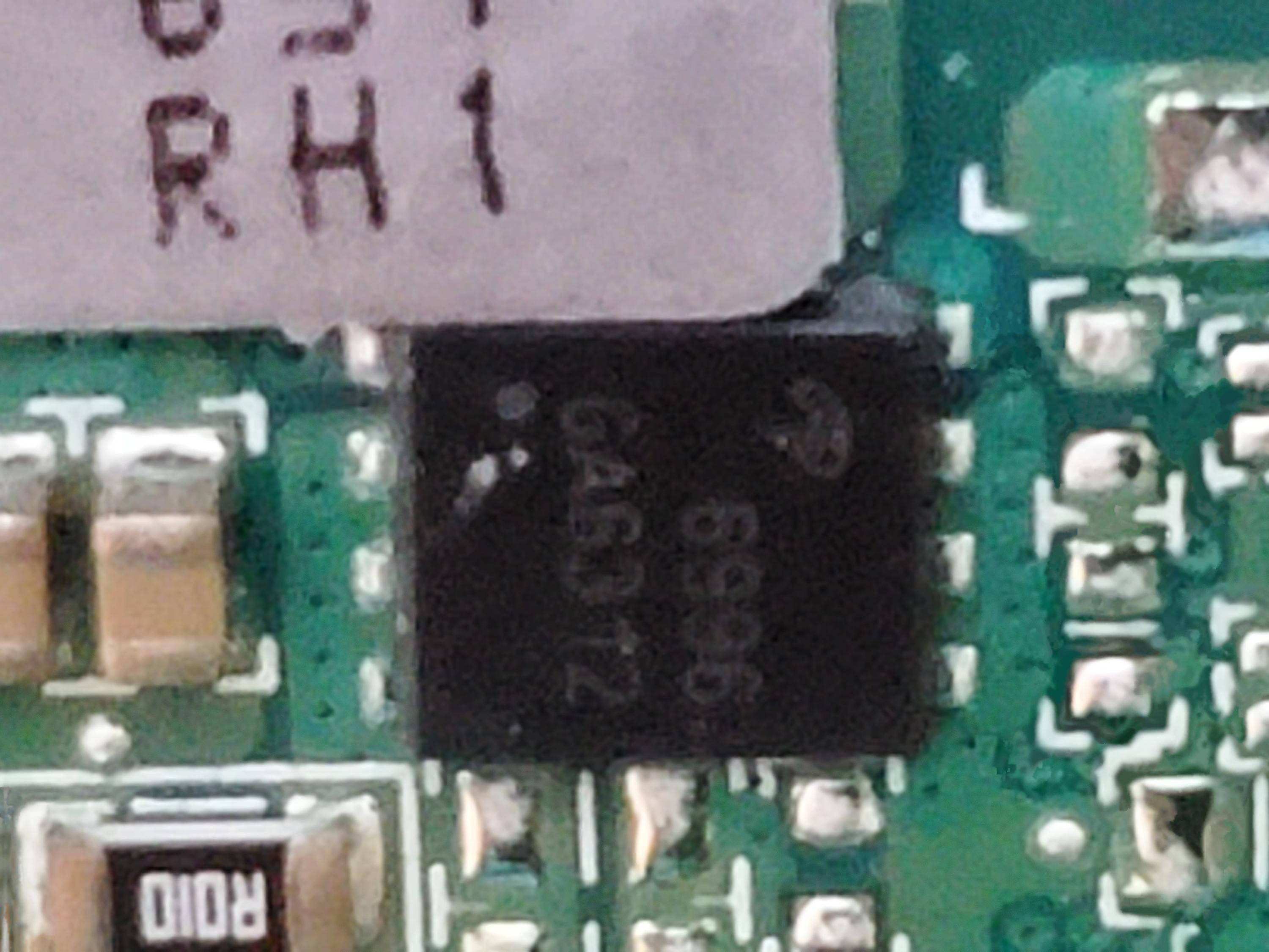

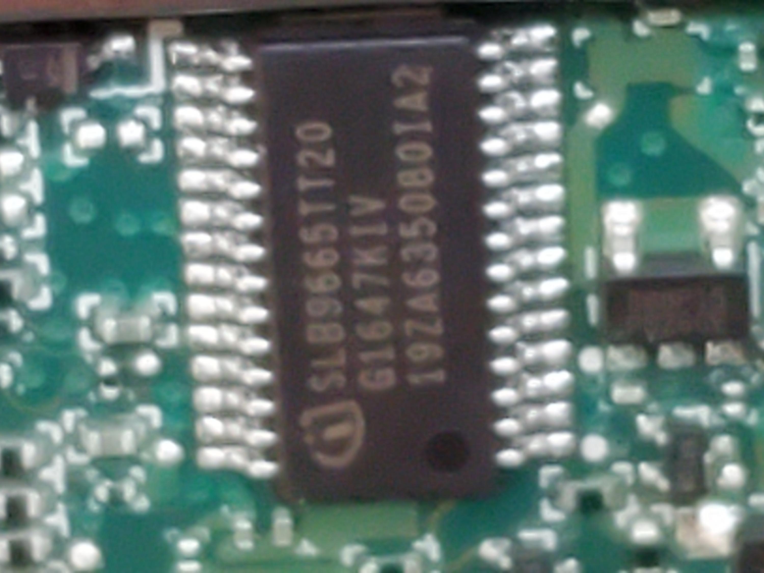

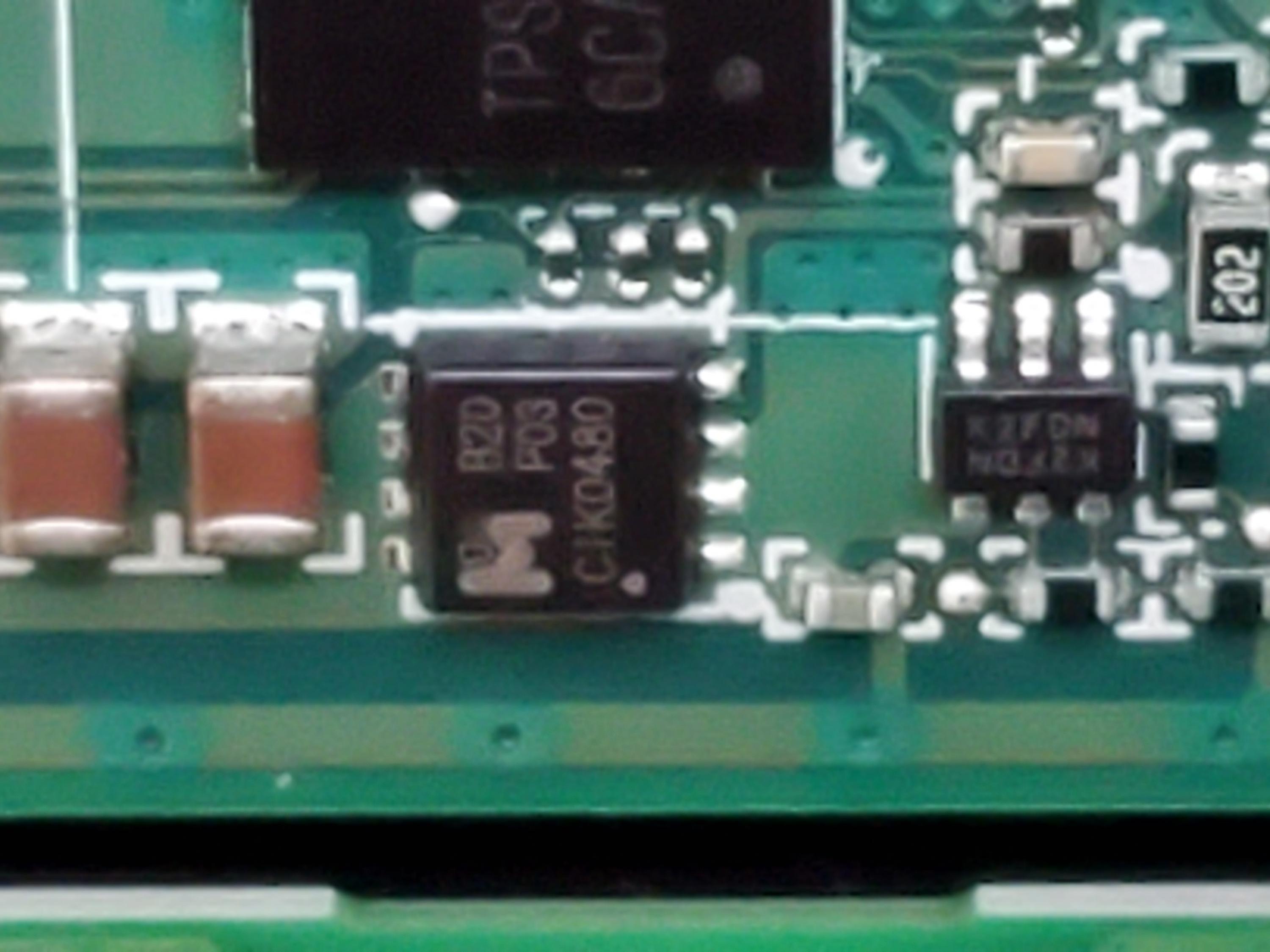

          I did check my bother board again, and this is the only chip that shows that kind of number. I even scanned my motherboard and attached it for reference. Unfortunately most of the numbers on the chips are unreadable. But I'll follow up with some Hi Res shots of all the chips on it hoping it would help.

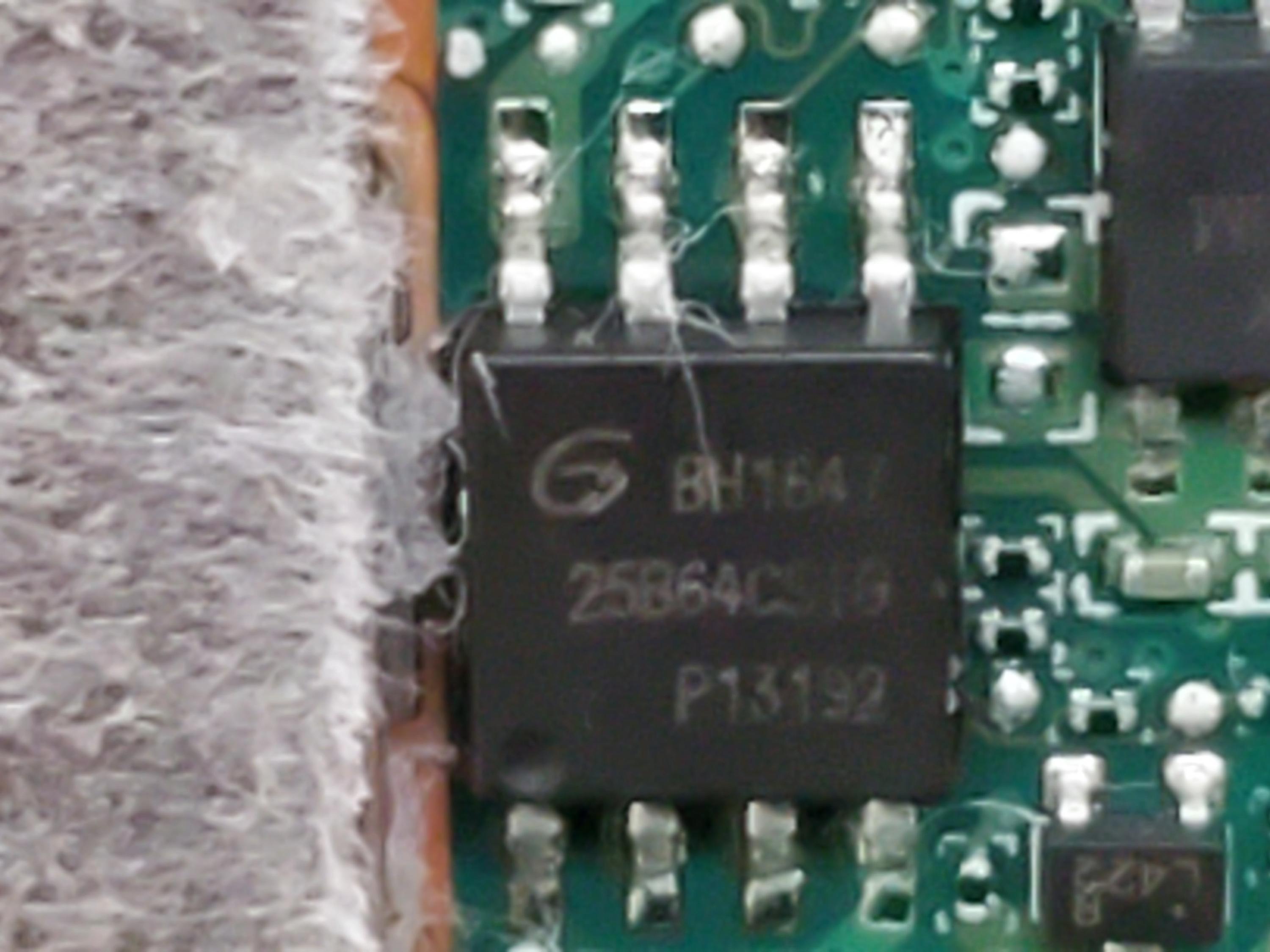

            • 21606

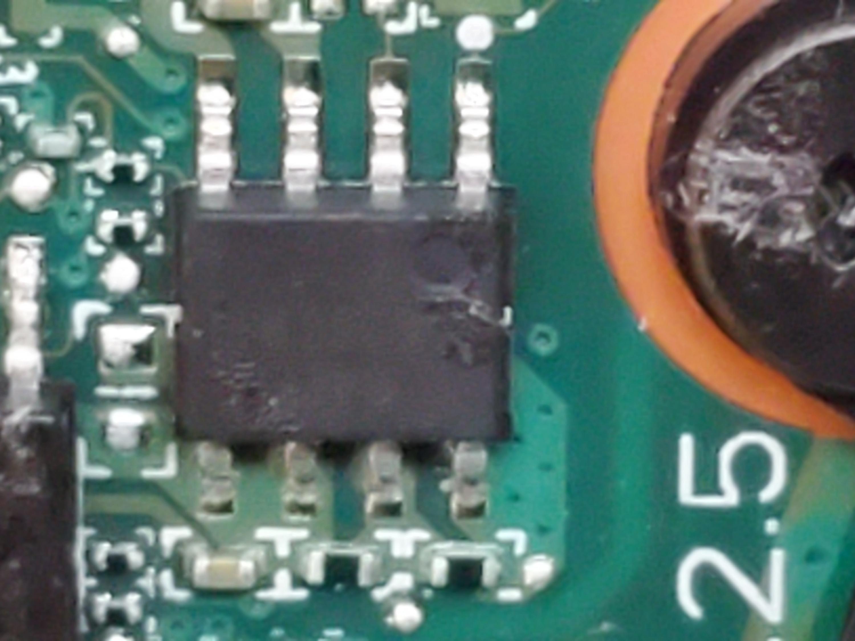

            Can you see the part number on the chip in the yellow circle

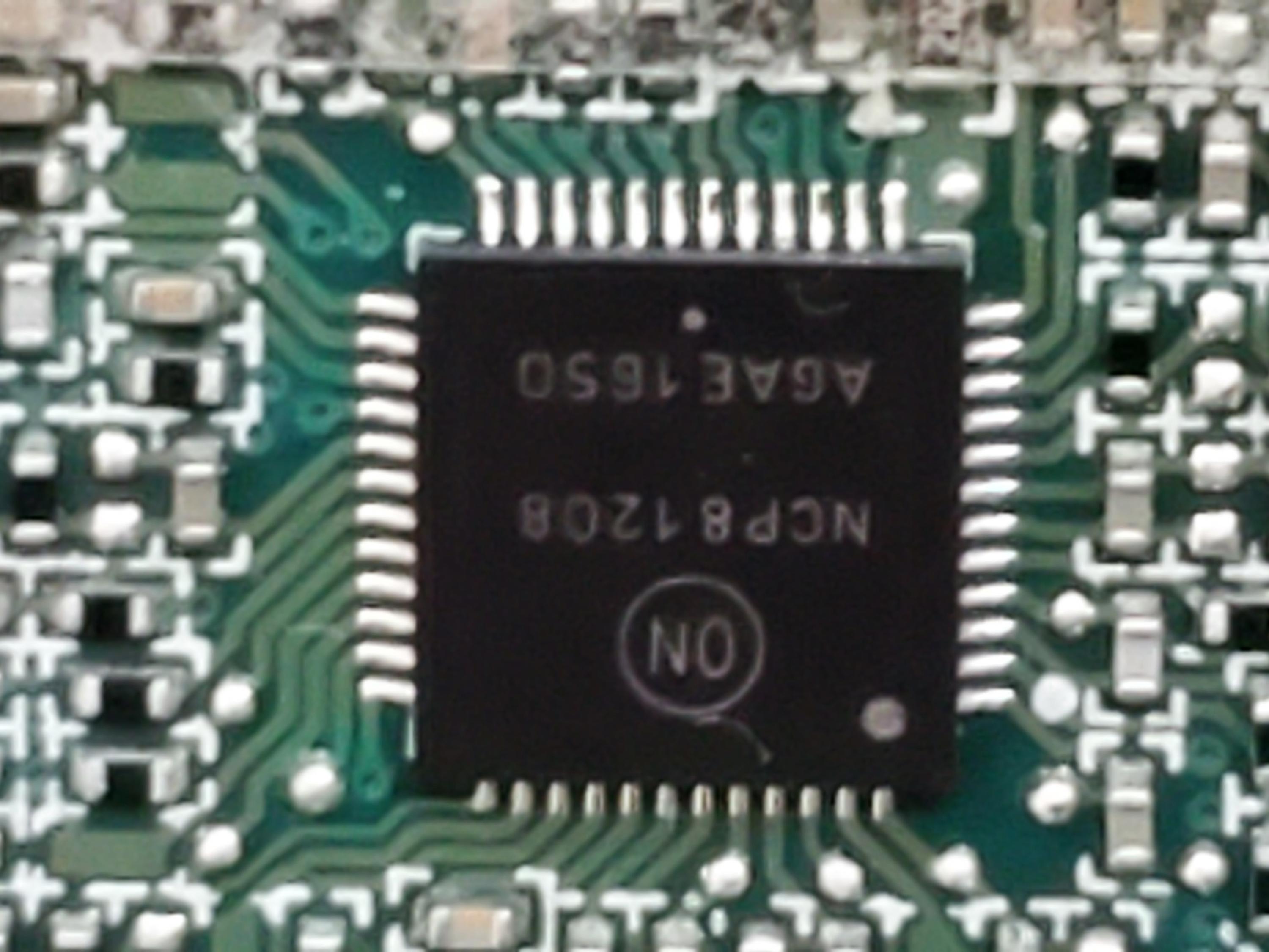

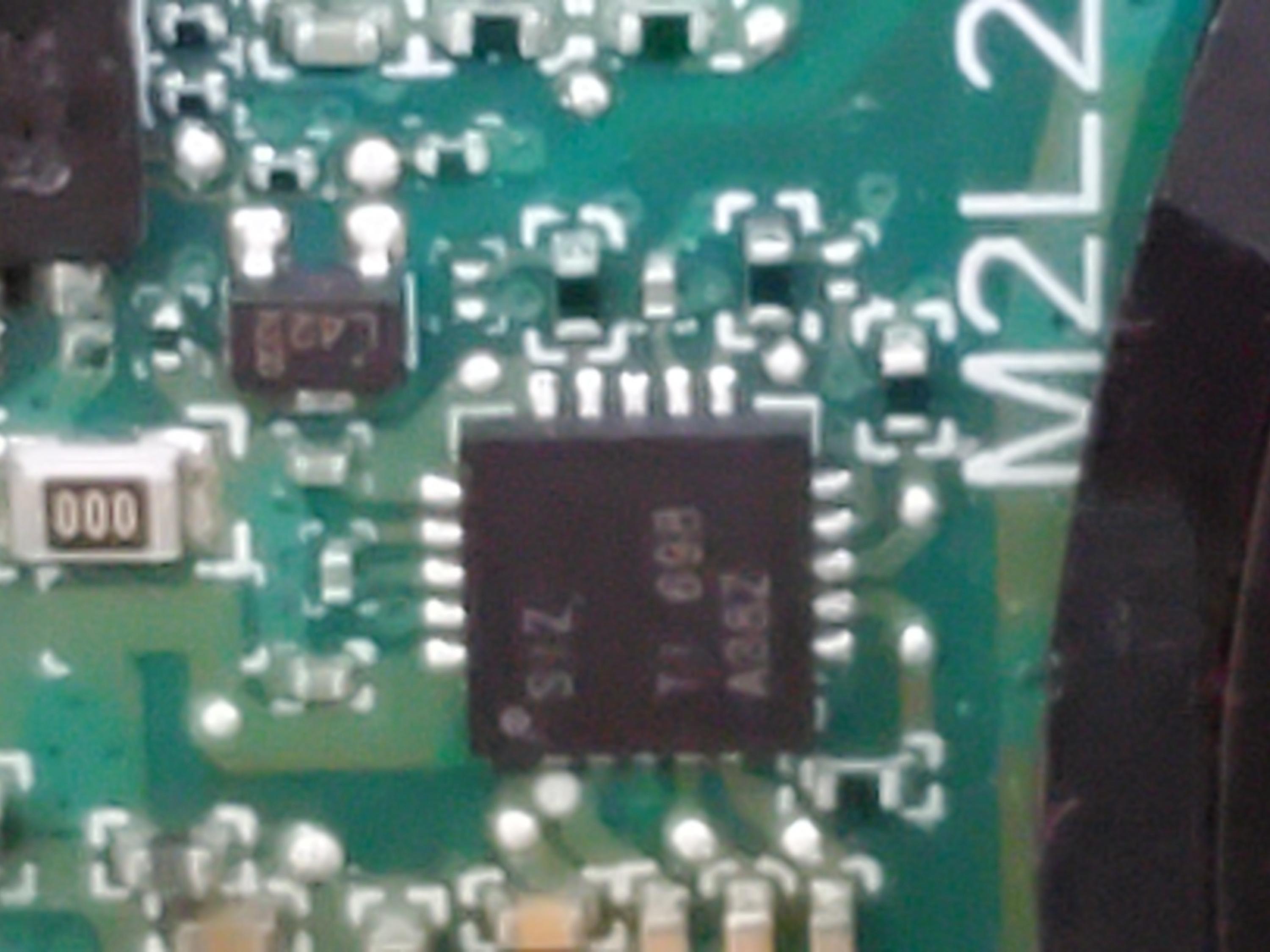

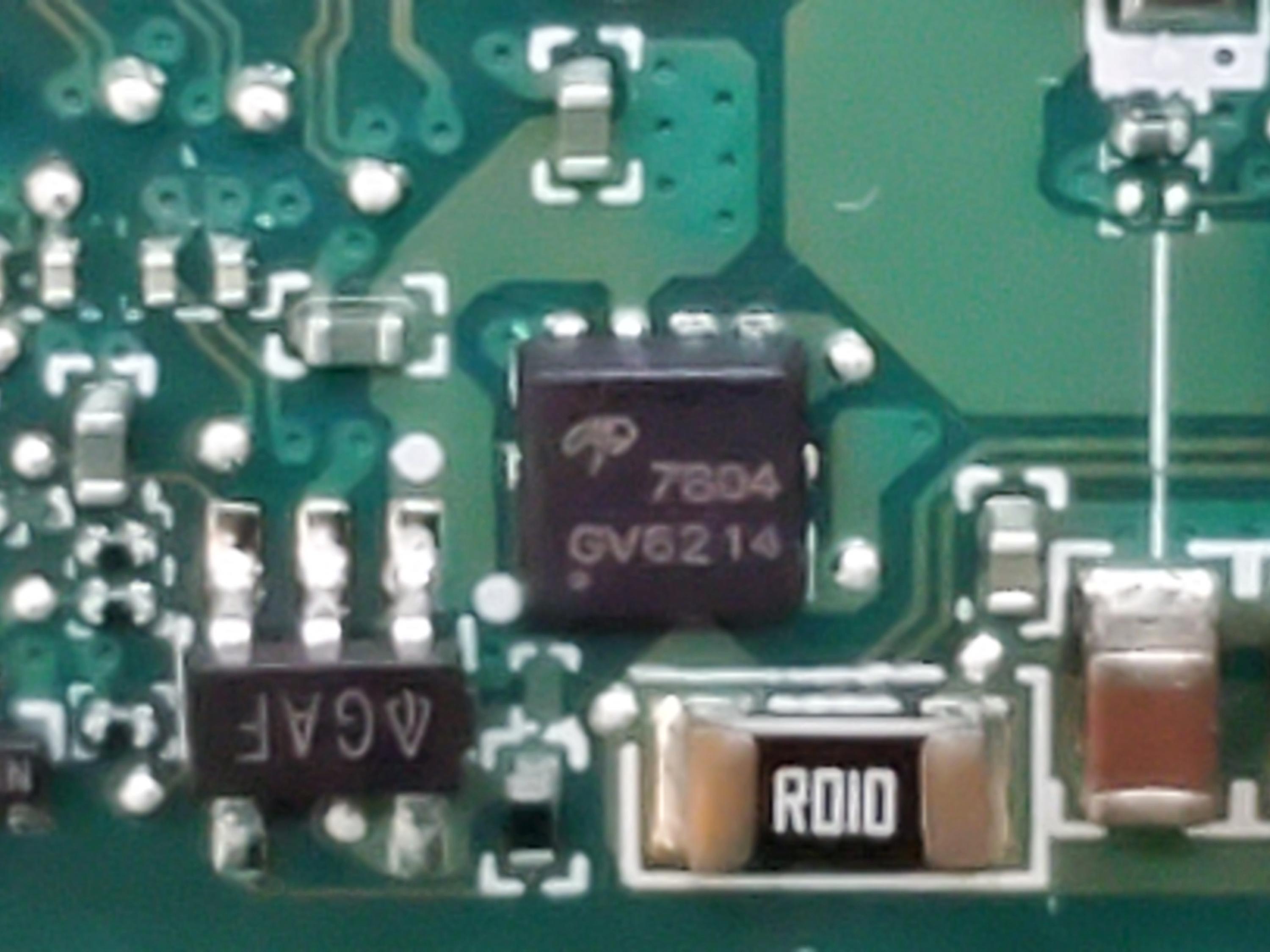

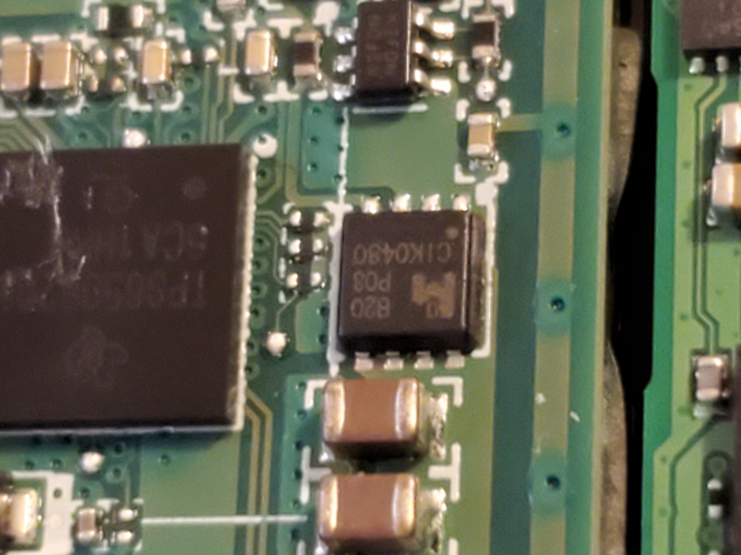

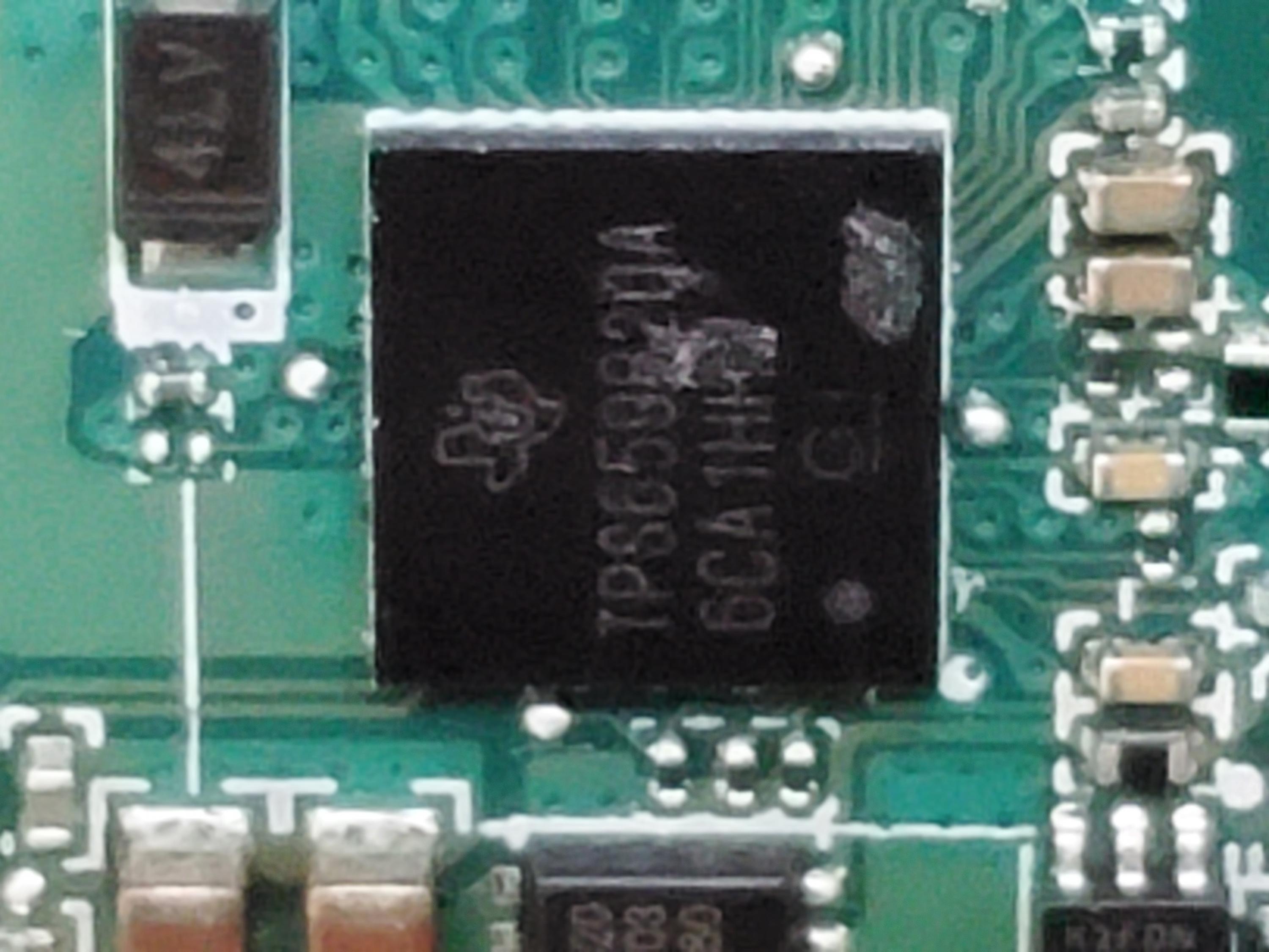

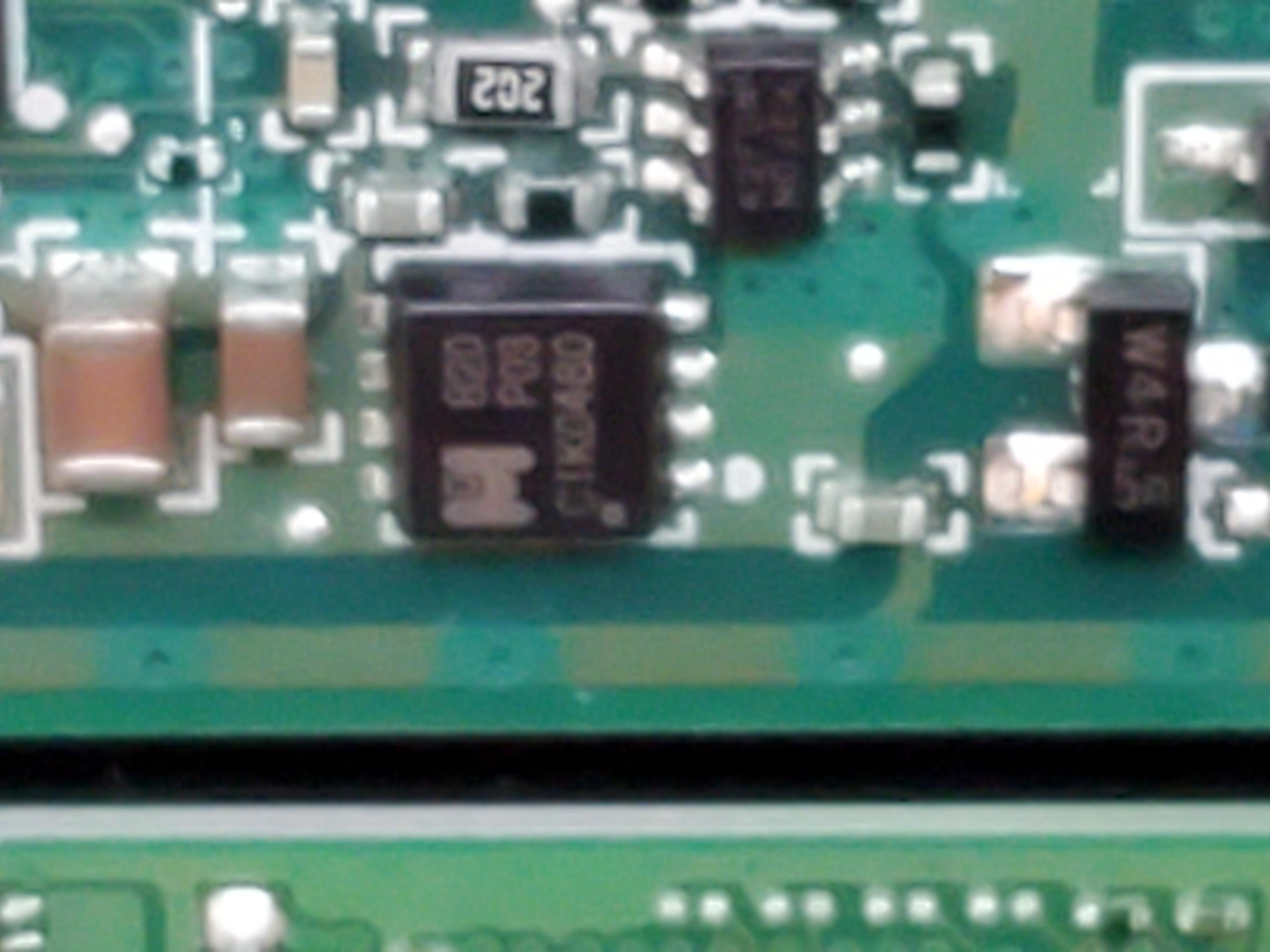

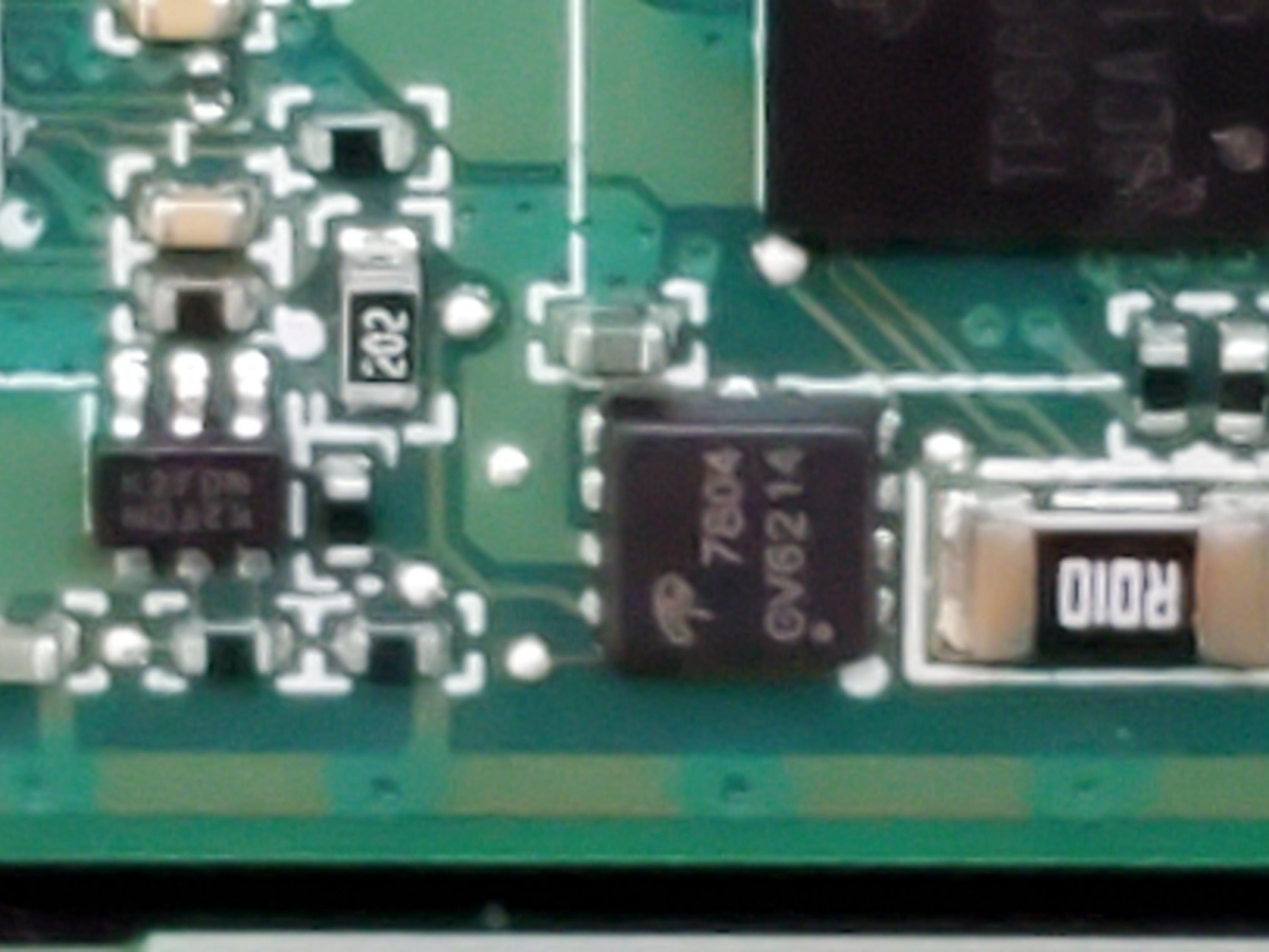

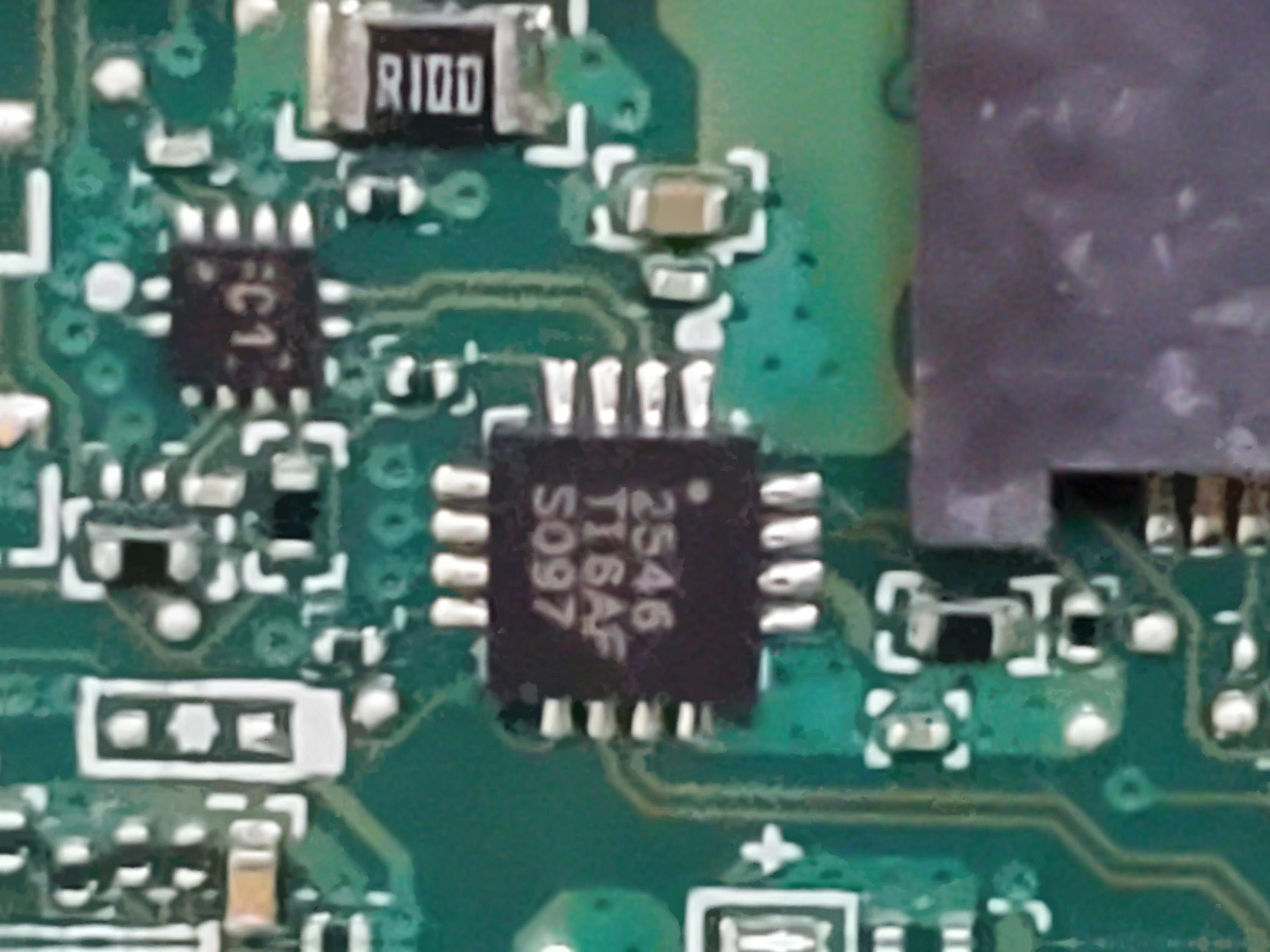

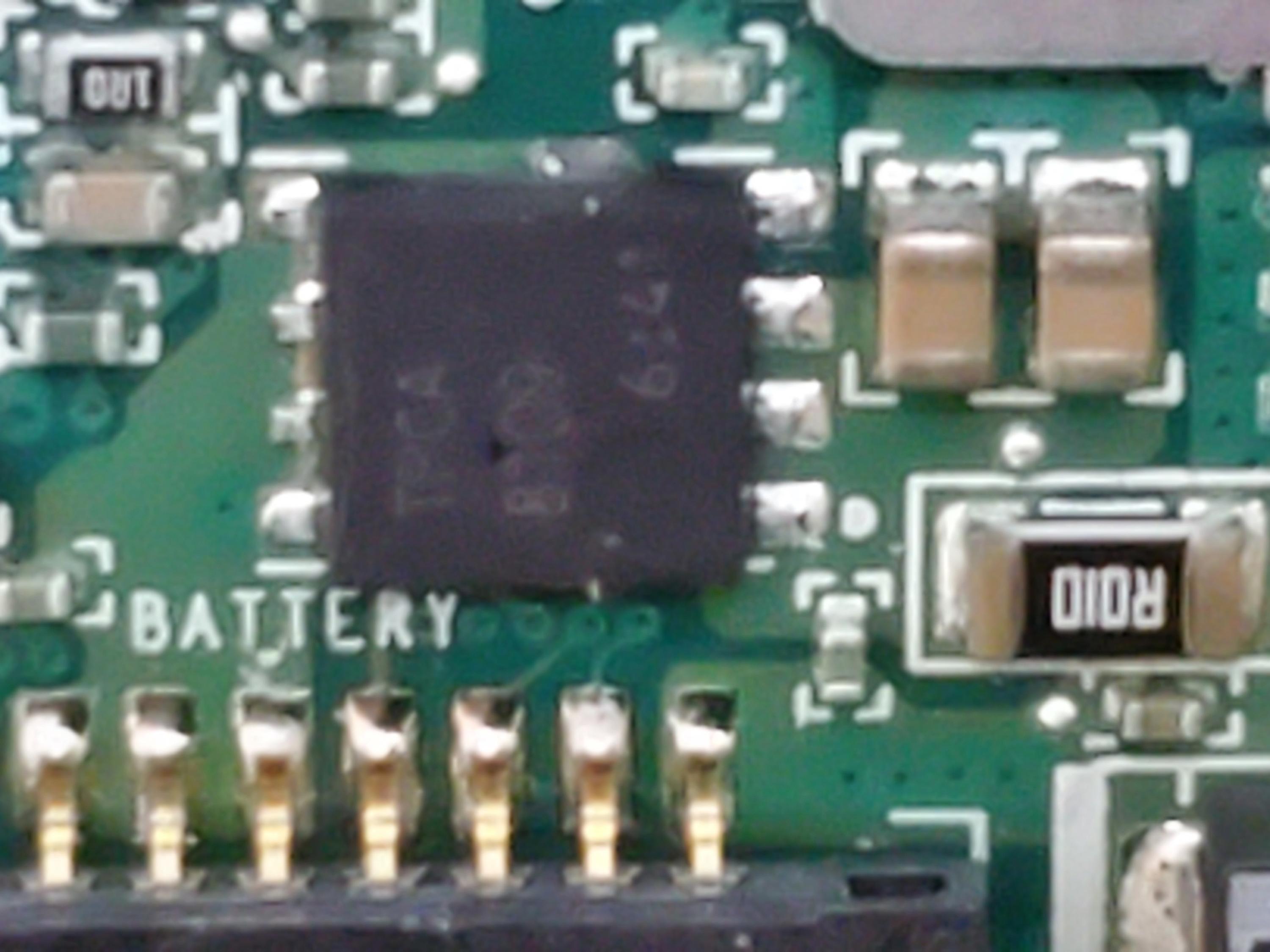

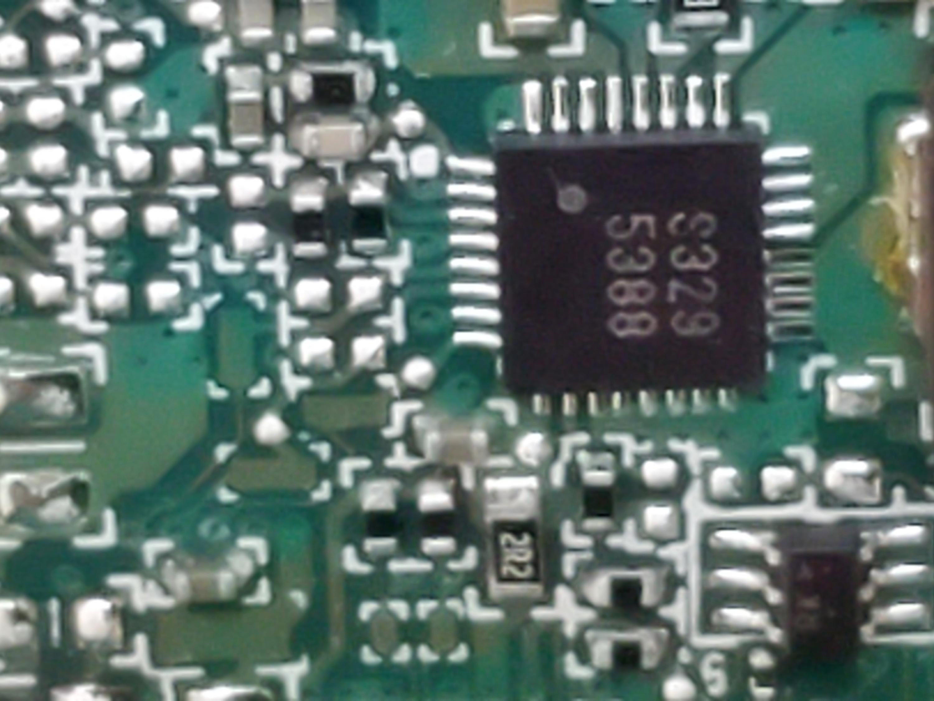

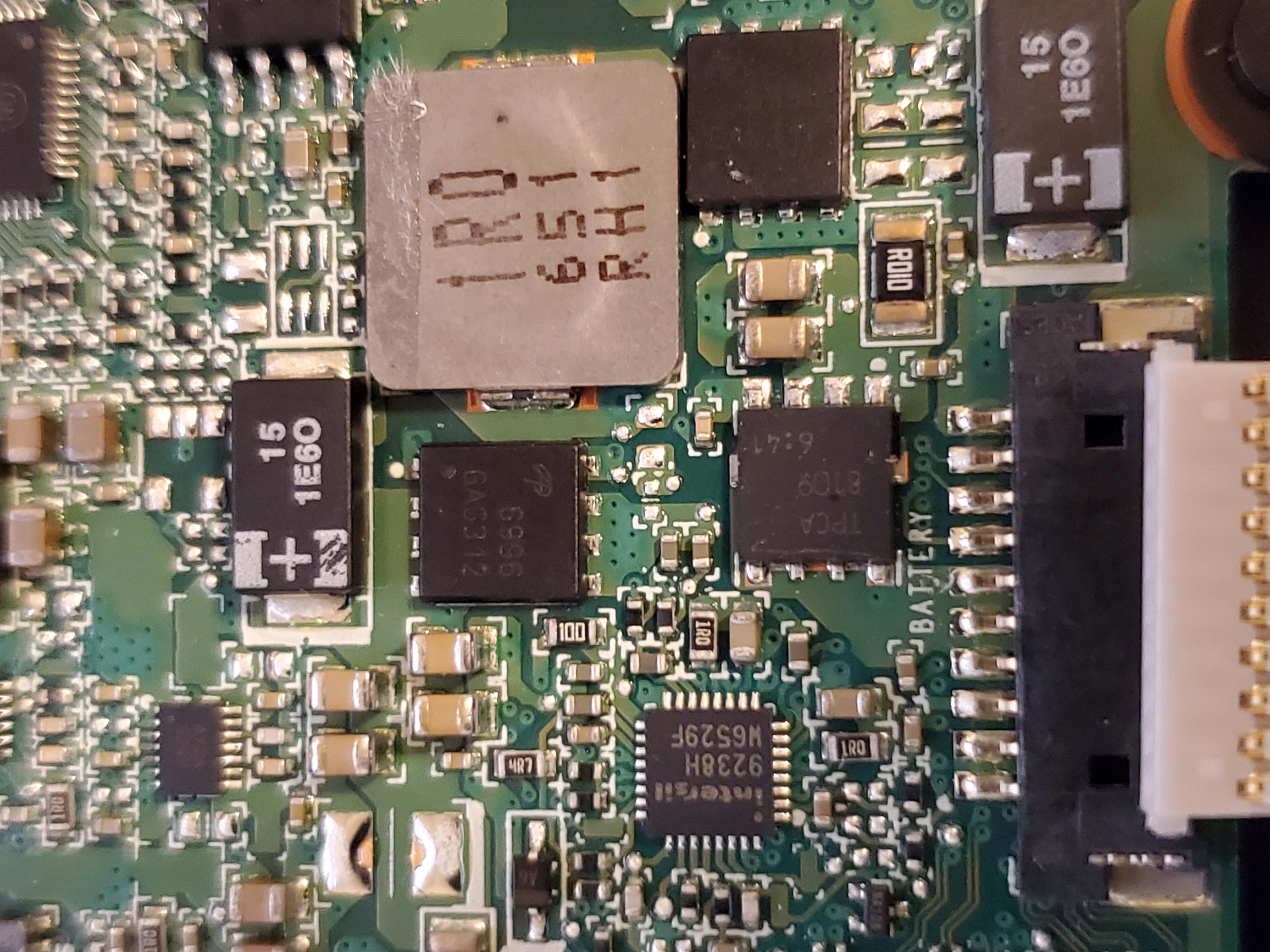

              Here are hi res photos of all the chips on the motherboard excluding the CPU.
              The only chip I could find that is relevant to this is the Winbond chip. There are no other Winbond chips on it.
              • tansoftware
                • May 2020
                • 13
                Please find hi res photo of requested chip.
                It's:
                BH61A
                25B64CSIG
                P13192
                Thanks for your help.
                  • 21606
                  It's:
                  BH61A
                  25B64CSIG
                  P13192
                  Thats the one !
                  Added datasheet.

                      • 21606
                      The CH341A doesn`t support the 25B64CSIG .Use AsProgrammer software instead. That doesn`t support the 25B64CSIG either but does support MX25L6473E, its cross compatible, change the hardware to CH341A,then choose the (MXIC) MX25L6473E from the list .
