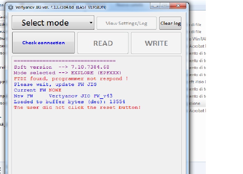

    hi,
    my vertyanov sio programmer don't work.
    FTDI is ok but push reset button don't work.
    3V3 is present on Altera and Atmega328, clock is present, on pushreset button only 0.241V, no short on Altera.
    Any suggestion?

        Use the latest software version, http://vss.store/VERTYANOV_JIG/OTHER...IG_ver_3.X.rar
        The instructions to reset are in the manual:
        The second way is forcing the FW programmer to update. Start the shell and hold the reset
        button on the programmer. While holding the reset button, in the shell click Check
        connection. After the appearance of the window asking to press the reset button - release
        it. This method only works if there is a file named UPDATE.txt in the folder with the
        shell (it is always present by default for convenience). You do not need to update the FW
        of the programmer every time you start the shell "manic".

          nothing.
          is possible atmega328 faulty?
