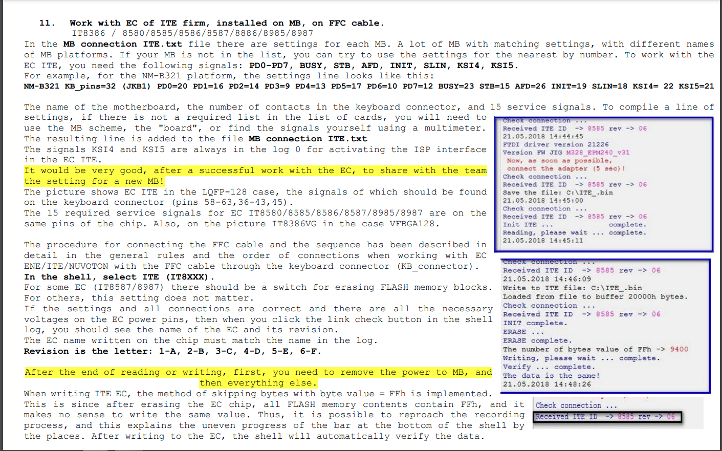

        HOW CAN FLshing ec for io
        I ASK HOW CAN REPROGRmming io ITE8587E ?
        I HAVE Vertyanov VRE 3.1 BUT I CAN'T FOUND profile FOR THIS BOARD
        P/N:08N1-18Y3Q00
        REV 2.1
        help me pls

          Pegatron (D15S) 08N1-18Y3Q00 KB_pins=24 PD0=2 PD1=11 PD2=16 PD3=8 PD4=17 PD5=15 PD6=19 PD7=1 BUSY=5 STB=13 AFD=3 INIT=10 SLIN=12 KSI4=9 KSI5=7
          The info was found on the Vertyanov russian support forum.

            not working

              Instruction Vertyanov JIG ver3
