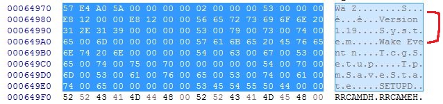

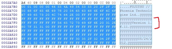

            I think the EC bios was successfully written because in the search box I found version 1.19 (with a hex editor), but when I search the same in main bios I found version 1.11. that means the main bios not reach a successful reprogramming.
            anyone can help me to fix my main bios plz? I need it friends. Thank you

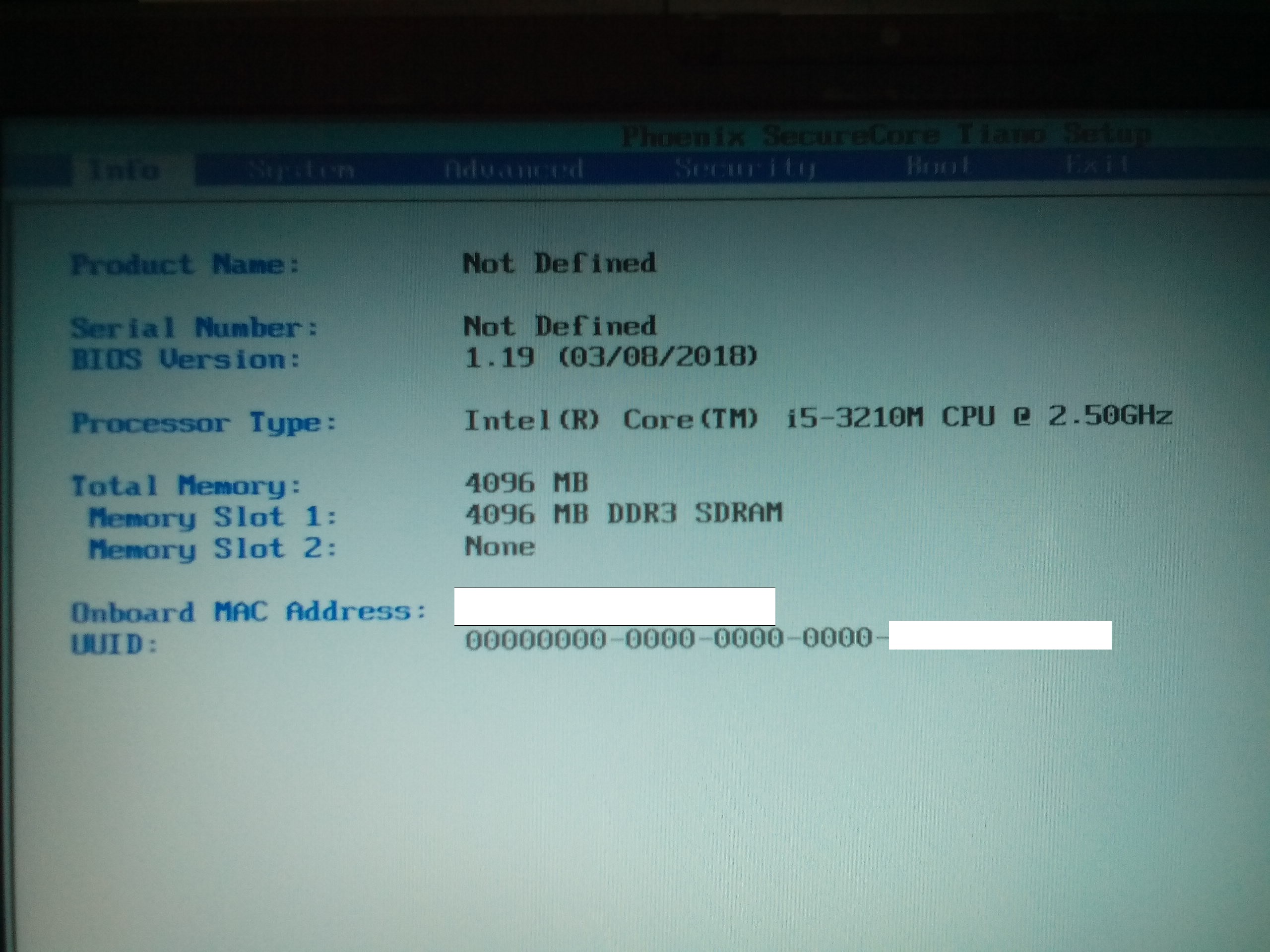

                Thank you Bro, you save me really, it's work, just there is no Product name(not defined), no Serial Number(not defined), and i think no UUID(00000000-0000-0000-0000-************), i add a picture .
                i don't know if the onboard mac address is correct and the UUID.
                Bios version : 1.19
                Can you add those details from the original bios ( or compared to the original)?
                Thank you friend, really big thanks.
                  • 22284
                  Re: Fujitsu lifebook e782 BIOS need
                  That info is in the EC .
                  • kiraro
                    • Jan 2016
                    • 177
                    • North NY
                    how can I get it from my original bios and added to the new working bios EC?
                    I found two blocks with my serial number in my old EC bios but in the same address there is nothing in the new file so if I add those two blocks that should be work with my serial number and other information like model and UUID, or there is some risk?
