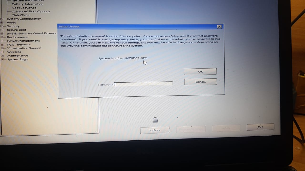

          Dell Precision 7510 AAPA0 LA-C541P
          attached backup is locked
          need help to unlock it

            any help please please
              https://bios-pw.org/

                Re: Dell Precision 7510 7710
                Originally posted by hoaca388
                it is administrator password not power-on password
                bios-org not working
                  What's your suffix ?
                    only have system number
                    JVZ8DC2-6FF1
                      • 22293
                      #70
                      JVZ8DC2-6FF1
                      https://www.badcaps.net/forum/showpo...42&postcount=4
                      Note: The 6FF1 suffix has a bug,use your service tag with the BF97 suffix instead,Example: 1234ABC-BF97
