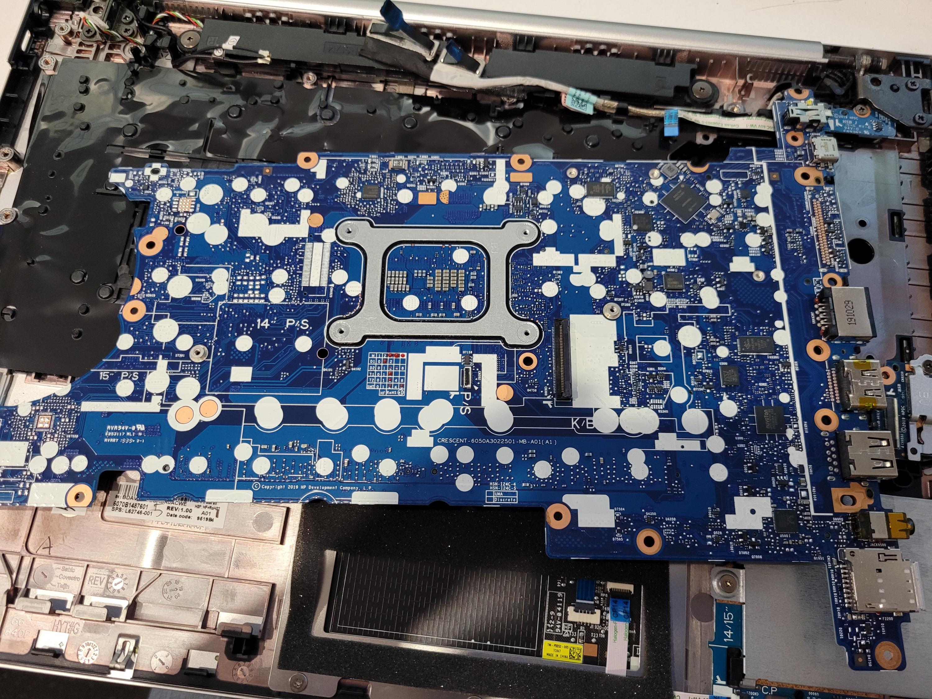

                                      #78
                                      Re: HP Elitebook 840 G6 Admin PW Help
                                      Originally posted by peste View Post
                                      the laptop has two bios, one of 32MB and one of 16MB ... if you don't rewrite both of them you won't get rid of the password ... look for the second bios chip (16MB, it can be on the other side of the motherboard) , and write it with what I sent ... don't forget to make a backup copy of the 16MB chip before writing it ..
                                      I am unable to find the 2nd 16MB bios chip. I have taken the board out and looked on the other side but can't see anything which looks like a 16mb bios chip.
                                      I have included a picture of the other side of the motherboard. Can you help with locating the 16mb chip?
                                        #79
                                        U366 must be the second chip. Can't see the markings but looks like that.
                                        You can write here the markings of the chip for confirmation.
                                        Become a Badcaps supporter
                                        Thanks to all supporters.​

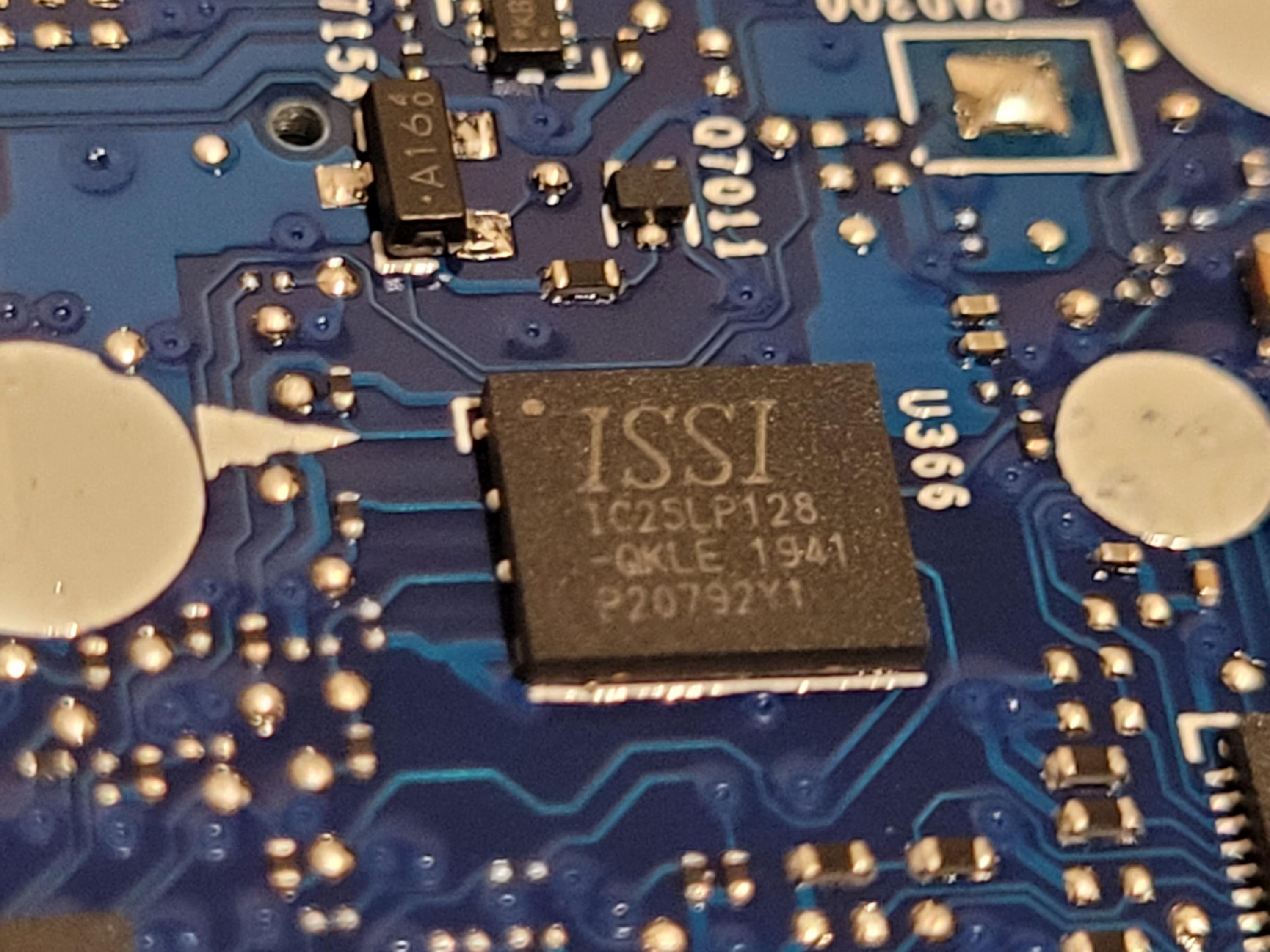

                                          #80
                                          I think you're right. The chip is IC25LP128 so it looks like the 16mb chip.
                                          However there are no exposed feet/pads, so I can't solder wires onto it. I don't want to remove the chip to read/program it. Very annoying.
                                          But thanks everyone for their help
