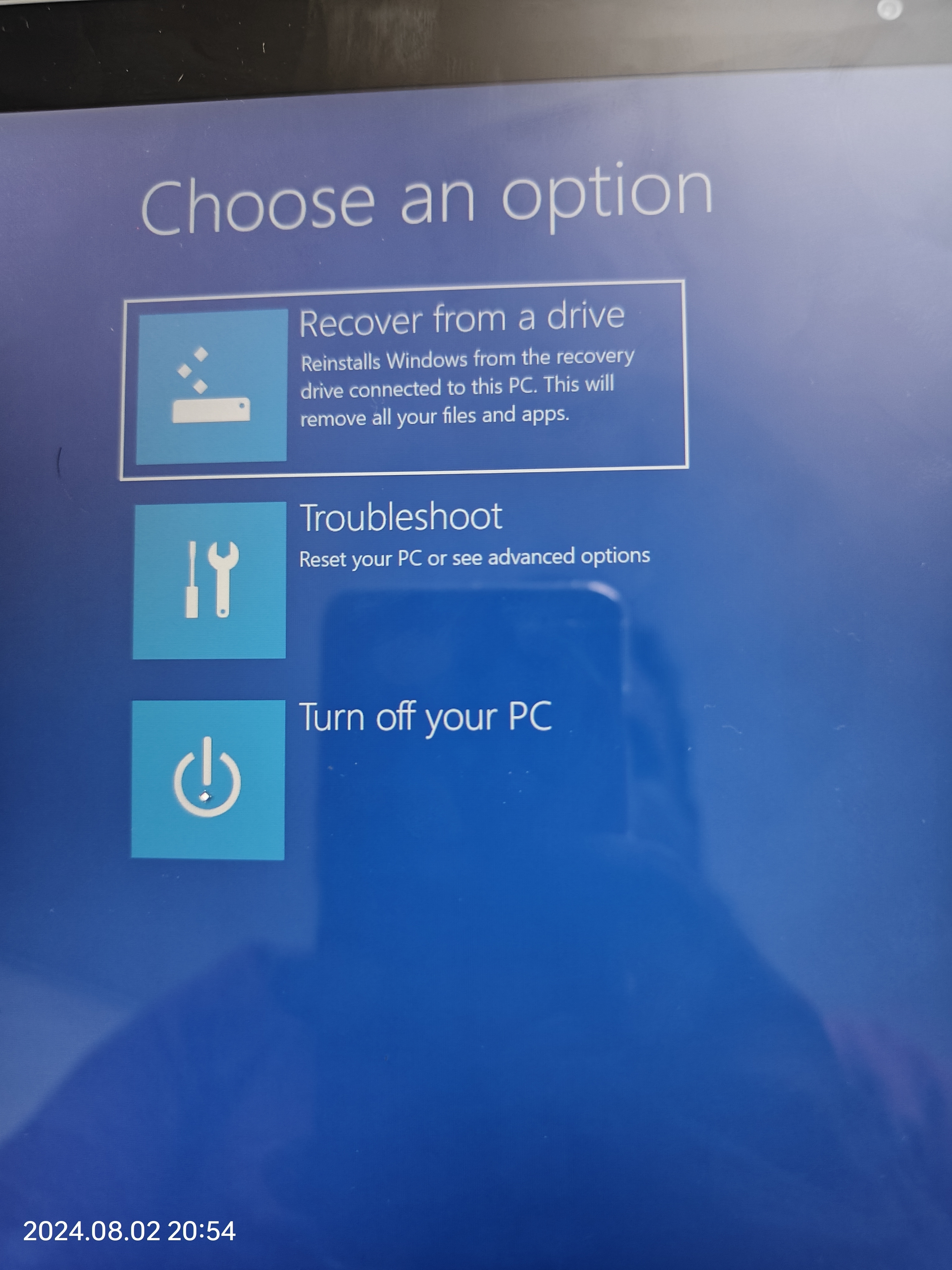

      Thankyou for the tip. I just tried booting into usb recovery drive by pressing volume down and power button and only got the below options. Recovery option did not work. Came back with error after 2% . Only shutdown option available not restart. Not sure what am doing wrong.

        I just again boot into usb, selected trouble shoot and selected uwfi settings where it says restart. I pressed shift and pressed restart. Nothing happened again the password prompt like below image.

          You do understand what is your goal here?
          No point in going to uefi settings - you have got a password preventing you. Your goal is to remove the password.
          No point in trying recovery - you have a bios password, not a broken windows.
          You need to boot.. Somewhere... Easiest option is to boot on Windows USB install disk, which you need to download and make using another computer. And then on that same computer, download and copy flash programming tool onto that USB install disk.
          Connect that usb install disk with your surface and try to boot onto it.
          If you did have that ready already then you are just trying to boot into recovery menu, which is not USB install disk. So stop doing that.
          Like I said, if you have windows installed (even if it has a user password), boot onto that, click on power button icon and click shift + restart. From there you can make it boot onto the usb install disk.

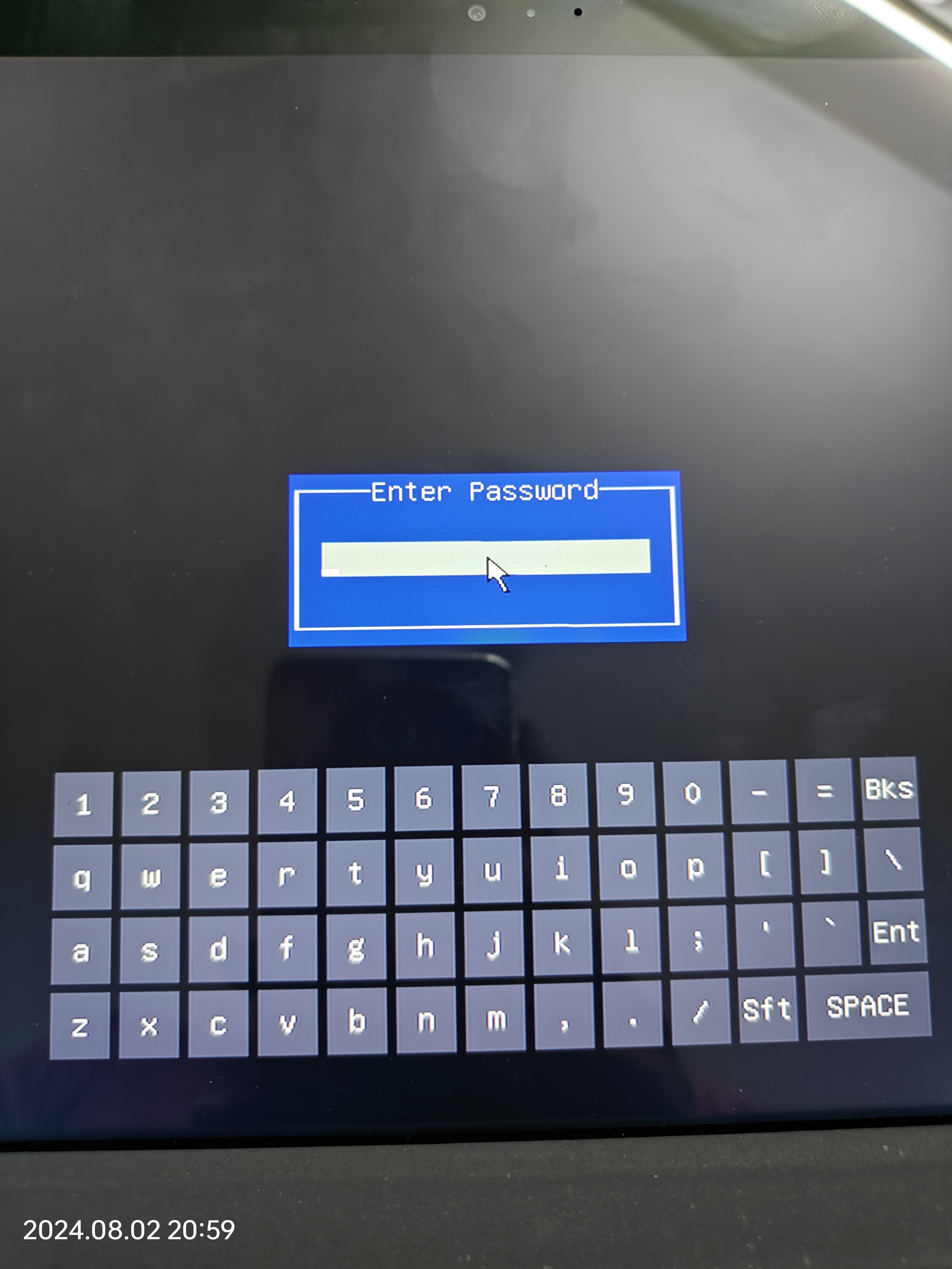

            Hello, can you help me with password bios ?
            SN : 051988443353
            Model : Surface Pro 3 128Gb 4Gb Intel i5-4300U

              try..
              xpppbios

                your backup is corrupted and has an unusual length. Anyway, try pass:
                xpppbios

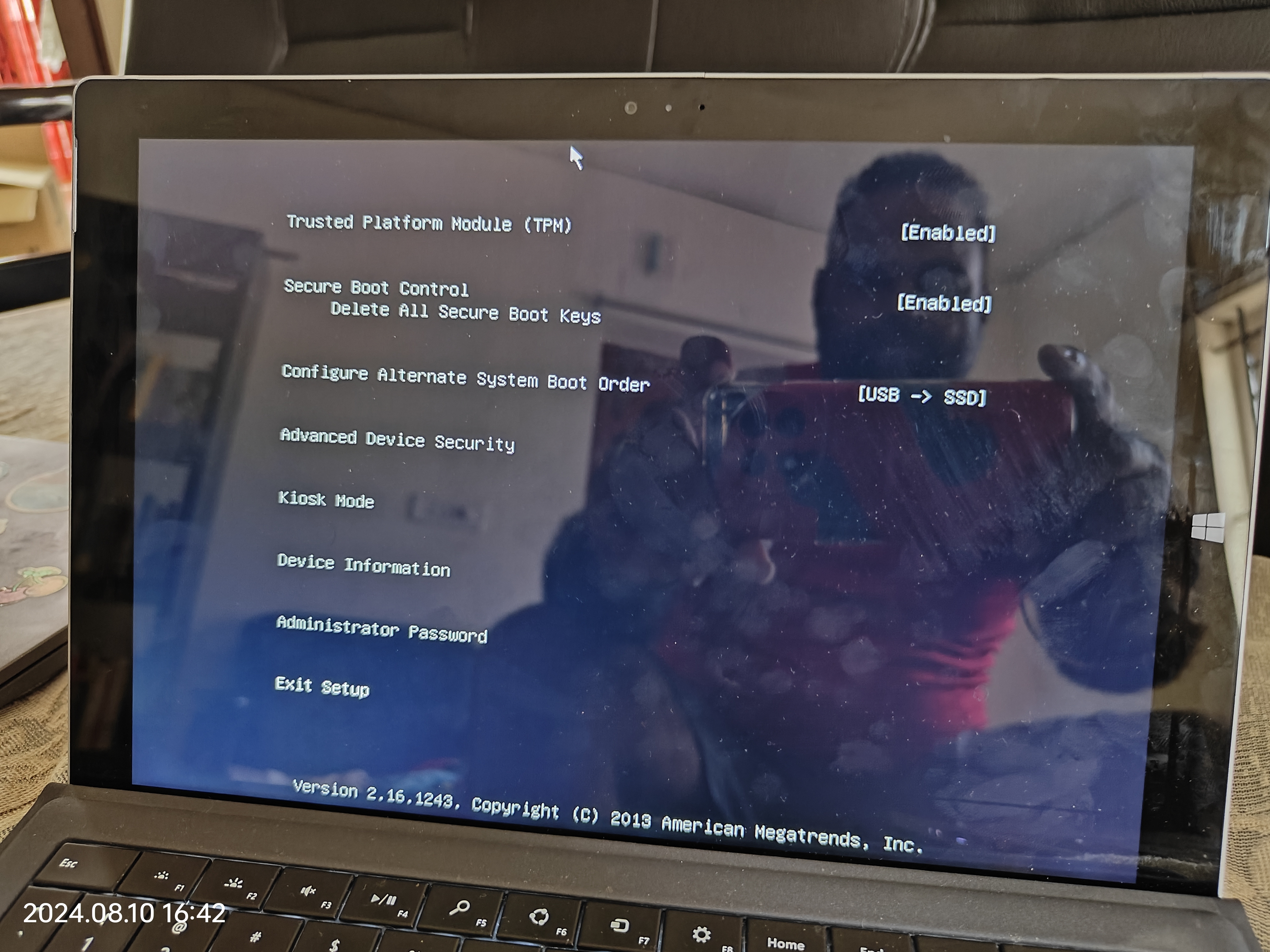

                    I think I found it. Its "surface". even after entering and changing the setting of TMP module to disable TPM and secure boot. the laptop is booting into TPM screen only. what is the solution for this

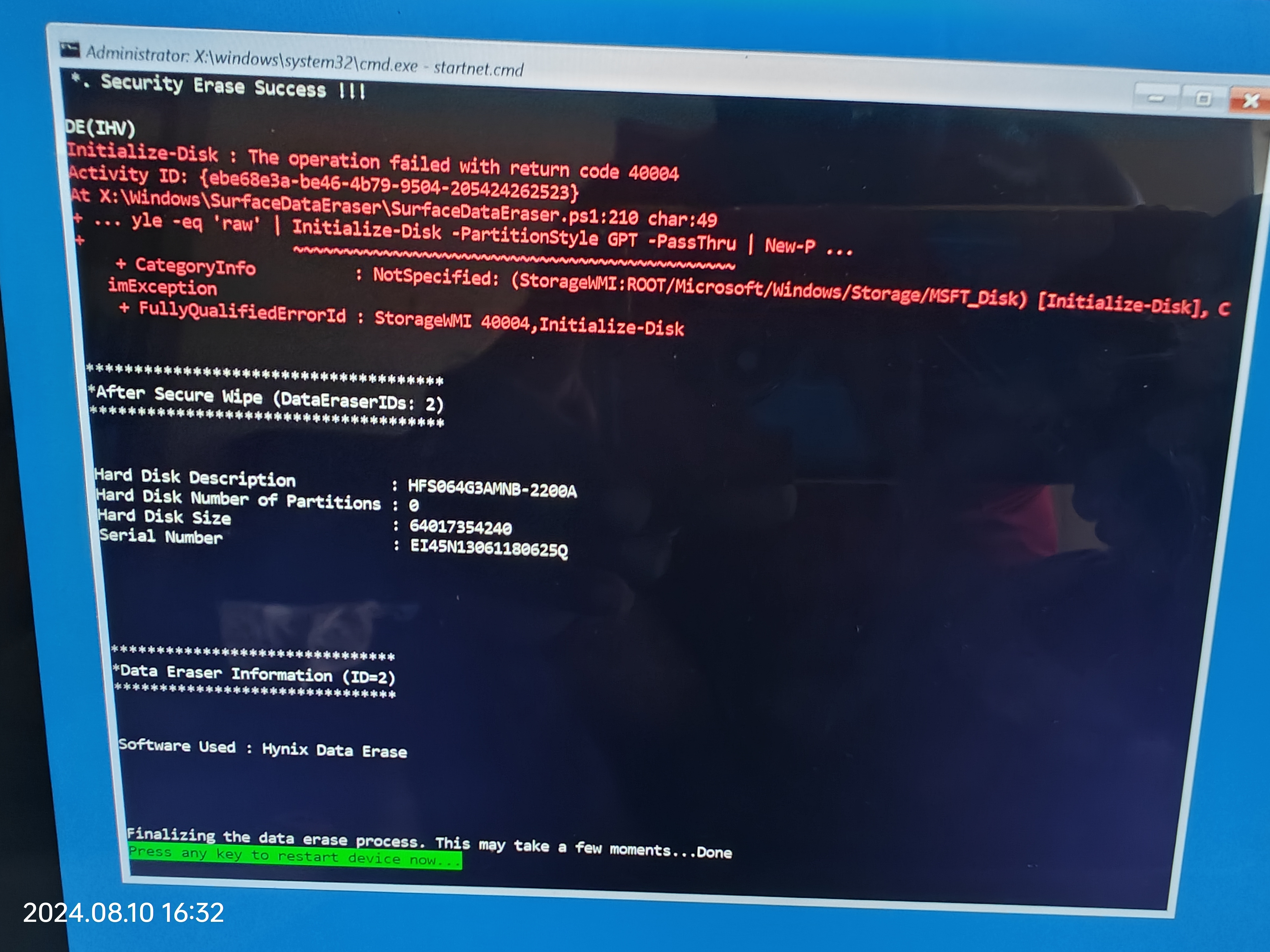

                      I think the ssd has failed. When intry to run the disk eraser tool it did not recognise make and model. When I boot using recovery disk and checked the diskpart. It only showed removable sd card and the USB. Not the inbuilt memory.

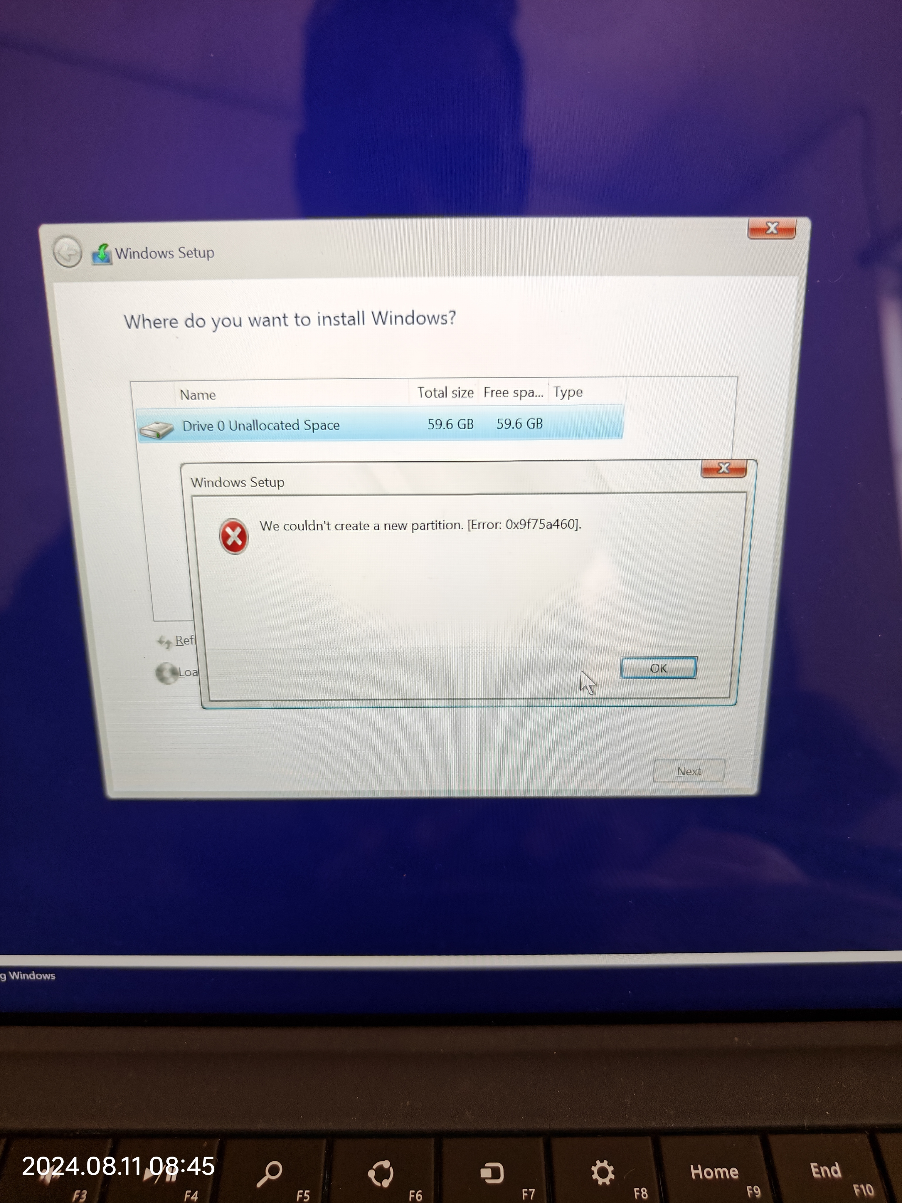

                          TPM= trust protection module attached image.

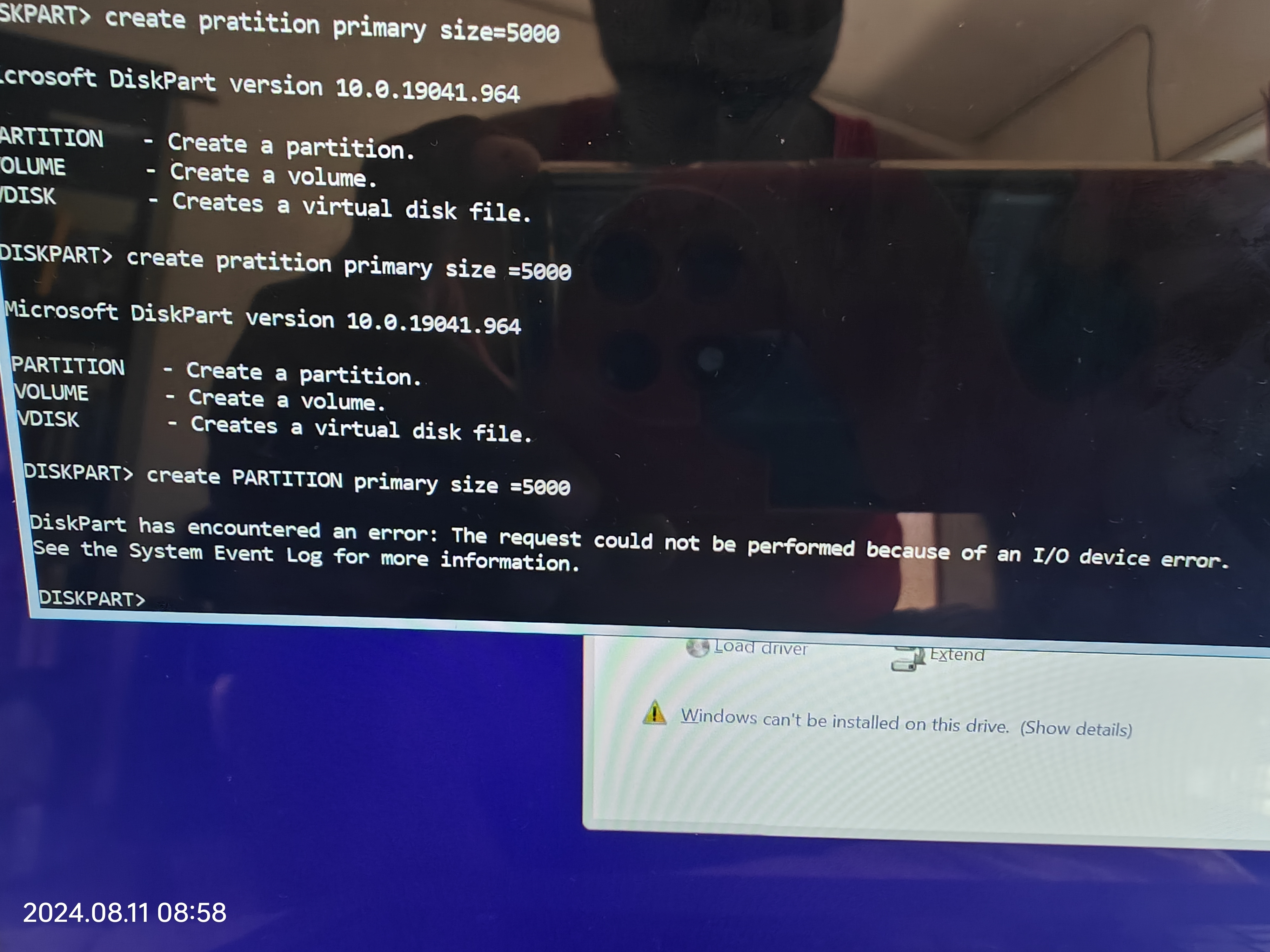

                          I just tried full and clean instal. I can see it shows internal SSD as 59gb something. But not allowing me to create partition or format it. I tried shift+f10 and entered diskpart to do the partition but it says I/O device error.

                            That "TPM screen" is bios.
                            Not sure if I've encountered faulty SSD on pro 3 but on newer models its not that uncommon to have a faulty SSD.
                            But I doubt its worth it to replace it. You would need a heatbed to remove thr screen. A hot air station, flux, tweezers to remove the faulty SSD. A new SSD. Might even need a stencil and solder paste to reball. And lastly thin double sided tape to put it back together.
