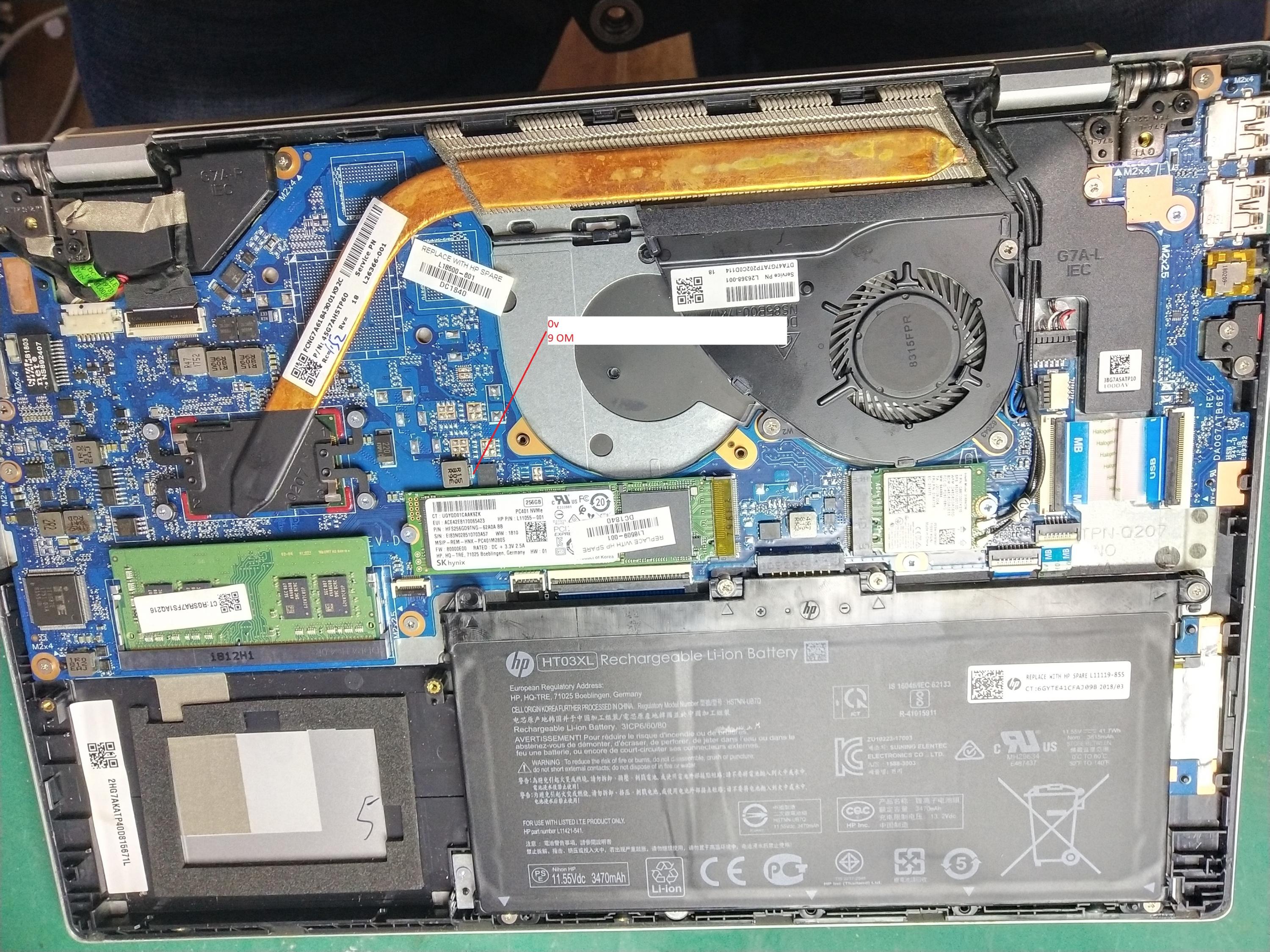

      Thank you, mahmoodjavan, there is no voltage on the coil marked in the picture, I wanted to make sure that it would be the same on another bios. I have the same on your bios.

          Thank you SMDFlea, is the same on your bios. PWM_AUXI oscillations is missing on the 22 pin of the RT3602AE circuit, what should I check?

                      So I wanted to share the "solution" that I found ... Basically the RAM slot is defective. In fact, if you try to lightly hold the RAM bank towards the motherboard, you will see that the notebook starts ... Clearly the perfect solution would be to resolder the slot

                        Thanks for your suggestion, you were right, i tried it and it worked for me 100%.

                                  Yes fixed .. by soldering the memory card slod.
                                  IF Cpu code is heating up. remove the mosfet and check the gate if shorted to ground. follow gate to the controlling ic and check shortage on the ic. Remove ic and shortage gone from the gate. change controlling ic also check if dual mosfet is shorted . change the mosfet if faulty.

                                    i have same problem, white led blink 3 times on capslock key . after resolding the RAM slot laptop works fine.
