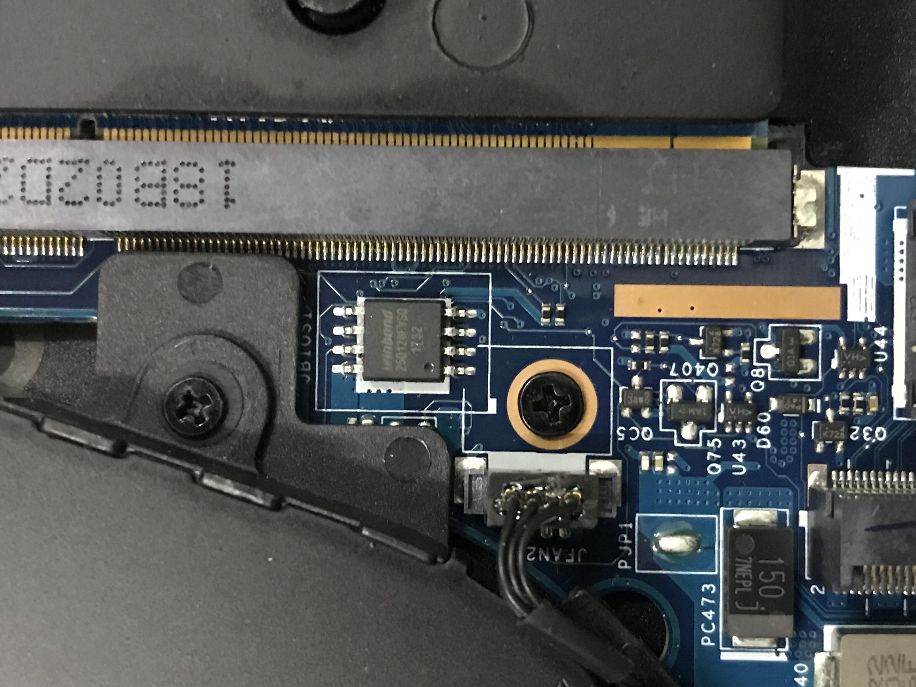

    I need Main Bios DUMP (16MB) and EC DUMP (4MB) of HP Zbook 15 G4, motherboard is LA-E161P.
    Thanks for your help.

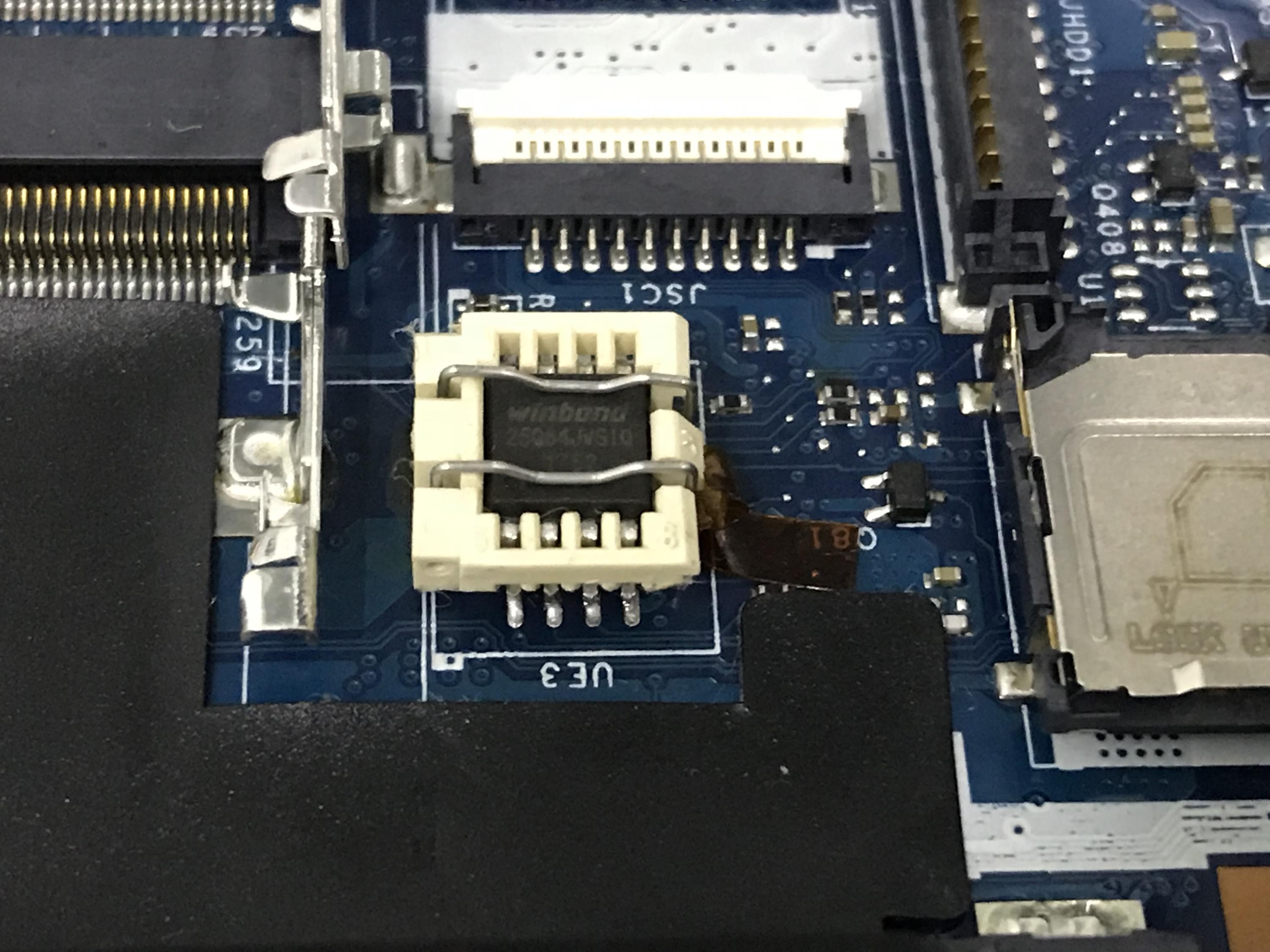

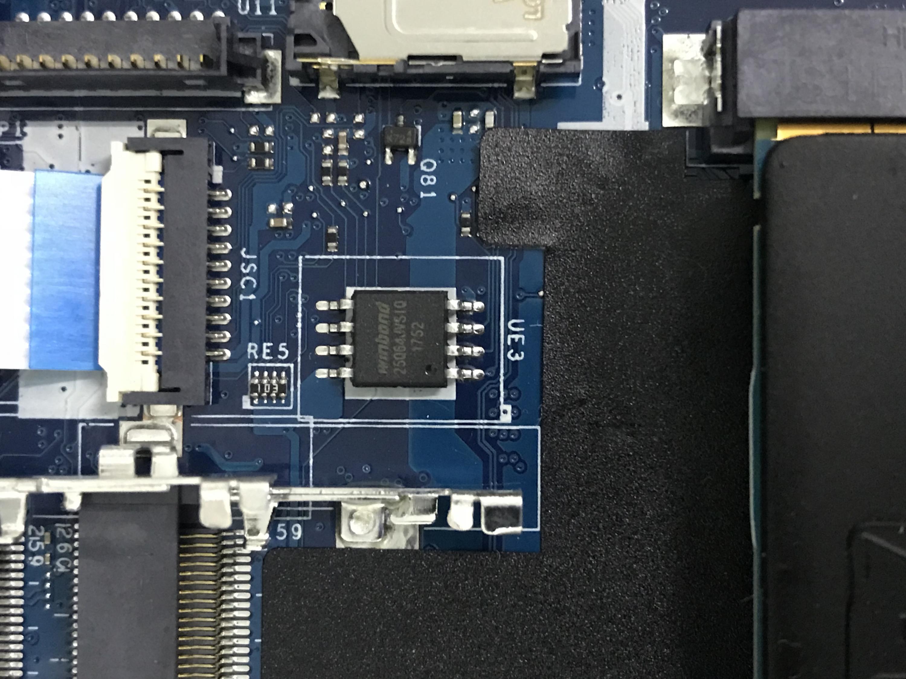

    I am sorry. EC is not 4MB, it is 8MB. I need EC Dump at (W25Q64) UE3 location and Main Bios Dump at (W25Q128) JBIOS1 location.
    Thank you so much.

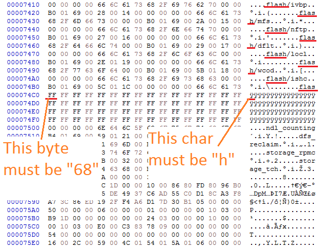

          Here are my Error JBIOS1 Dump and Error UE3 Dump. They are abnormal. I used HxD Hex Edit application to view my Bios, Some Data were filled by "FF" random location in Bios and EC. For example: in Error JBIOS1 Dump, data form"74C0" to "74FF" were filled by "FF". Please view Capture.PNG for more details, thanks
              No display problem?

                    Thank eikspaj. I wrote your Bios and the status of machine was not change.
                    I used HXD to compare "Error UE3 Dump(FIXED)" with "Error UE3 Dump(FIXED)". They are identical.

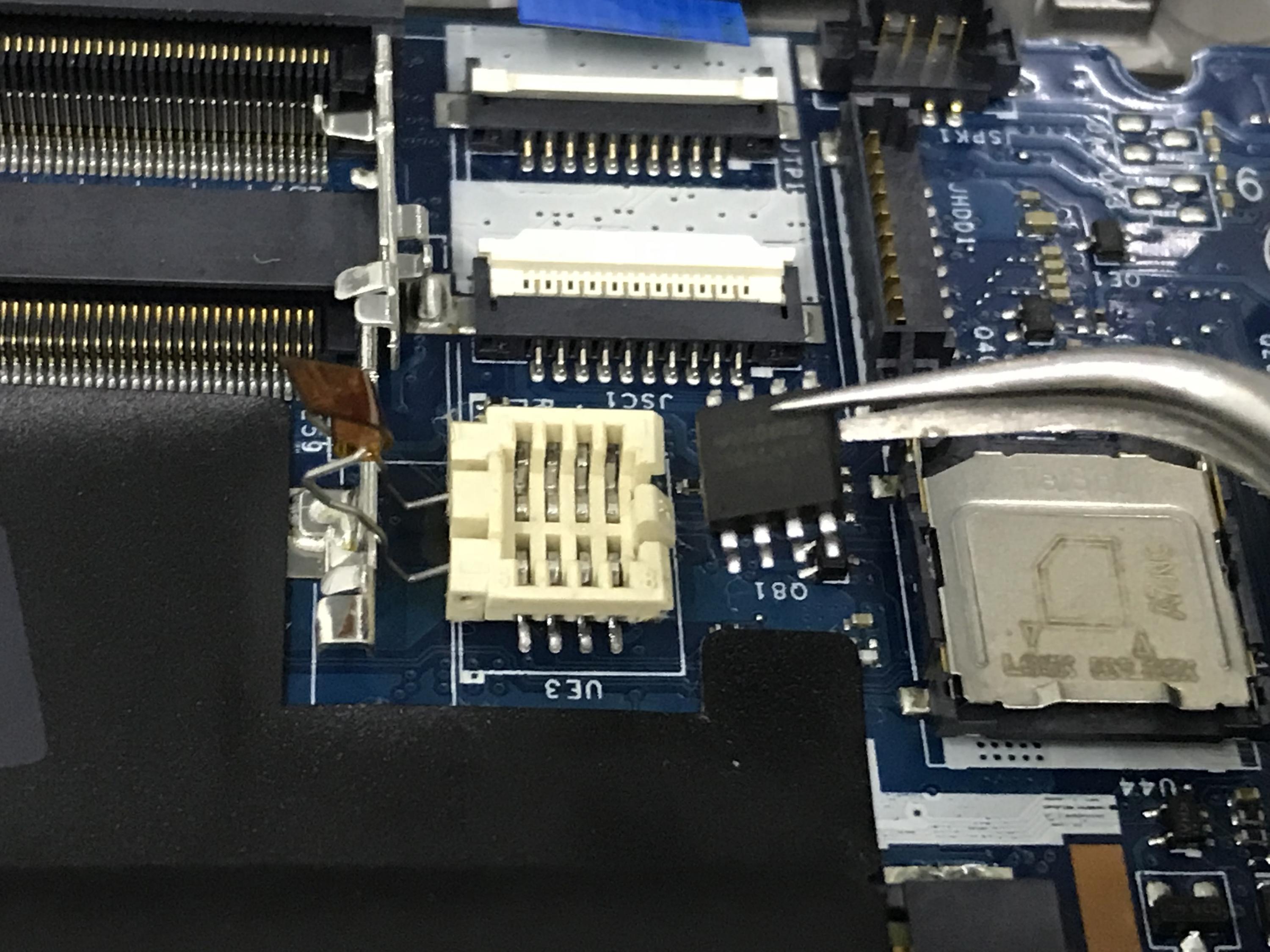

                      I have CH341A and RT809F. In this case, I used CH341A with SOP8 to read and write Bios.
                      I have just added SOP8 at UE3 location.

                                      It is very interesting how i have searched the whole of the board and cannot find the bios chips to write new firmware onto them
                                        • 20837
                                        Re: Need Backup Main+EC HP Zbook 15 G4 LA-E161P
                                        see the pictures at post #2
