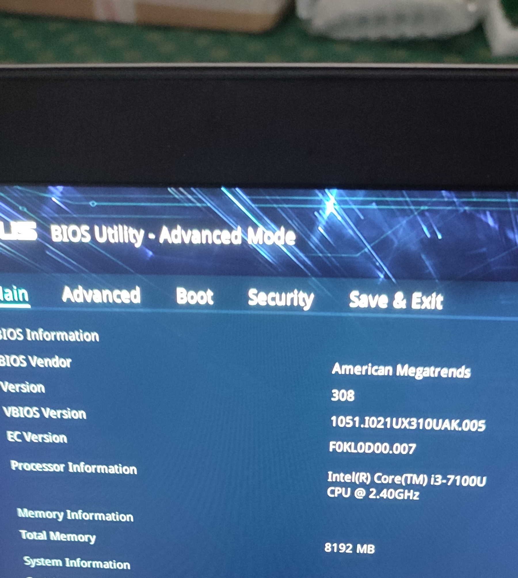

                  • reggelni
                    • Jun 2019
                    • United Kingdom
                    Re: Ux310uv rev : 2.0 need bİos
                    Originally posted by SMDFlea
                    Try this one .
                    Do you think this would work on UX310uv rev2 motherboard with i3-7100u cpu and without dedicated graphics as well?
                    Thank you.

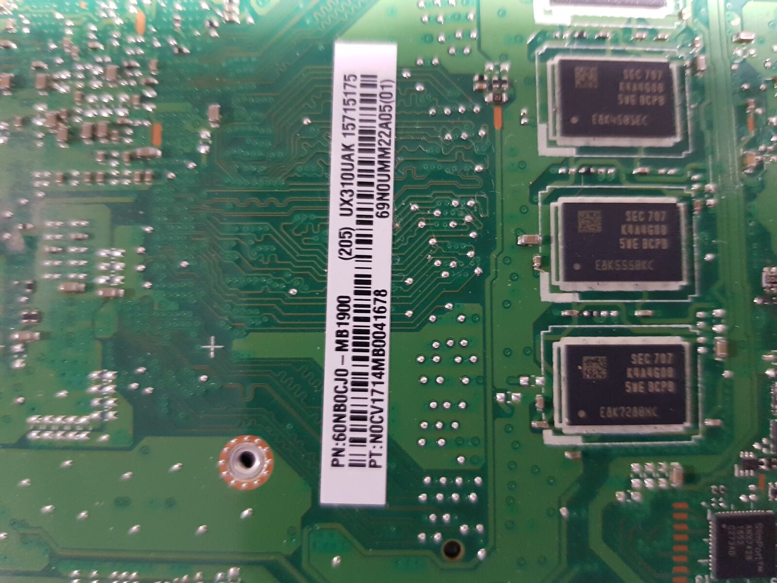

                                  • 20888
                                  Originally posted by rager007
                                  hi. Ux310UQR rev: 2.0 Start ok no screen old bios. 0.7 amper start ok no display
                                  The bios above does not work.
                                  Post a picture of the barcode sticker,like the one at post #4 above
                                  https://www.badcaps.net/forum/showthread.php?t=96604
