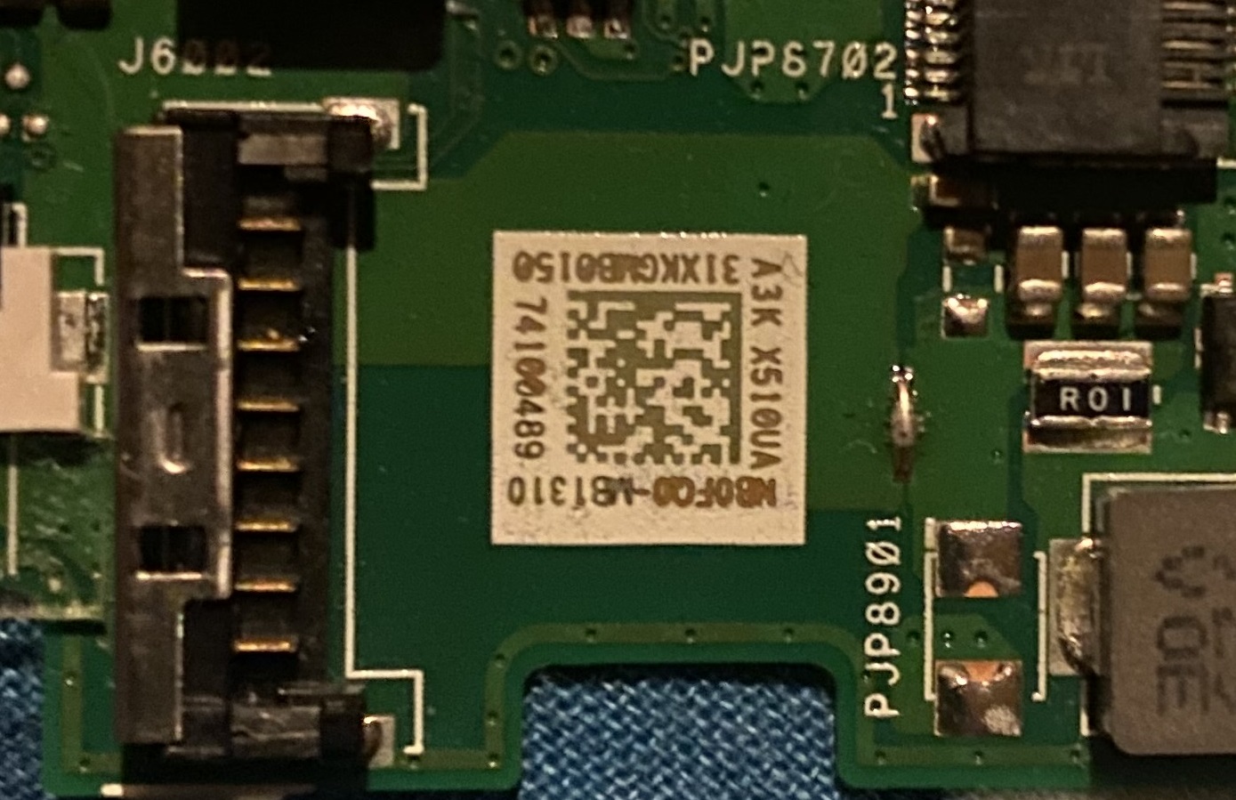

    please any body have de dump file for asus s510u x510ur NB0FY0-MB4120
    thanks you so much

    Re: bin asus s510u x510ur
    no one? im looking for this bin too
      post your original backup then someone will rebuild it for you
        there u go
          try this repaired file
            with your original windows key
                  Please can someone help bios it is ok but there is a display after 36 seconds can someone fix me this problem thanks
                    Originally posted by pcpartrepairlab
                    please can someone help bios it is ok but there is a display after 36 seconds can someone fix me this problem thanks
                    try
                      Thanks works great
