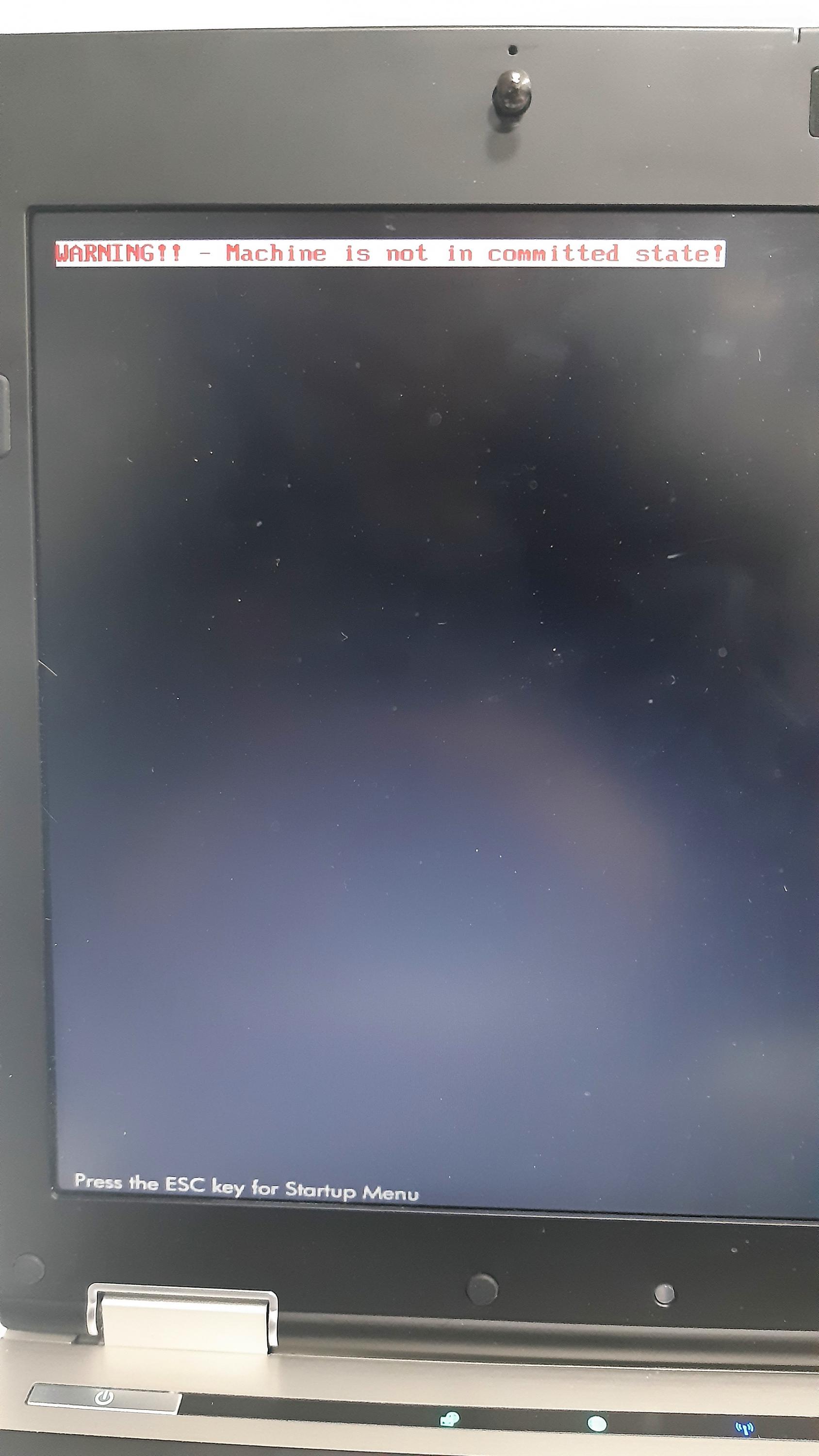

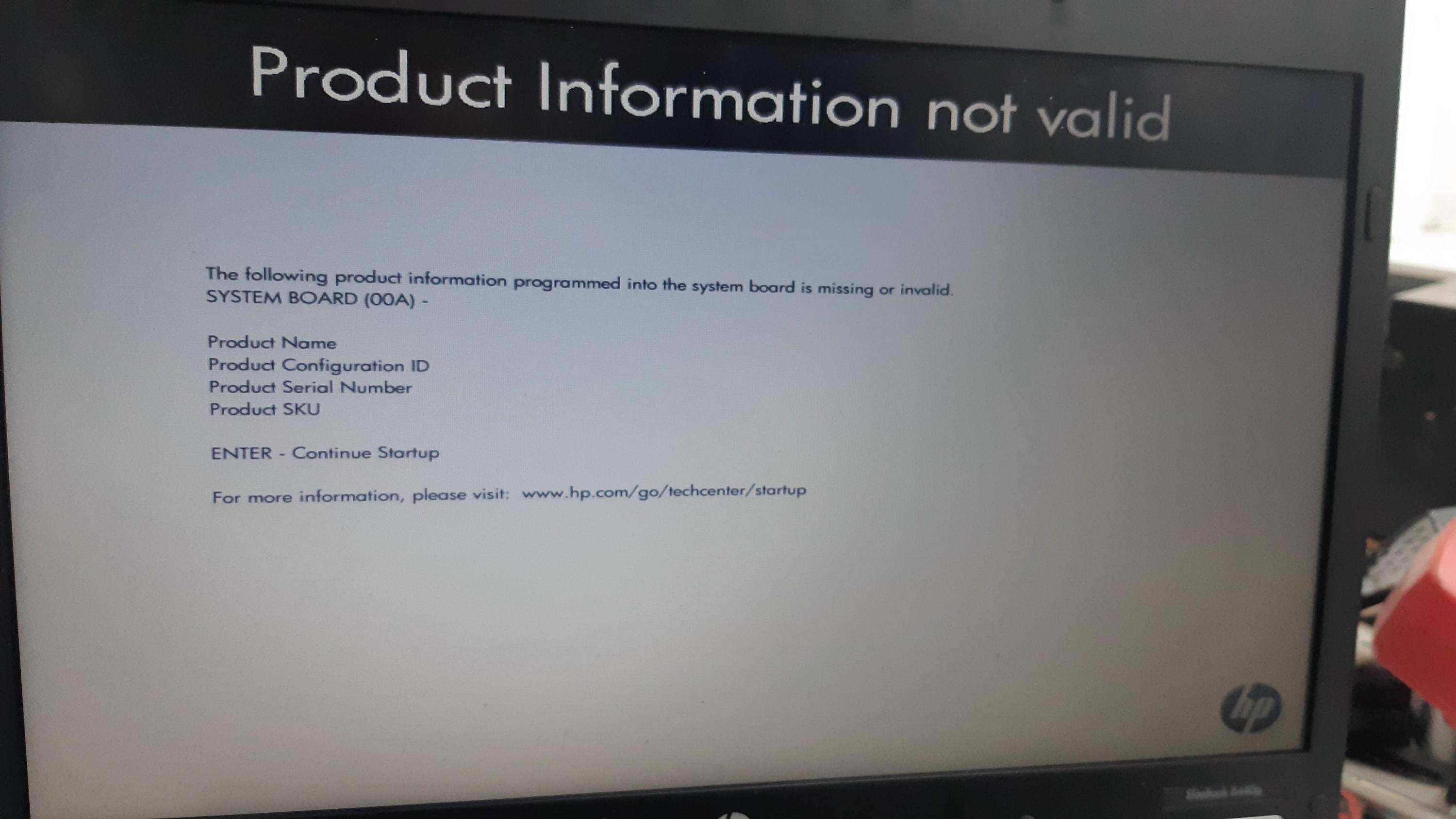

                                    HP EliteBook 8440p
                                    This laptop did not want to turn on.
                                    When i press power button it only flashes battery light.
                                    I tried a minimum of ten different bios dumps,with each bios the laptop lit up,but had no picture.Except one i found on this tread https://www.badcaps.net/forum/showth...light=hp+8440p ,post #13 from SMDFlea.
                                    It turns now on,but now it prints me out : Warning ! Machine is not in comitted state ! After that "product information not valid"... i will post picture here.
                                    I have backup from old dump,if someone can fix old one or modify this new one?
                                    Thank you !

                                      Re: HP EliteBook 8440p
                                      Thank you !
                                      try this with the bios from post # 13 ..
                                      https://www.youtube.com/watch?v=9T57ktw8n3Y
                                        #39
                                        Hello friend !
                                        Mistake on the video is not same as mine,but I definitely tried and it stayed the same.I will post a picture .
                                        Thank you !
                                        Any other suggestions,please ?
