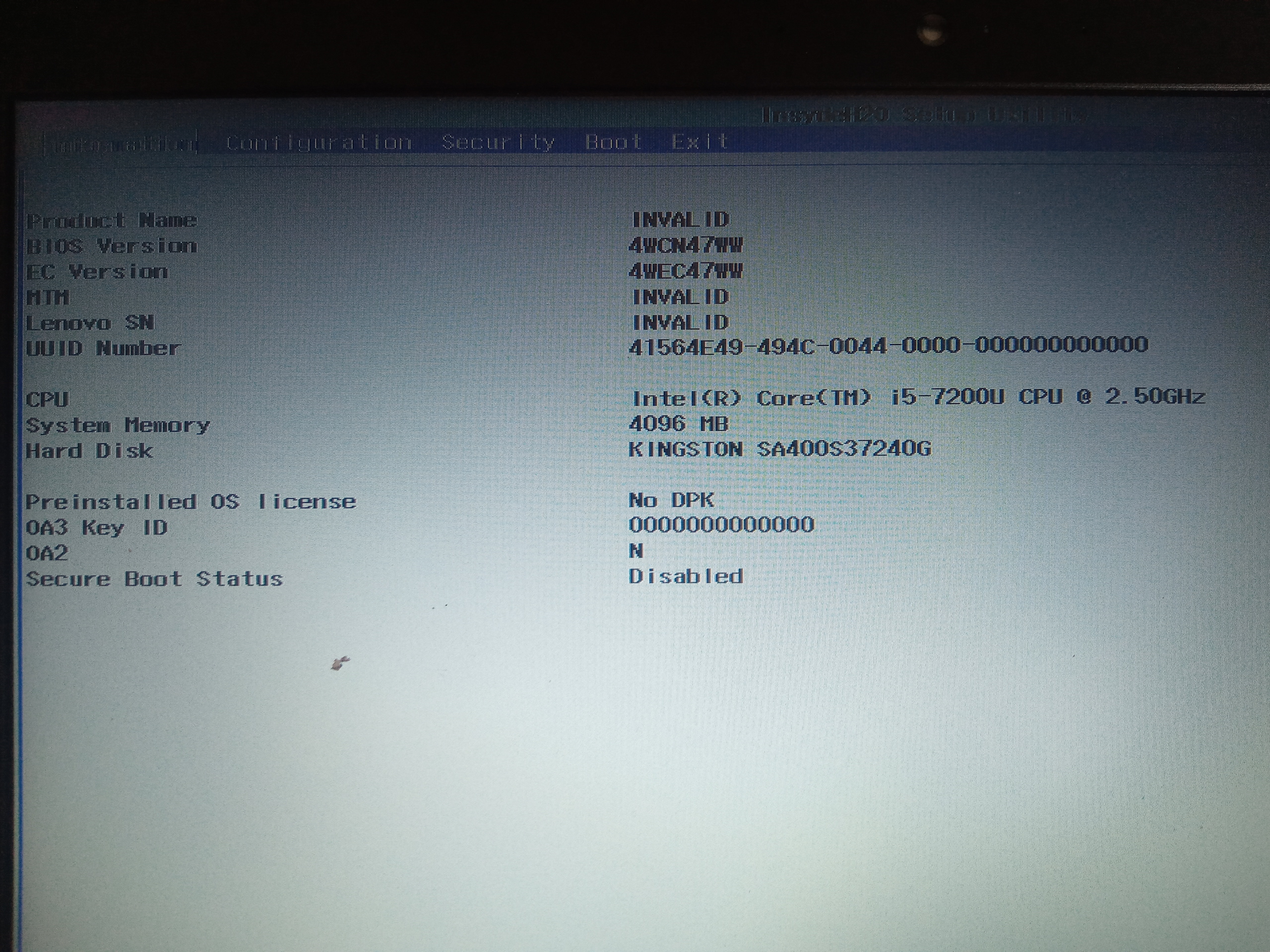

              Hello Hardware1!
              As the previous Bios sent by ALI5914 was apparently all right, I ignored his posted file, although I thanked him. But now looking for performance improvements, due to slow startup and access to Windows, I used yours, it started faster, but it lacks Hardware and software data (Product name/MTM/ S.N/ OS.License), can you help me?

                Re: bios DG421 DG521 DG721 NM-B241 REV 1.0
                Originally posted by Inforprint
                Hello Hardware1!
                Use Lenovo Maintenance Utility, you'll find SN, MTM, etc on stickers of mainboard.
                  Hello Hardware1!
                  If you mean my post #21. I just Cleaned ME for your file, so it should contains the same DMI.
