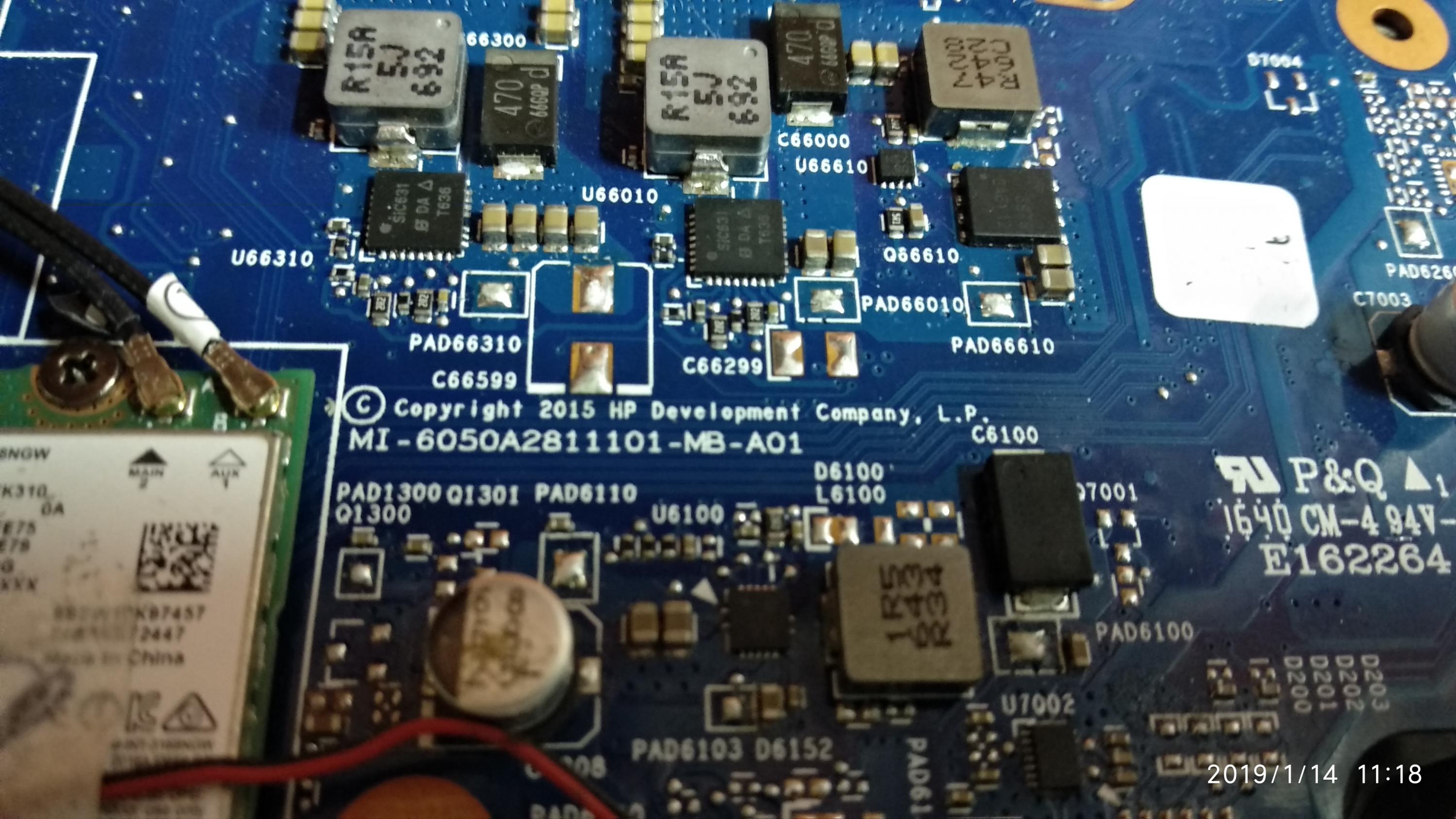

    HP 6050a2811101-mb-a01 Bios Need.
    I Need HP 348-G4 7th GEN Bios.
    Motherboard Code- 6050a2811101-mb-a01.
    PLS Help ME Hurry.
    PLS Hepl ME Anybody.

    Re: HP 6050a2811101-mb-a01 Bios Need.
    send me bios old + photo model motheboard + photo model laptop and serial I do repair for you

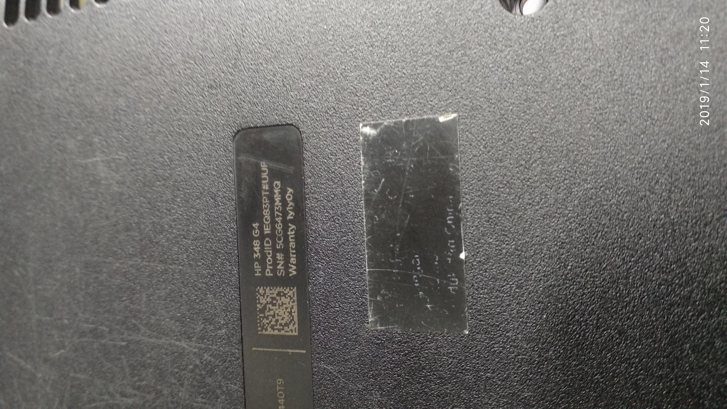

      (newfoxinformatica) Here U Need All Info.
      Laptop Model-348-G4
      Laptop SN-5CG6473MMQ
