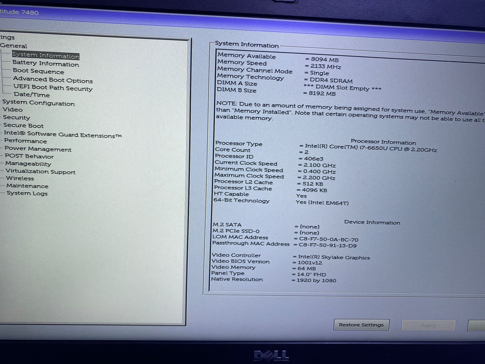

                                BIOS bin file for Dell latitude 7480
                                hi every one dell latitude 7480 here is bios file problem is usb not decided and ssd harddriver not show service tag 5RQM8S2

                                  #156
                                  Re: BIOS bin file for Dell latitude 7480
                                  Here's your New BIOS, try it and give me results.
                                  all donations are welcome,
                                  • munir100
                                    • Dec 2018
                                    • 187
                                    • uae
                                    #157
                                    THANKS FOR REPLAY problem not solved SAME
                                    • lapfix
                                      • Mar 2020
                                      • 2756
                                      • my workshop
                                      #158
                                      Try another trusted ssd
                                      • munir100
                                        • Dec 2018
                                        • 187
                                        • uae
                                        #159
                                        Originally posted by lapfix
                                        try another trusted ssd
                                        thanks for replay i also chang ssd and usb poart 5v come im poart
                                        • TuanTongbadcaps
                                          • Mar 2023
                                          • 64
                                          • VietNam
                                          #160
                                          Try flashing the BIOS with the firmware extracted from another system to identify the firmware error and not spend a lot of time on it.
