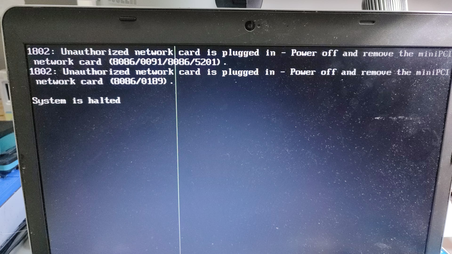

    please advice,
    i replaced this laptop mainboard due to shorted LVDS connector.
    the mainboard i recived had diffrent FRU, so it will stuck on boot 1802 error.
    New MB DAGC6AMB8H0 63Y1400
    old MB DAGC6AMB8H0 63Y1600
    my BIOS is 80ET40WW.
    is there anyway to patch the bios to remove the lock?

    Your new motherboard is for a E15 .Try this one ,BACKUP your bios first .

      Re: Lenovo Edge -1802 network card error
      works perfectly- many thanks to you my friend!!

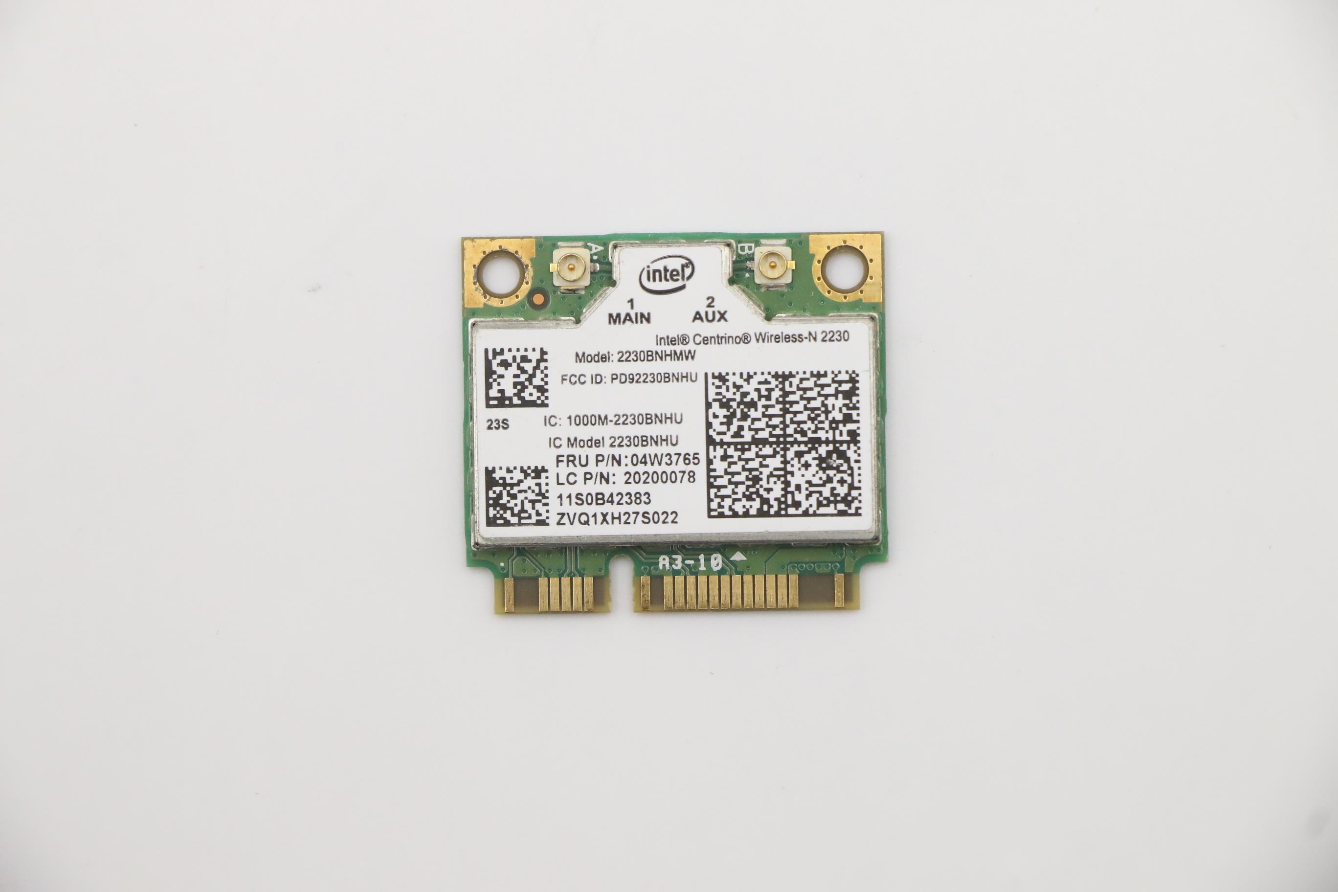

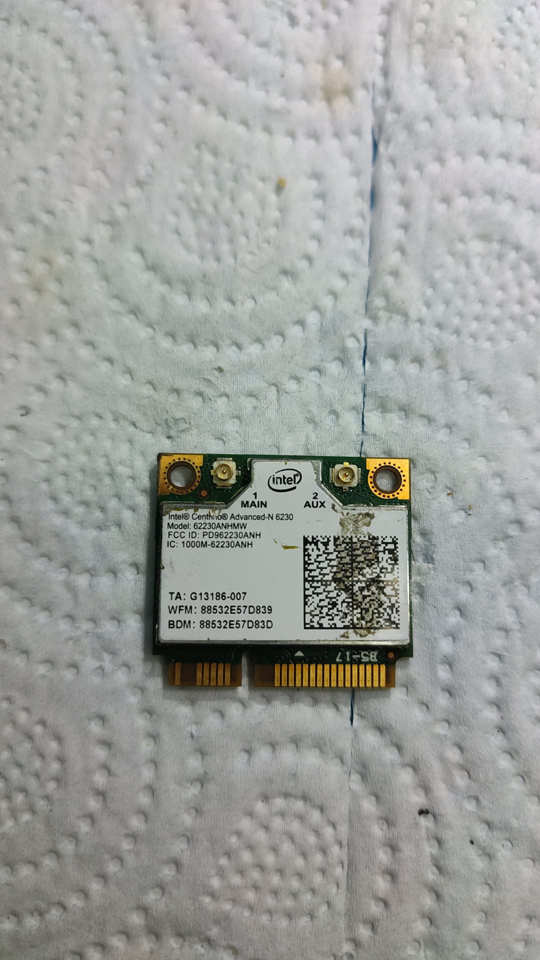

          Originally posted by proff2000
          https://www.sendspace.com/file/k6o1ox
          lenovo thinkpad e531 1802 error code
          I think this is the suitable Wireless Card for your device.
