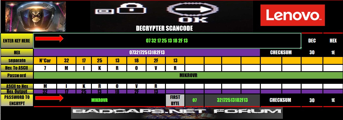

                          The checksum calculation is very simple...
                          Just add all the digits of the string to get the value.
                          a.g.
                          Password : mikrovr
                          Hex string: 07 32 17 25 13 18 2F 13 1E
                          first digit: 07 => 07 password length
                          last digit: 1E => 256 checksum
                          07 + 32 + 17 + 25 + 13 + 18 + 2F + 13 + 1E = 256
                          The checksum may vary depending on the password;
                          2, 4, 8, 16, 32, 64, 128, 256, 512, 1024 etc.
                            Re: Lenovo ideapad 500s bios locked dump
                            Originally posted by onizzbox View Post
                            @Maxpower3
                            Originally posted by Maxpower3 View Post
                            05 1F 12 2C 21 12 6B
                            6B = FF - somme of bytes - numbers caracteres +1
                            or 6B= FF - somme of bytes - (05)first byte + 1
                            6B= FF+1 (256) - sum of hash
                            @onizzbox
                            I wanted to make it more complicated
                            and didn't understand that I was right with first byte
                            and my first reasoning was good.
