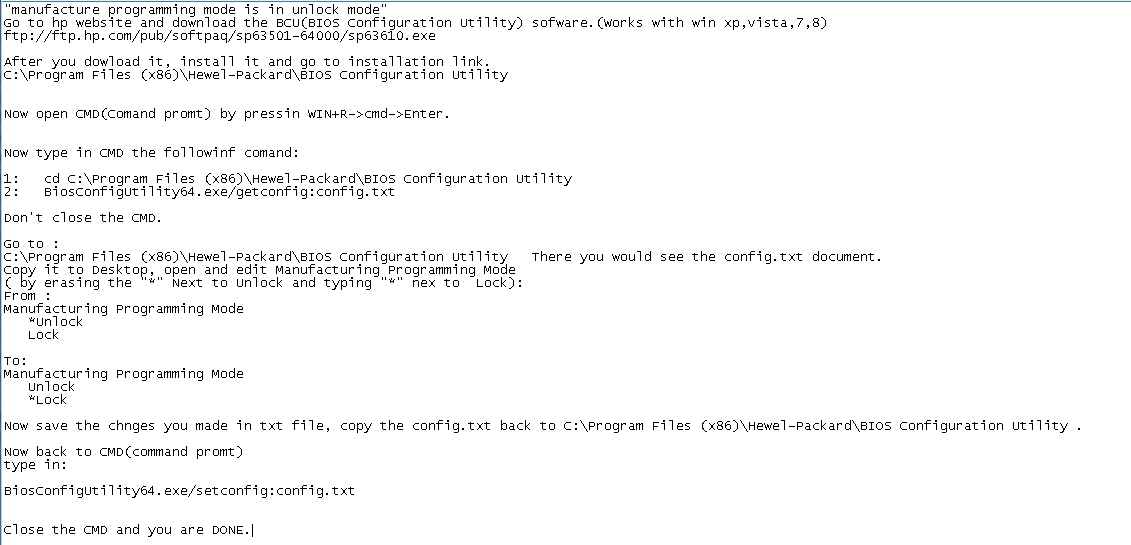

                        • 20643
                        #31
                        Re: HP ProBook 2560p missing info
                        There`s a jpeg picture in the folder called original.jpg ,i`ll attatch it here, it gives info how to lock/unlock mpm mode. I`m with you that its a pain to go through a load of crap just to get it working right.

                          #32
                          Ah, I've missed that. Gonna try later on, I've just came to the other building to work on some other old crap lol

                            #33
                            Interestingly enough, it was already in unlock state through this app:
                            *Lock
                            Unlock
                            But I still can not flash the BIOS Think I need the SMC blob thing…
                            I should also note that after some poing with the DMI tools, not the board is permanently in Manufacturing program mode set: 3 of 10. It does not change. Is it relevant?
