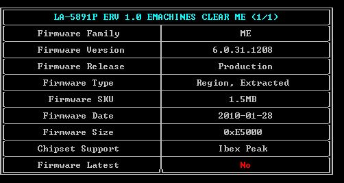

            I think this bios has the wrong ME firmware . It has ibex peak ver 6 , i think the chipset is HM55 ,a series 5 chipset . Correct me if i`m wrong .
              • 22276
              Re: Packard Bell TM85 NEW70 La-5891P shuts down every 5 mins
              Try this bios (with 6.0.31.1208 ME firmware -see my previous post i was wrong) and kbc fw.

                  So here is feedback.
                  Thank you all guys for your tips, it was really problem with me region, after aplying BIOS from SMDFlea problem disappeared.
                  I'm wondering why so many other BIOSes doesnt work.
