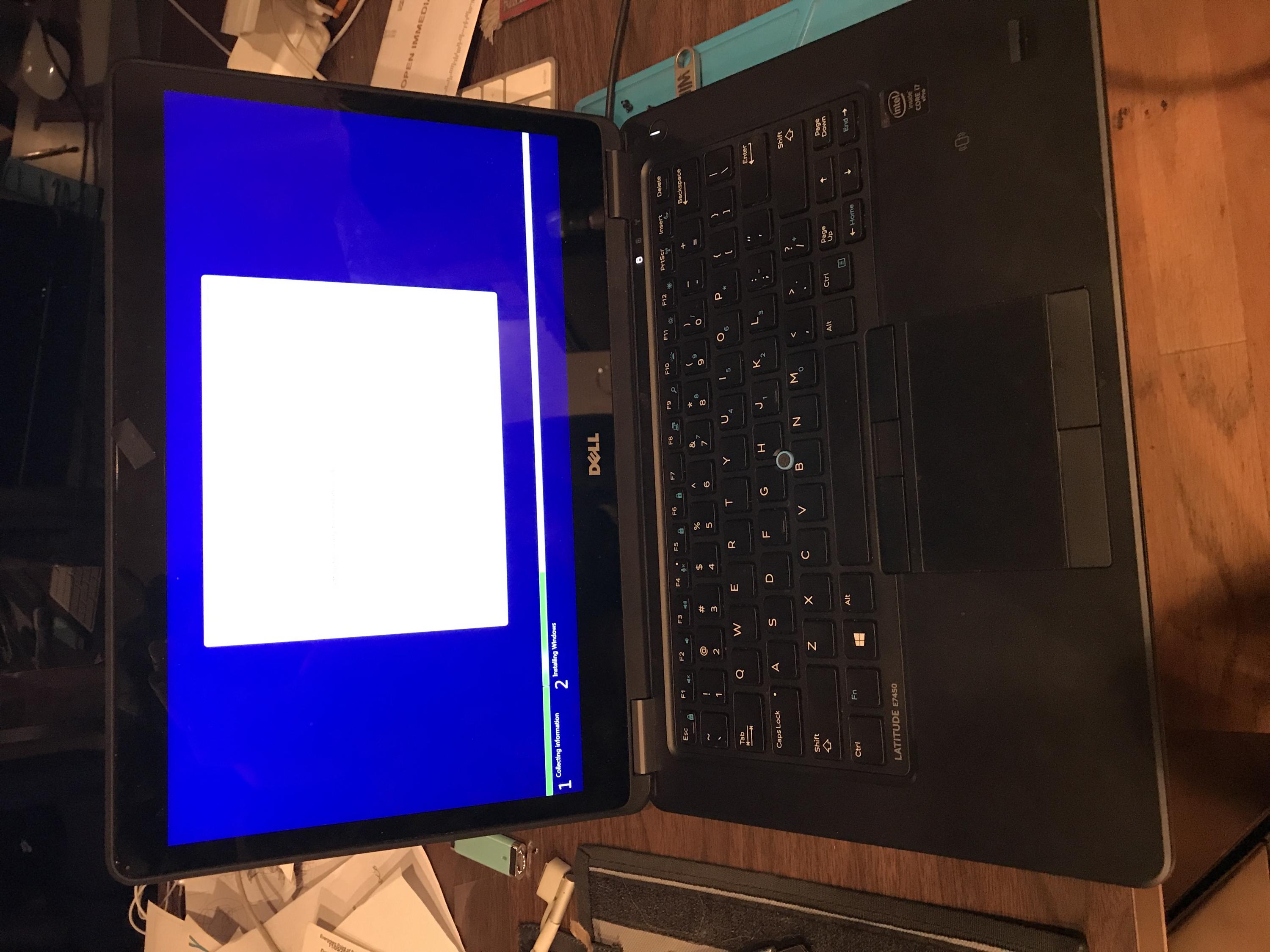

            Re: Dell E7450 ZBU11 LA-A963P BIOS DUMP NEEDED
            i have tried a million (maybe actually 5) different internet dumps, including several purchased from biosfix.
            the power button illuminates, the fans spin for a few sec, then they HDD light flashes for a split second as everything stops. repeat. on the third try (in a row) i'll get a good fast spin from the fan for a few seconds, then it's back to the normal routine.
            this laptop booted fine from the original bios (with unknown SVP), but i forgot to make a backup of the 4mb chip, so now i can't restore it to any bootable state, but i know for a fact it works fine.
            help?
            This isn't Monaco... This is Baghdad
              • 21022
              help?
              The password is stored in the MEC5085 . You can find out which dell models have the password stored in the MEC by searching for the Statement of Volatility document per model .
              Flash the MEC if you have a kbc programmer, and the bios .
                hello again SMDFlea. i hope that once again you might save me!
                i cannot restore this laptop to bootable state. i made backup of UC2, but neglected to backup UC3 or UV9 before trying various internet dumps. most BIOS downloads include only UC2 and UC3, which suggest those alone are good enough to restore corrupted BIOS, but I have tried at least seven different packages now with no success.
                      do you still have original backup your UC2?
                      post here i'll try to help to rebuild new one for you...
                        Here is the original, unmodified UC2 dump.
                          • 21022
                          Here`s UC2 and UC3 with clean ME, also UV9
                            Oh snap. I’ll buy you a beer if this works, I’ve spent probably $20 on internet dumps, hours translating Russian and Portuguese forums and registering to download dumps, etc. with no satisfaction.
                            I have to FULLY disassemble this unit to flash UV9, and then fully reassemble to test. I’m so sick of it!
                                  here you can try IF smdflea files doesnt work...
                                  Your orginal bios are ver. A019
                                  so base on your original file ... i try to rebuild UC3 from extracted e7450a019.exe and UC2 withclear NVRAM...
                                  UV9 use from smdflea...
                                  goodluck
                                    @SMDFlea, once again, you are my hero. haven't seen that laptop POST in almost a week.
                                    i decided to take apart the laptop, and use a dremel to expose the BIOS chips so i could do this without taking everything apart and putting it back together.
                                    after all that work, i flashed SMDFlea's BIOS, and it booted right up. oh well.
                                    I COULD KISS YOU ON THE MOUTH. but i won't.
                                    there's no sound tho, so it appears i'll have to tear it back down and figure out what gives. i am so over this laptop.
                                    i can't thank you all enough, and wish i had the skills to sort these UEFI bios out myself.
