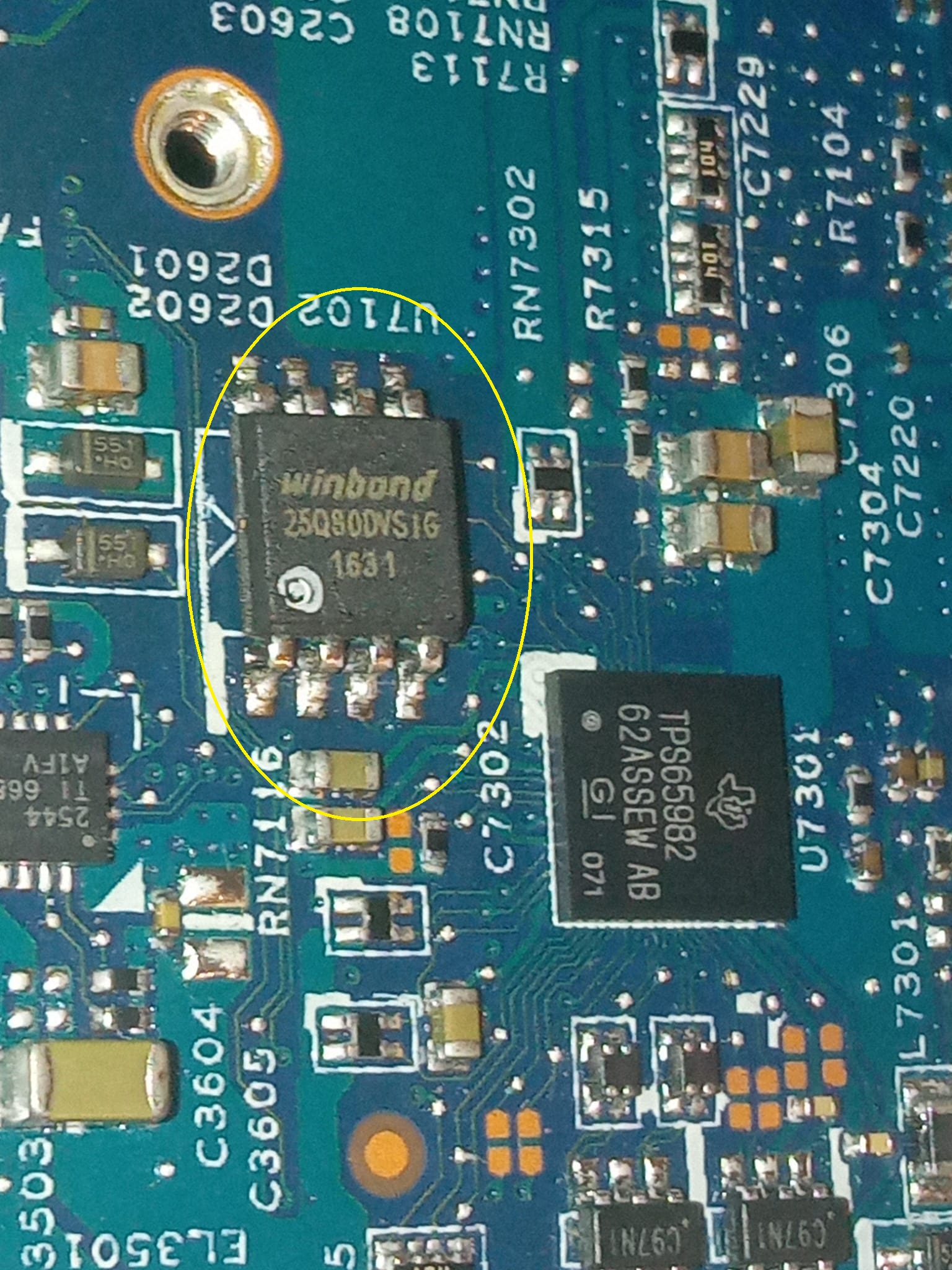

                  • haydar70
                    • Nov 2021
                    • 18
                    • france
                    Re: Acer Aspire VN7-592G (Rayleigh_SLS 15292-1) Bios Dump
                    sorry for my poor english
                    my computer never turns on
                    There seems to be no problem with the 8mb chip software
                    As if when I read winbord with a corrupt program, no data appears in it.
                    I wonder if you can give a verison that is correct
                    thanks
                    • hardware1
                      • Sep 2021
                      • 2946
                      • N/A
                      thanks
                      This Chip is 8Mbit (1MB), find another SOIC/WSON Chip.
                      If you have 8MB Chip upload its content and someone will try to help you.
                      Also write your device Serial Number.

                      • haydar70
                        • Nov 2021
                        • 18
                        • france
                        thank you this is my device number
                        rayleigh sls 32bit 15292-1 448.06b19.0011

                        actually my computer matches with this one but i suspect winbor which is 1mb it seems like there is a problem with it
                        I'm still installing the bios original software, which is 8mb
                        • hardware1
                          • Sep 2021
                          • 2946
                          • N/A
                          Here's your New Bios, it's a Virgin Bios from Acer with your DMI and Windows Key.
                          Serial Number: NHG7REF0066420CB086600.
                          all donations are welcome,
                          • haydar70
                            • Nov 2021
                            • 18
                            • france
                            Hello, thank you for the file.
                            but this is also
                            maybe the problem is not the bios, maybe there is another problem
