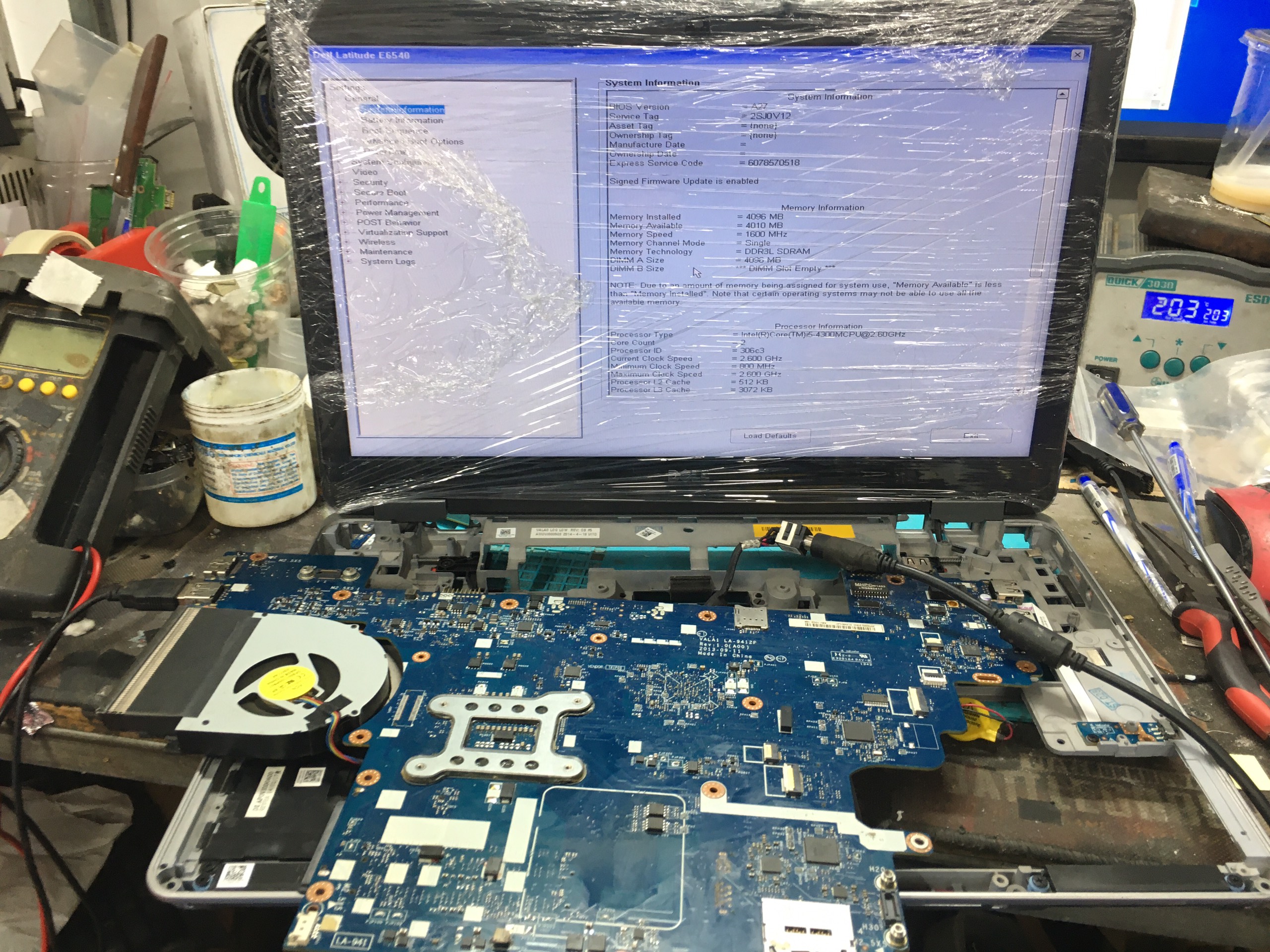

Dell Latitude E6540 bios needed
  • sourcebf
    • Jul 2016
    • 431
    • N/A
    Dell Latitude E6540 bios needed
    hi,
    Dell Latitude E6540
    Board: VALA1-LA-9412P
    Laptop power on without data on screen, please can somepne fix my dump
  • sourcebf
    • Jul 2016
    • 431
    • N/A
    Re: Dell Latitude E6540 bios nedded
    I find worked bios tested ok, my laptop works perfectly
    NB: start after 6 sec
    Last edited by sourcebf; 10-13-2017, 10:43 AM.
  • przemol
    • 2
    • Poland
    Re: Dell Latitude E6540 bios nedded
    I have downloaded and flashed my E6540 BIOS and EC, but I cannot update this version A09 to newest A21 from Windows operating system.
    Do you know why I cannot do it ?
    System restarts after used Flash file and after tha is not updated.
    Could You help in this case please ?
    • rioreno
      • Feb 2009
      • 540
      • Indonesia
      Re: Dell Latitude E6540 bios nedded
      Originally posted by przemol
      I have downloaded and flashed my E6540 BIOS and EC, but I cannot update this version A09 to newest A21 from Windows operating system.
      Do you know why I cannot do it ?
      System restarts after used Flash file and after tha is not updated.
      Could You help in this case please ?
      try with usb dos bootable with legacy boot...
      • przemol
        • 2
        • Poland
        Re: Dell Latitude E6540 bios nedded
        I tried this, and have no luck - still A09 version.
        DOS GUI system restarts after preparing for update.
        Did you tried to update BIOS on your notebook ?
        Greets
        Last edited by przemol; 01-31-2018, 04:57 AM.
        • hezareh2000
          • Jan 2019
          • 32
          • Iran
          Re: Dell Latitude E6540 bios nedded
          Hi, i want bios dell e6540 la-9414p rev 1.0 with ec file (4mg) please help me
          system slow boot
          • hezareh2000
            • Jan 2019
            • 32
            • Iran
            Re: Dell Latitude E6540 bios nedded
            Hi, i want bios dell e6540 la-9414p rev 1.0 with ec file (4mg) please help me
            system slow boot
            • menshawy
              • Aug 2013
              • 400
              • egypt
              Dell Latitude E6540 LA-9411P
              hi friends
              please i need clean me bios for Dell Latitude E6540
              mb LA-9411P
              Service Tag: DGQCZ12
              cpu i5 4th g
              i am tried all files in this forums with no display
              thanks
              • peste
                • Dec 2016
                • 12553
                • ROMANIA
                Re: Dell Latitude E6540 LA-9411P
                try...
                • hoanglonglaptop
                  • Mar 2020
                  • 4
                  • Russia
                  Re: Dell Latitude E6540 bios nedded
                  Originally posted by sourcebf
                  hi,
                  dell latitude e6540
                  board: vala1-la-9412p
                  laptop power on without data on screen, please can somepne fix my dump
                  bios extract new ok la-9412p dell latitude 6540
                  • hussaka
                    • Jan 2015
                    • 152
                    • italy
                    Re: Dell Latitude E6540 bios nedded
                    thank you so much
                    • eslam2223
                      • Nov 2018
                      • 3
                      • 5
                      Re: Dell Latitude E6540 bios nedded
                      La-9413p ec mec5075 please
                      • Daudi83
                        • Dec 2018
                        • 66
                        • Hungary
                        Re: Dell Latitude E6540 bios nedded
                        Hello everyone. I got a laptop LA-9412P REV:1.0 A00 power on no screen. The fan spinning when i switch it off, but the cpu isnt get warm. I tried the bios what posted upper but no luck. Here is my original bin files:
                        Thanks for any help.
                        Last edited by Daudi83; 02-08-2022, 05:32 AM.
                        • Daudi83
                          • Dec 2018
                          • 66
                          • Hungary
                          Re: Dell Latitude E6540 bios nedded
                          The original 2 bins:
                          • hoaca388
                            Badcaps
                            • Jan 2022
                            • 11564
                            • Viet Nam
                            Re: Dell Latitude E6540 bios nedded
                            Originally posted by daudi83
                            the original 2 bins:
                              • 20611
                              Re: Dell Latitude E6540 bios nedded
                              Originally posted by Daudi83
                              The original 2 bins:
                              Posts 2,9 and 10 are working,plus there`s more in another thread,if you use the forum search...
                              https://www.badcaps.net/forum/showthread.php?t=71299
                              https://www.badcaps.net/forum/showpo...7&postcount=16
                              • laptopbn
                                • Jul 2016
                                • 71
                                • Viet Nam
                                Re: Dell Latitude E6540 bios nedded
                                Originally posted by hoanglonglaptop
                                bios extract new ok la-9412p dell latitude 6540
                                • kamalkharbanda
                                  • Jun 2013
                                  • 91
                                  • India
                                  Re: Dell Latitude E6540 bios nedded
                                  ITS WORKING
                                  Originally posted by hoanglonglaptop
                                  bios extract new ok la-9412p dell latitude 6540
                                  • konradx
                                    • May 2020
                                    • 40
                                    • Polska
                                    Re: Dell Latitude E6540 bios nedded
                                    I have problem with LA-9413P Rev 1.0 A00, my old CPU i7-4800 was broken, I replaced it with I5 4300M. Laptop works fine but shuts down after 30 minutes. I've tried Clear ME by FIT but they don't half turn on.
                                    • hardware1
                                      • Sep 2021
                                      • 2925
                                      • N/A
                                      Re: Dell Latitude E6540 bios nedded
                                      Originally posted by konradx
                                      I have problem with LA-9413P Rev 1.0 A00, my old CPU i7-4800 was broken, I replaced it with I5 4300M. Laptop works fine but shuts down after 30 minutes. I've tried Clear ME by FIT but they don't half turn on.
                                      Here's you Clean Bios, try it.
                                      all donations are welcome,
                                        DELL Latitude E6540 Notebook 6000 Specification for Upgrade or Repair
                                        This specification for the DELL Latitude E6540 Notebook can be useful for upgrading or repairing a laptop that is not working. As a community we are working through our specifications to add valuable data like the E6540 boardview and E6540 schematic. Our users have donated over 1 million documents which are being added to the site. This page will be updated soon with additional information. Alternatively you can request additional help from our users directly on the relevant badcaps forum. Please note that we offer no warranties that any specification, datasheet, or download for DELL Latitude...
                                        09-06-2024, 04:40 PM
                                        DELL Latitude E6540 Notebook 6000 Specification for Upgrade or Repair
                                        This specification for the DELL Latitude E6540 Notebook can be useful for upgrading or repairing a laptop that is not working. As a community we are working through our specifications to add valuable data like the E6540 boardview and E6540 schematic. Our users have donated over 1 million documents which are being added to the site. This page will be updated soon with additional information. Alternatively you can request additional help from our users directly on the relevant badcaps forum. Please note that we offer no warranties that any specification, datasheet, or download for DELL Latitude...
                                        09-06-2024, 04:40 PM
                                        DELL Latitude E6540 Notebook 6000 Specification for Upgrade or Repair
                                        This specification for the DELL Latitude E6540 Notebook can be useful for upgrading or repairing a laptop that is not working. As a community we are working through our specifications to add valuable data like the E6540 boardview and E6540 schematic. Our users have donated over 1 million documents which are being added to the site. This page will be updated soon with additional information. Alternatively you can request additional help from our users directly on the relevant badcaps forum. Please note that we offer no warranties that any specification, datasheet, or download for DELL Latitude...
                                        09-06-2024, 04:40 PM
                                        DELL Latitude E6540 Notebook 6000 Specification for Upgrade or Repair
                                        This specification for the DELL Latitude E6540 Notebook can be useful for upgrading or repairing a laptop that is not working. As a community we are working through our specifications to add valuable data like the E6540 boardview and E6540 schematic. Our users have donated over 1 million documents which are being added to the site. This page will be updated soon with additional information. Alternatively you can request additional help from our users directly on the relevant badcaps forum. Please note that we offer no warranties that any specification, datasheet, or download for DELL Latitude...
                                        09-06-2024, 04:10 PM
                                        DELL Latitude E6540 Notebook 6000 Specification for Upgrade or Repair
                                        This specification for the DELL Latitude E6540 Notebook can be useful for upgrading or repairing a laptop that is not working. As a community we are working through our specifications to add valuable data like the E6540 boardview and E6540 schematic. Our users have donated over 1 million documents which are being added to the site. This page will be updated soon with additional information. Alternatively you can request additional help from our users directly on the relevant badcaps forum. Please note that we offer no warranties that any specification, datasheet, or download for DELL Latitude...
                                        09-06-2024, 04:00 PM
